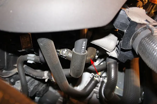

*** NOTE: 08/14/2020 - The PCV hose identified in this guide is the same hose that CorkSport identifies as the PCV hose in their installation instructions (see here), but they use a different method of installation that involves capping the intake manifold port and tapping the valve cover hose near the turbo intake pipe. Since CorkSport's installation involves the removal of two "permanent" clamps from the valve cover hose, I chose to install it in a different way. Removal of those "permanent" clamps on the valve cover hose could result in some headaches (or a flat out denial of warranty) if I ever had any engine issues that would normally have been covered under warranty.

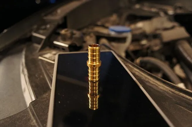

- One 1/2" brass PEX barb coupling (male/male)

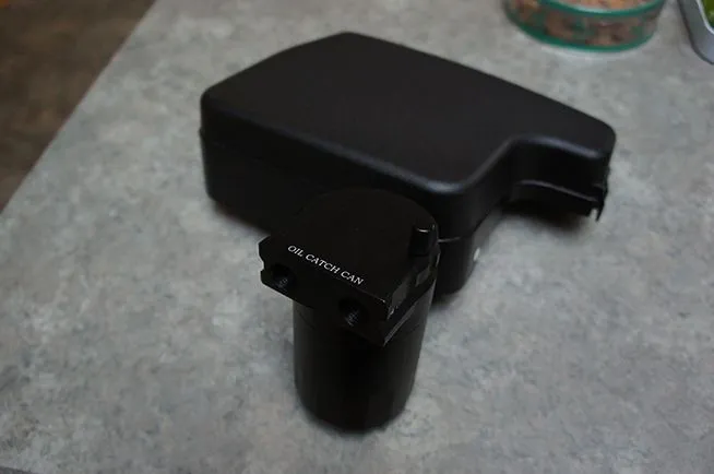

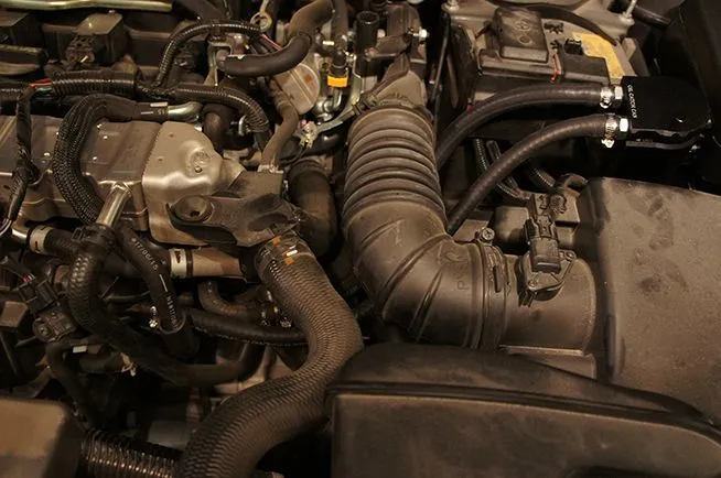

3. I chose to mount my can on the fuse cover, so I used a rotary tool to drill a couple of mounting holes. Here's a photo of the can mounted on the cover:
attachment.php
4. Cut your tubing to your desired lengths (remember, measure twice, cut once). Install the tubing, then screw the fittings on to the can. As a note, the crankcase tubing was just a little too small for the fittings on this can, so I really had to muscle it on. 1/2" tubing probably would have been a bit easier to use.

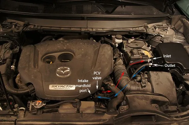

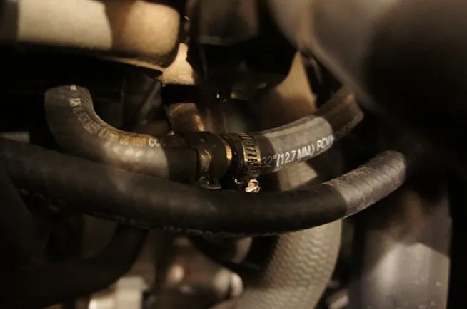

5. With the OCC mounted, we can now plumb the lines. Refer to the photo below to see where the OEM PCV hose is located (on the right side of the intake manifold, underneath the engine cover). The next photo shows how the flow will run after the installation.
attachment.php
attachment.php

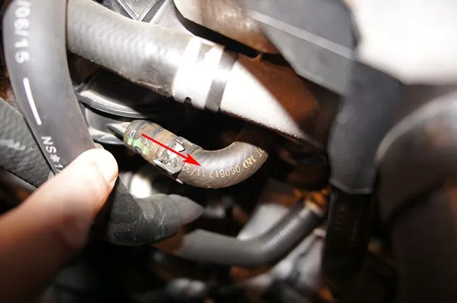

6. Remove the engine cover to get a better look at everything (just pull straight up, the cover will come right off). Using your pliers, squeeze the clamp to loosen it and move it towards the bend of the hose.
attachment.php

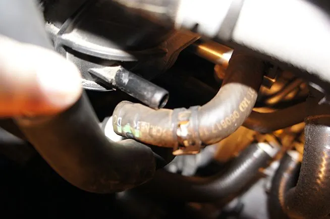

7. Use a screwdriver with a rag over the tip to slide the hose off of the intake manifold port. It might be stuck on there pretty good, just take your time with it and it'll come off.
attachment.php
attachment.php
8. Rotate the PCV hose so that it's facing the OCC. You might have to use your pliers to loosen the other squeeze clamp on the PCV side before you can turn the hose, but I was able to just twist the hose in the right direction. Install the 1/2" coupler and slide the squeeze clamp over the coupler to hold it in place.

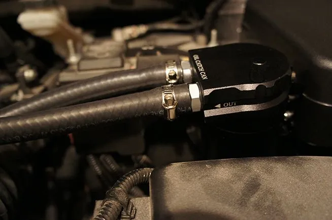

9. Slide a worm-gear clamp on to the other end of the hose from the "IN" side of the OCC, then install the hose on to the coupler. Slide the clamp on to the coupler and tighten it down.
attachment.php
10. Slide a worm-gear clamp on to the other end of the hose from the "OUT" side of the OCC, then install the hose on to the intake manifold port. Slide the clamp over the port and tighten it down. The engine bay should now look like this:
attachment.php
11. Start the car and make sure everything looks and sounds good. I took my car around the block a couple of times and also opened it up a bit on an empty road to test for any leaks. If everything looks and sounds good, put the engine cover back on, because that's it!
Since this install was done last night, I've only driven it around the block to test and then to work this morning (~25 KMs). So far, no issues. At the time of install, I had 11,750 KMs on the odometer. I plan to check in every 1,000 KMs to establish a baseline for how often I need to empty the OCC. All in all, I'm very happy with the way the install went and what the end result looks like. It almost looks like an OEM part :)
