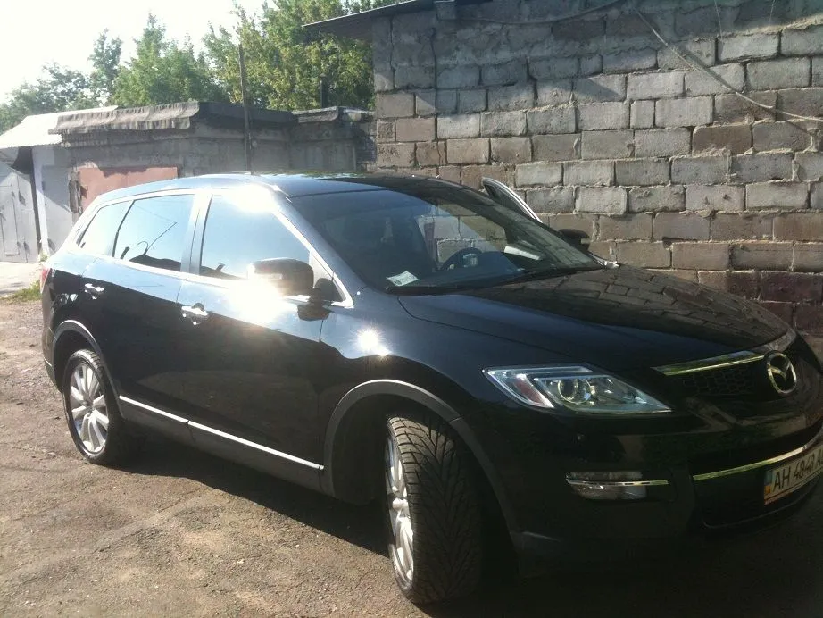

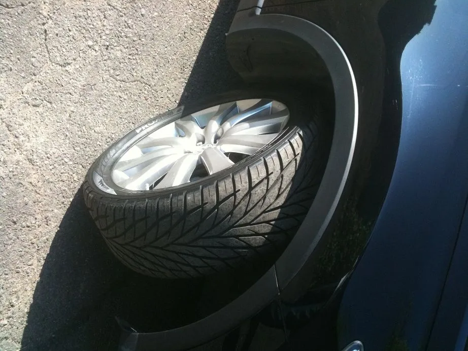

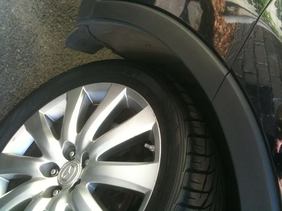

No issues with Toyo Proxes S/T 275/40 R20 on factory wheels: 1.webp2.webp3.webp
