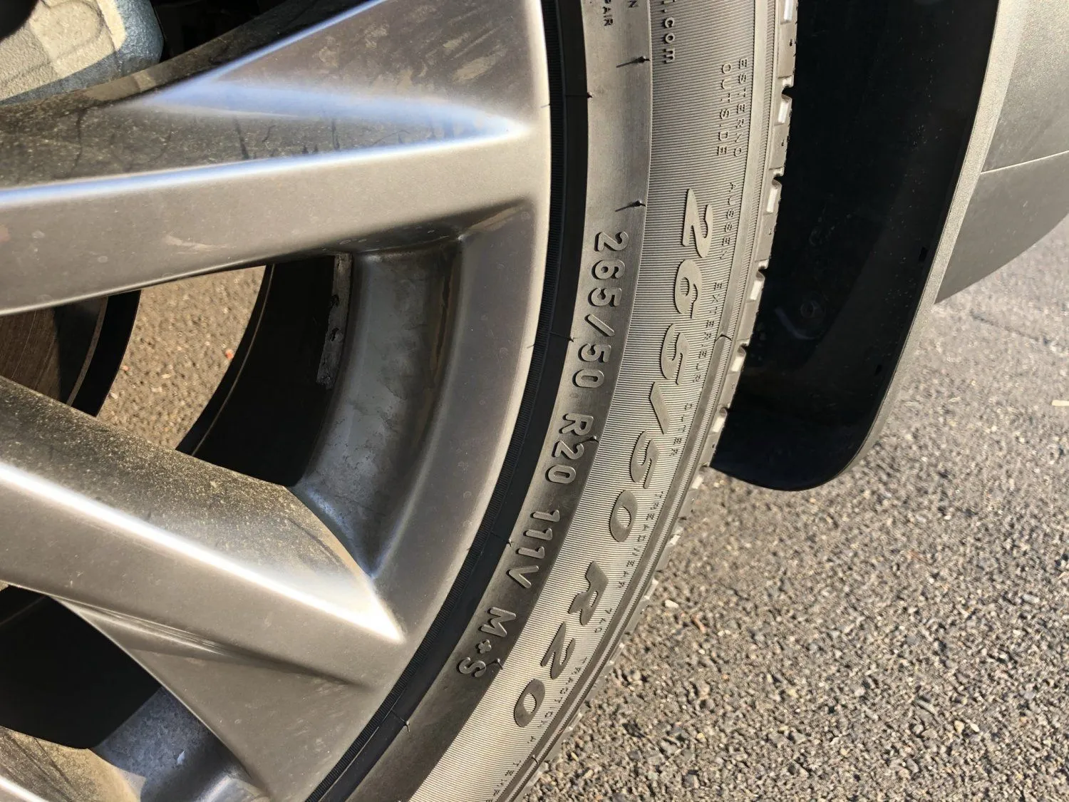

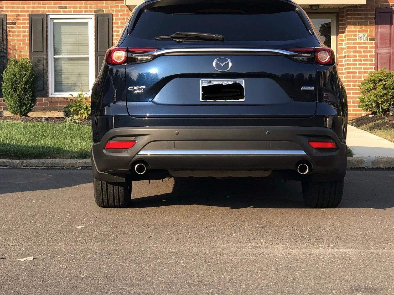

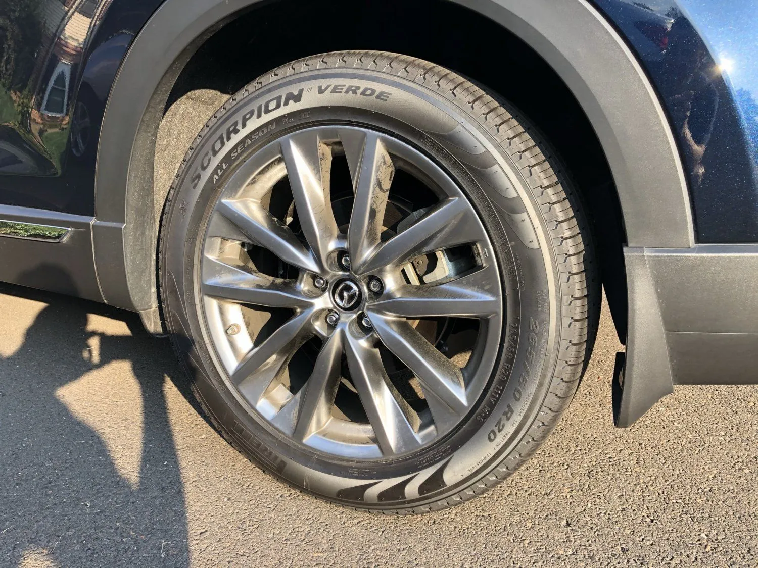

So BrettLevy85, no ill affects of the larger 265 size? No fitment issues, acceleration and fuel economy minimally affected? Can you post a pic or two, to see overall stance, and then up close to see width on the OE wheel?
Thanks
Thanks
Will do. No issues whatsoever with the size. Fuel economy haven’t noticed anything change. Acceleration nothing I can notice. I’ll take pictures tomorrow evening as my wife will have the car tomorrow and I’ll be driving my work car.
Appreciate any pics here as well. We'll be working on the CX-9 next after we finished installing the brake kit and fuel off-road rims plus bumper on the Silverado project. The owner wants to have 265 50R20 tires as well.
Here are some on my CX9. Don’t mind the messy wheels. Car needs a good detail.
Just did a week long vacation and drove over 1300 miles. These tires are very quiet and handle well. They are very stable and when driving windy roads by Shenandoah National Park it was fun. Didn’t expect it to handle this well. Very stable at speed as well. Not twitchy like some tires can be with a more aggressive turn in. Highly recommend.
