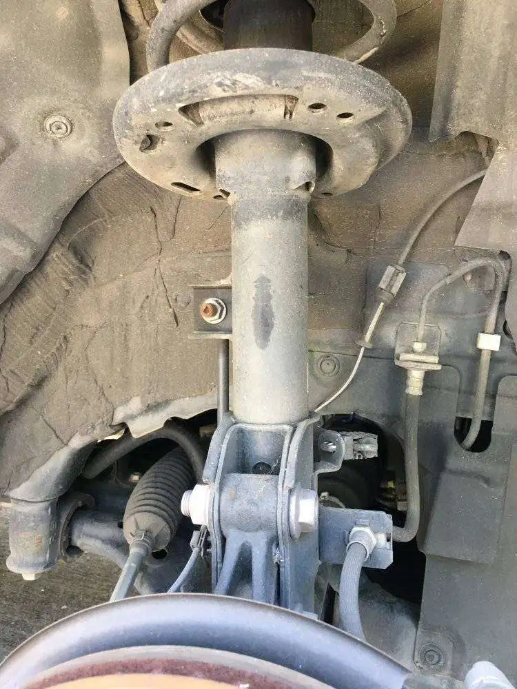

Just wondering why you don’t consider 225/55R19 tires specified by the Mazda? I don’t believe you can tell the difference on driving performance between 225 and 235 / 245. My concern will be the wider tires could rub the front struts even easier as the stock 225 had rubbed them on my CX-5.

Very interesting regarding the rubbing on you strut from the stock 225's. What year and model is your CX-5? My main concern right now is a tire with better wet weather traction vs the stock Toyo A36. I felt like I was driving on ice on the freeway Friday in the pouring rain heading to San Francisco and I was driving slowly in the slow lane. The reason I was thinking 235 or 245 is I much prefer the look of the wider tires but again safety in the rain is my primary concern. The skinny tires are probably the only aesthetic feature I dislike about the CX-5.
Any tires mentioned in my post will have better wet traction than the half-worn stock A36’s. I really don’t think 10mm or 20mm wider tread will make much differences on better wet traction or preventing hydroplaning. Like you actually want narrower snow tires to have better traction on wintery road conditions. You can check the wet performance for each tire at the Tire Rack website.
