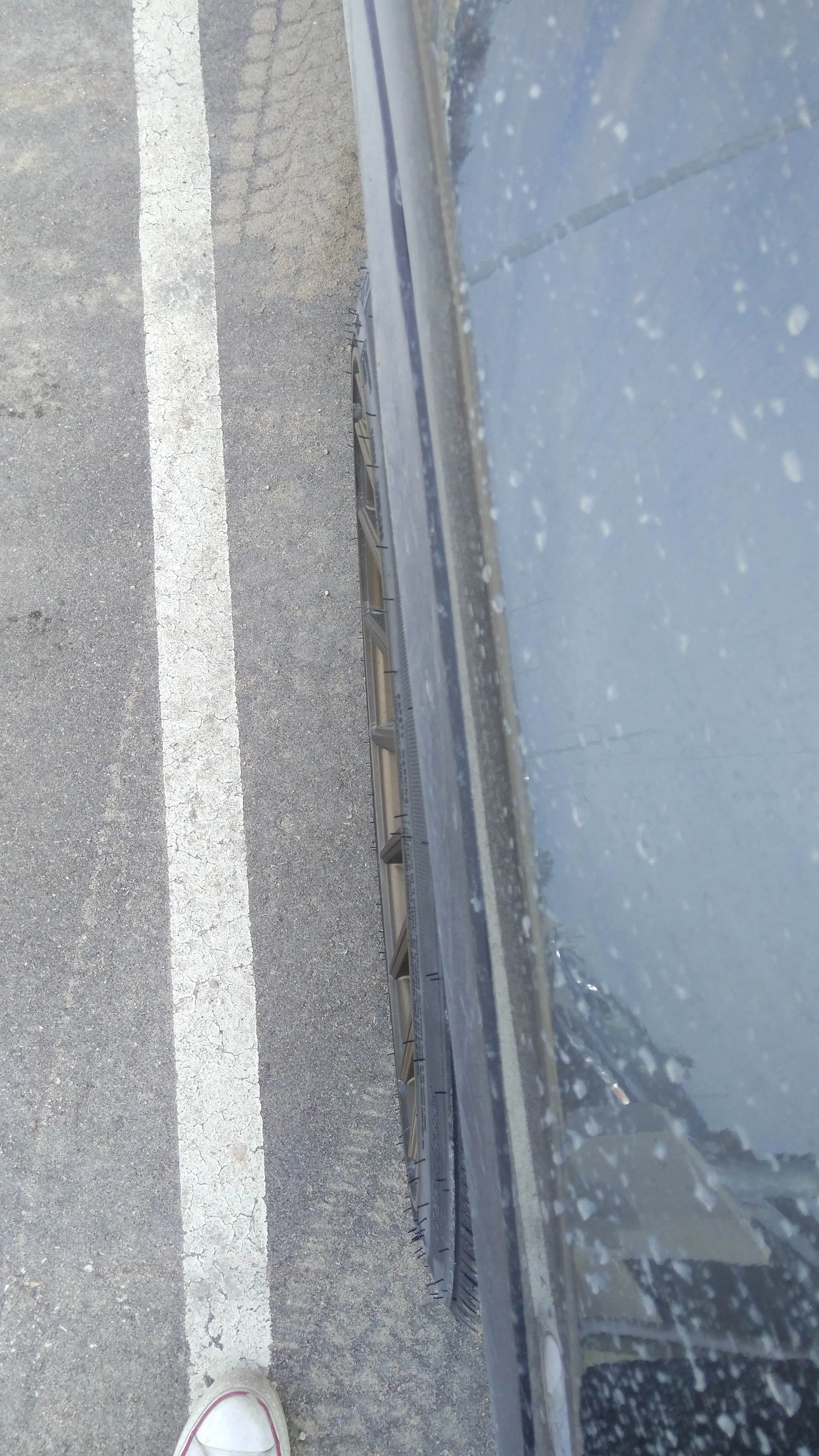

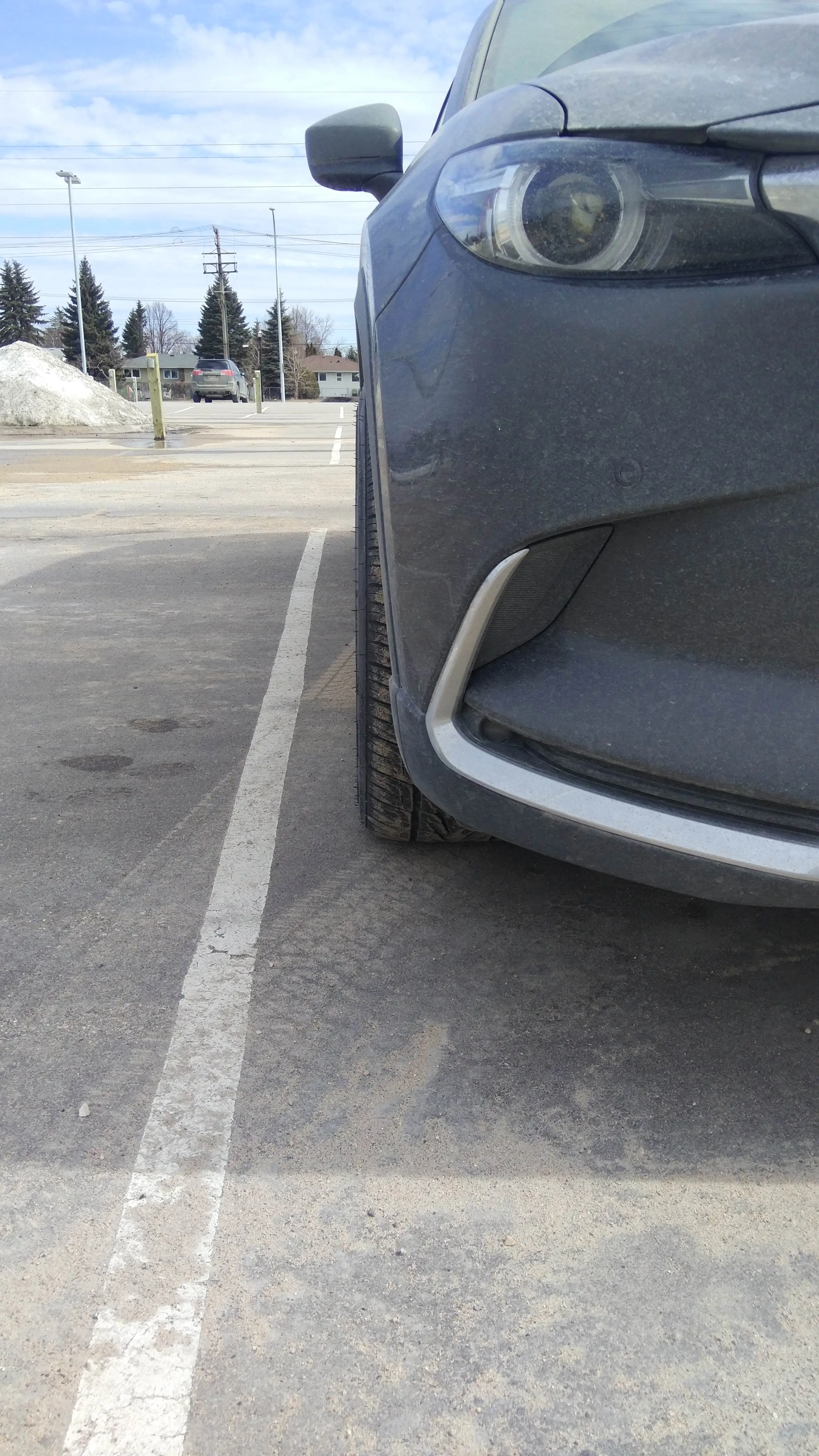

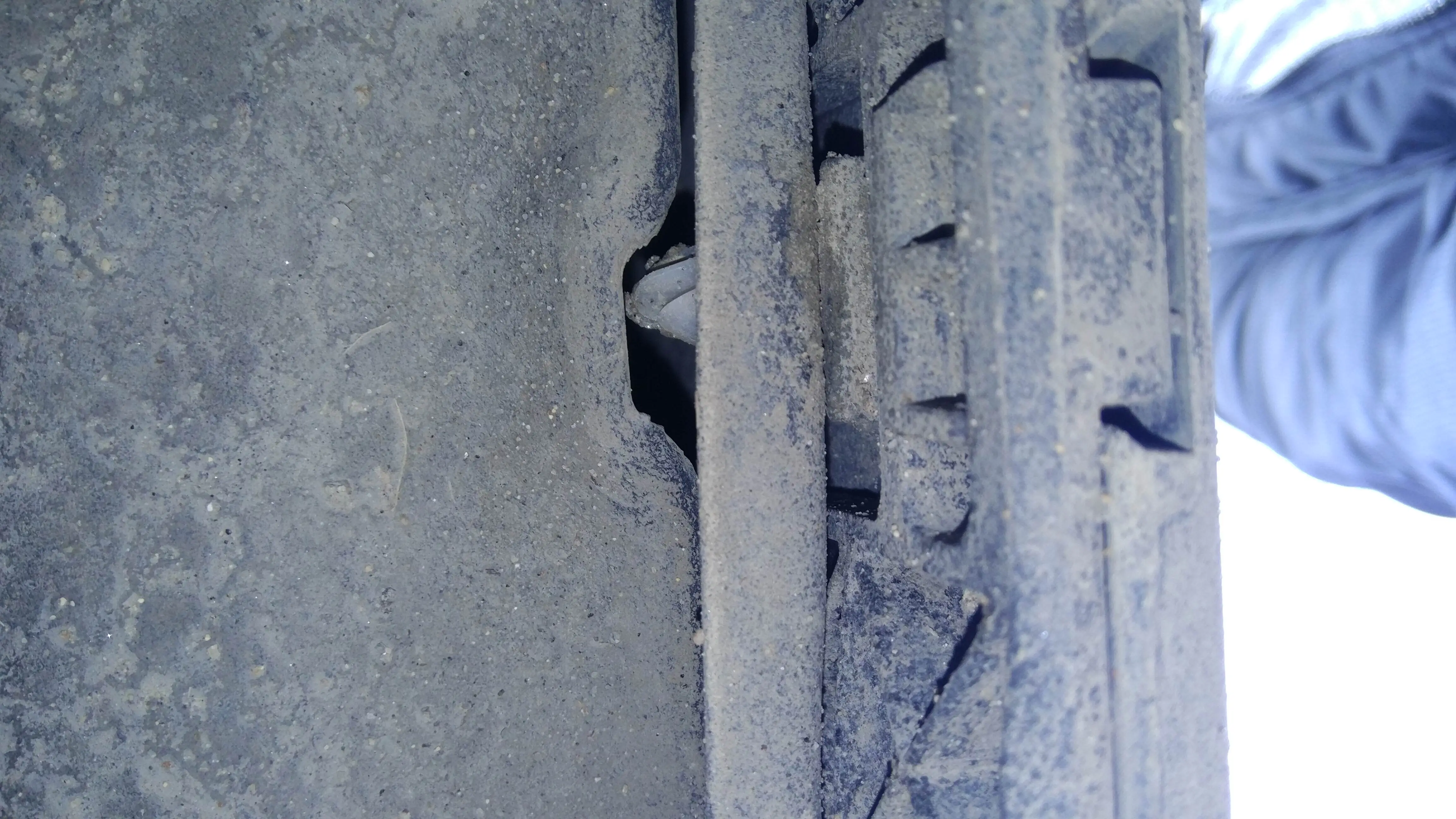

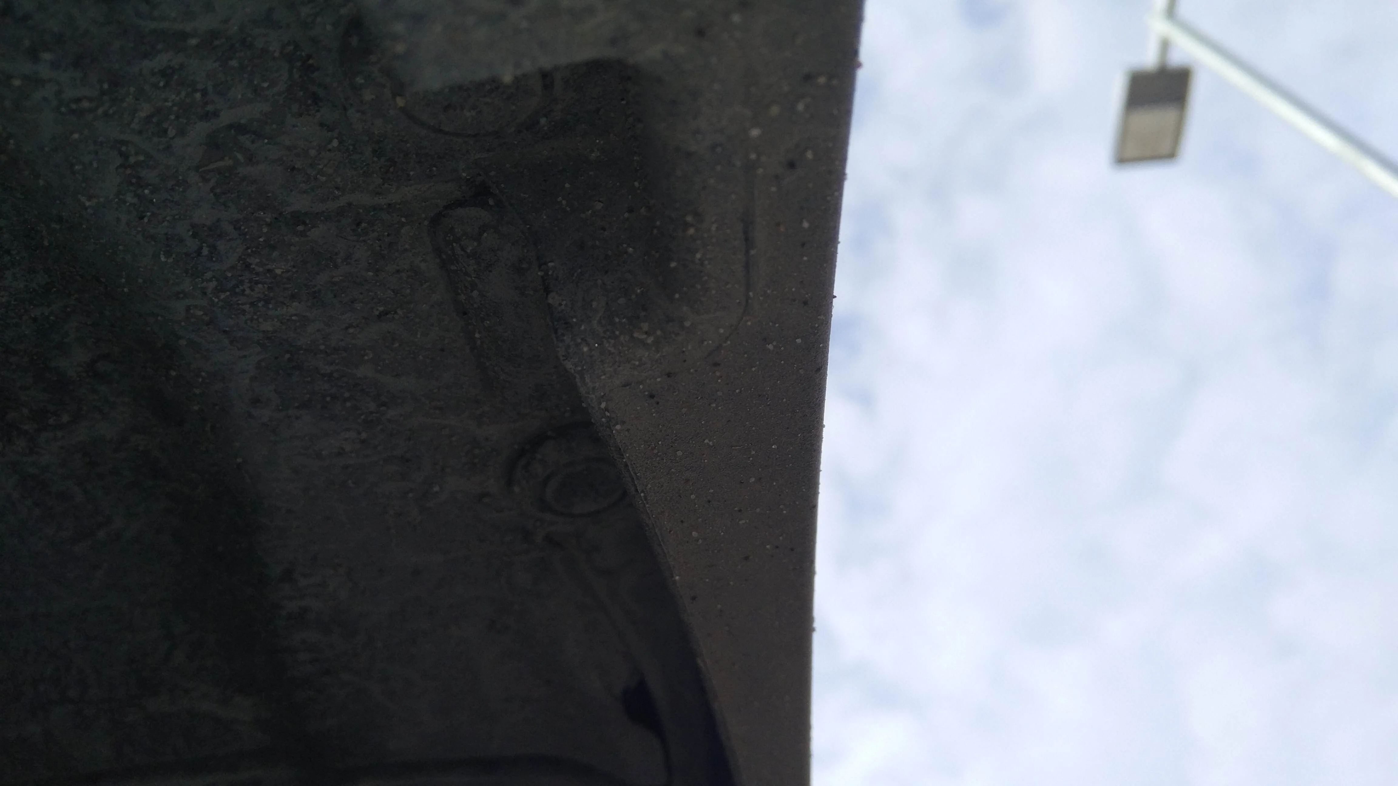

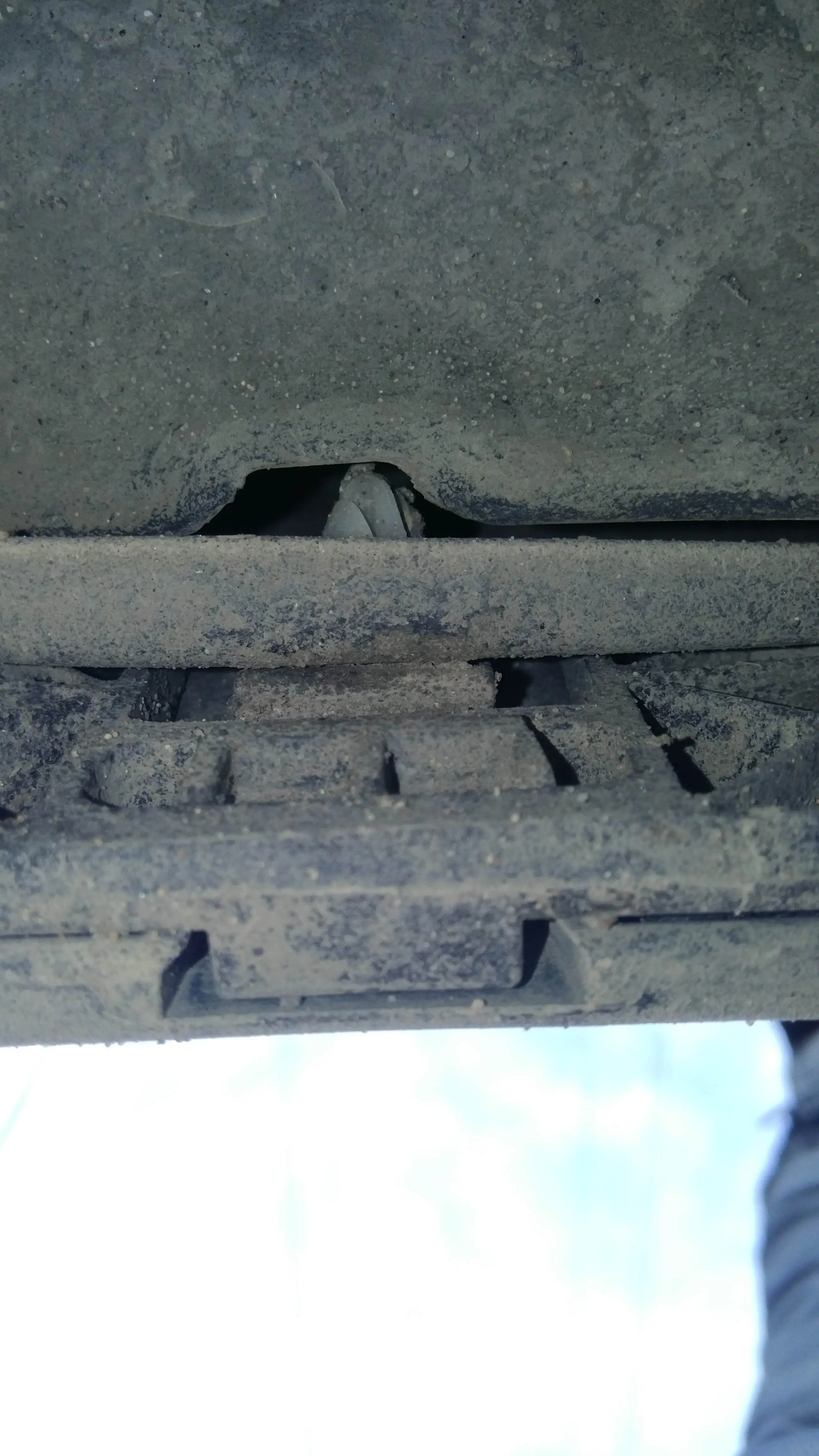

Here are some pics I took before the snow fell. These are all pictures of the front right wheel/fender.
Thanks for sending the pics dude! It looks as though the .25” on each side is doable. To your point earlier, as long as it’s a lower offset and it’s not lowered too much then the 11 is doable.
