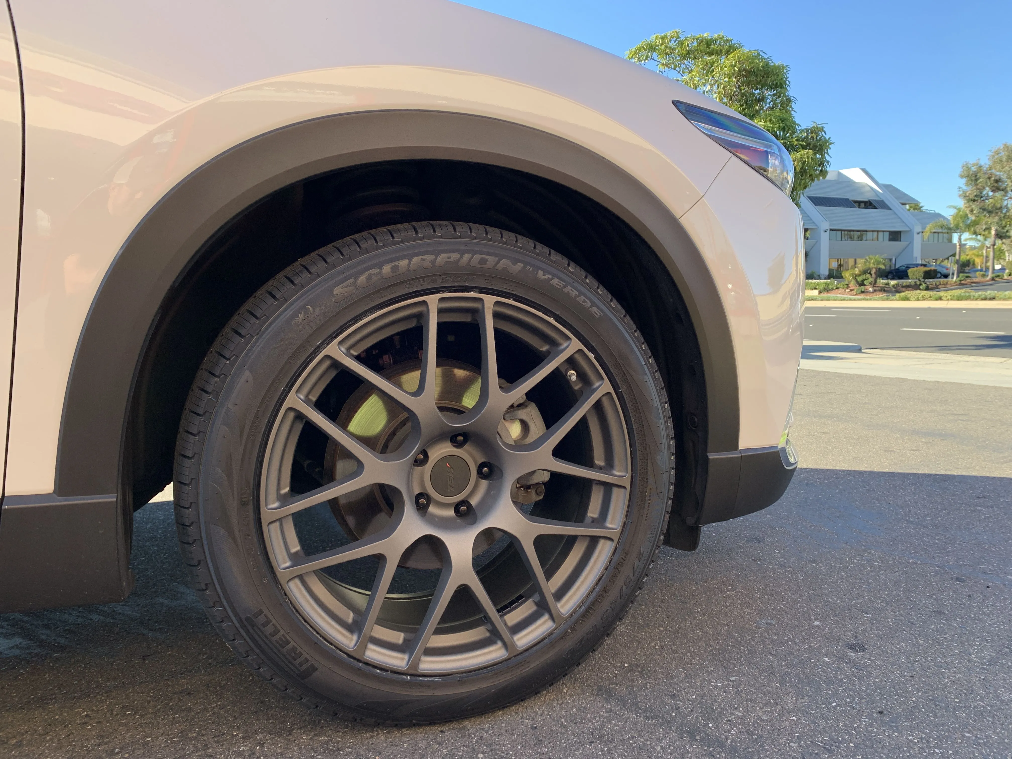

I have 20x10 w/ +40 offset, and I don't have any issues. I just got some new SCORPION VERDE™ ALL SEASON PLUS II tires mounted: 275/45R20 110V XL .
I purchased a new to us 2019 Touring with 20 inch wheels and Scorpion Verde tires (the tires are brand new). While we have put more miles on the loaner vehicles that Mazda has given us (more on this later when it gets fixed) than we have on our CX9, I can tell you that I am not impressed with the Pirelli Scorpion Verde tires. My main complaint with them comes from the amount of noise that they generate. On anything other than brand new glass like asphalt the roar they produce is unacceptable. One of the many loaners that we have driven was a 2019 CX9 with 20 inch Ecopia tires and the noise they produced was at least 50% less. If we decide to keep the CX9 after Mazda gets it repaired the 1st thing that will be replaced is the tires.

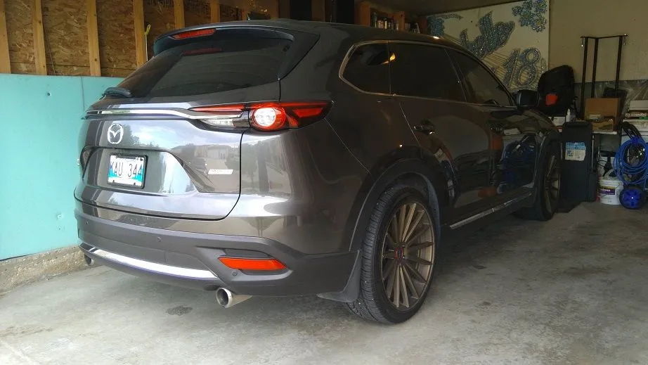

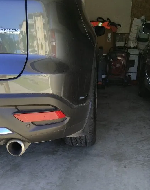

I think it would work just fine. The only real "problem" I have now is that the car gets dirty a little faster because the mudflaps aren't wide enough for the wheels/tires. I actually put a pair of 5mm wheel spacers on the rears, so the rear fitment is actually more like 22x10.5 +25. Here are a couple of old pics:
I'm on stock suspension, so no rubbing on anything. With +30 fronts, I have no rubbing or clearance issues. I'm able to make full-lock u-turns no problem. I don't know if 5mm will make any difference up front, but I don't think it will. I think worst case scenario, you might slightly rub the plastic fender guard if you take a sharp turn and hit a pothole in the middle of the turn (pretty rare situation IMO). Same thing would probably happen with +30 up front. I would go for it.
Did the 5mm spacer work ok with the stock wheel studs? Still lots of thread left for the lug nuts?
Yep, working great with the stock wheel studs. Enough thread left for both the aftermarket wheels/lugs and the OEM wheels/lugs (I leave the spacers on when I swap over to my winter wheels). That said, I wouldn't go with anything thicker than 5mm without getting extended studs or a spacer with built in studs.

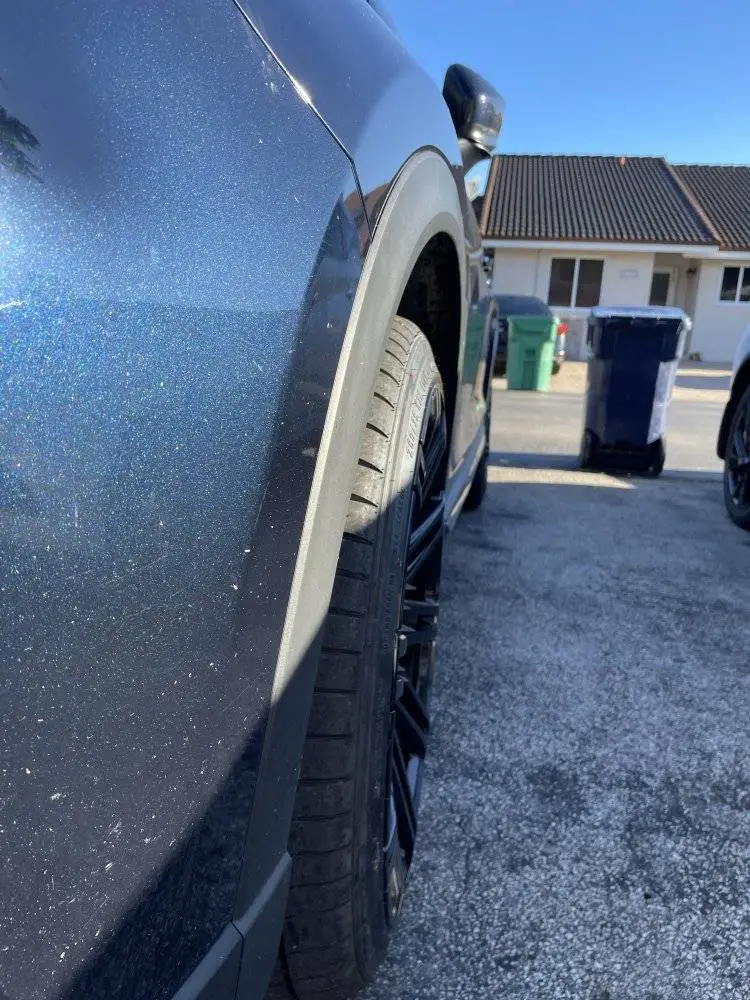

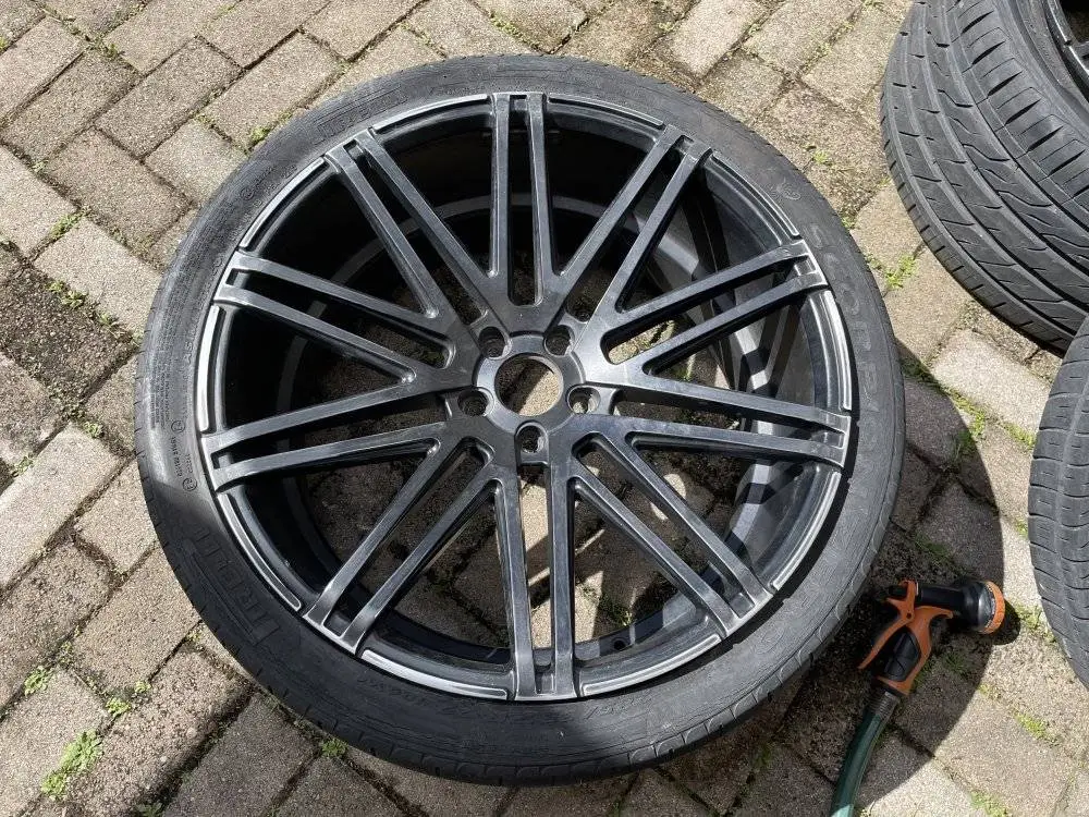

I just picked up a set of 22x10.5 38 offset wheels. They have some rotted 285/35/22 tires on them. I mounted passenger front on and looks to have plenty or room including lock to lock turning. I am working on cleaning them up, painting them and getting new tires. Just picked up some new center cap Mazda stickers to replace the ones on them. Can’t wait for them to be completed and in the car. My cx9 is blue. Show me some pictures of what color wheels you have on. Trying to decide on what color to paint them!
Those look like Curva C48 wheels. Here are the colours they originally came in, just for reference:
I think a "safe" colour choice is silver or gunmetal grey. I'm not a fan matte or gloss black on wheels. Personally, I really like gold wheels on that shade of blue, but it is a "loud" colour combination and it may not be your style. Some examples:

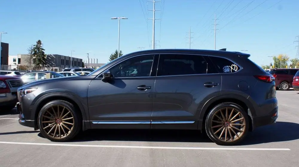

My CX-9 is machine grey, but here are a couple of pics of my satin bronze wheels in different lighting.

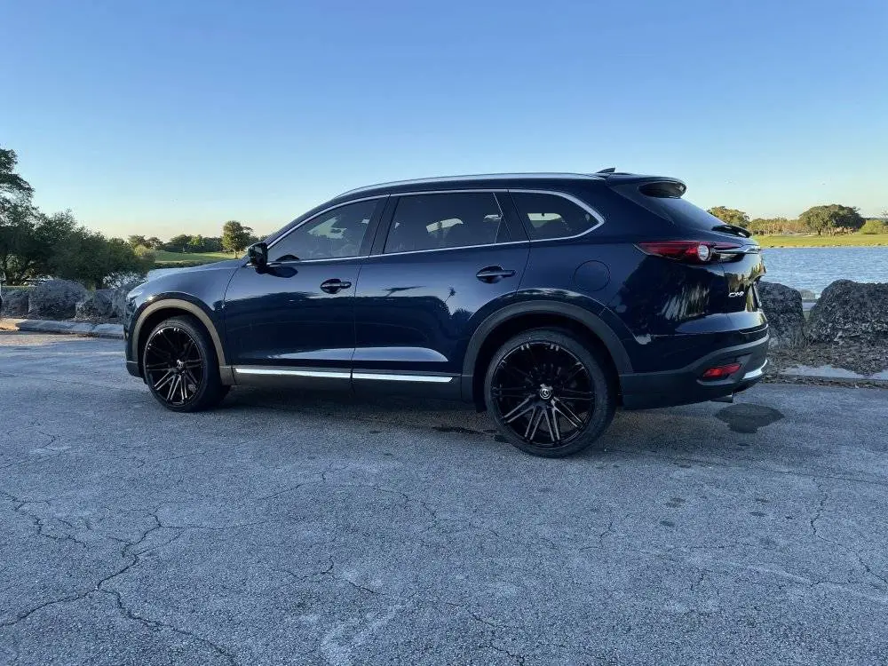

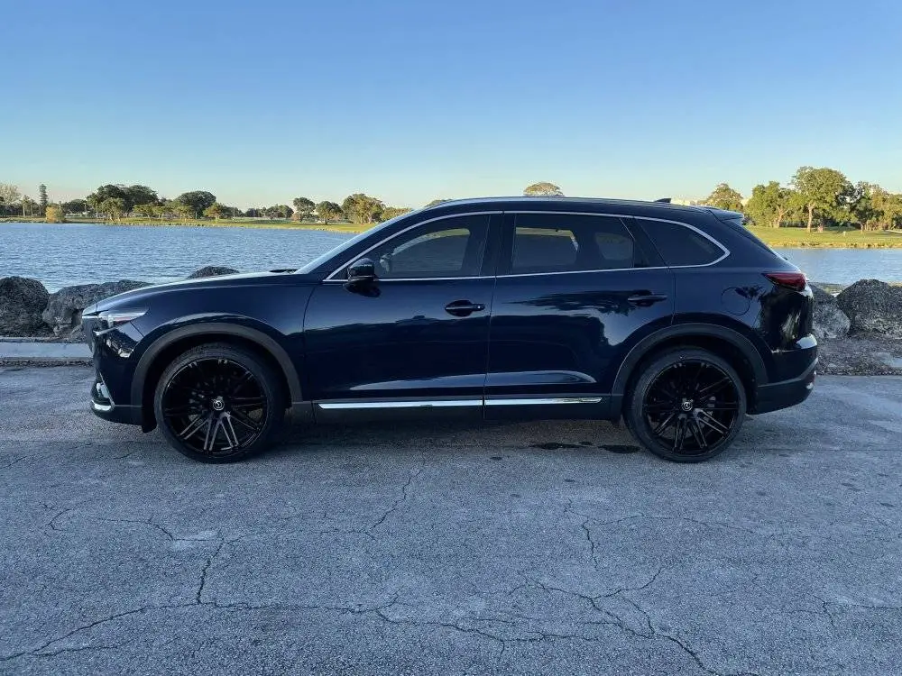

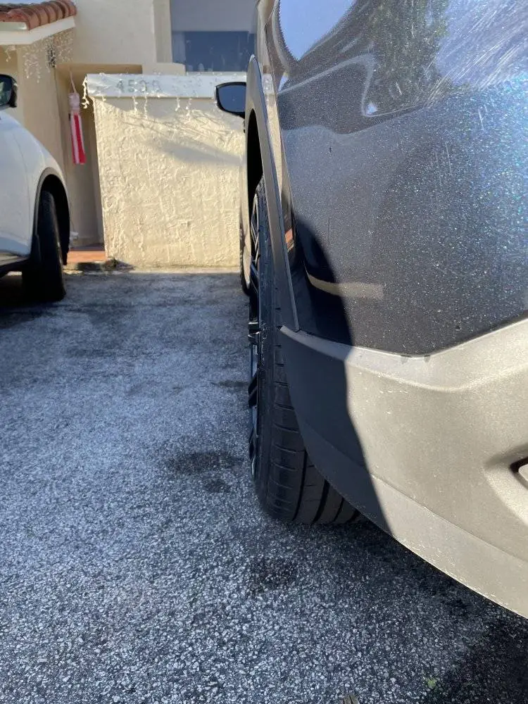

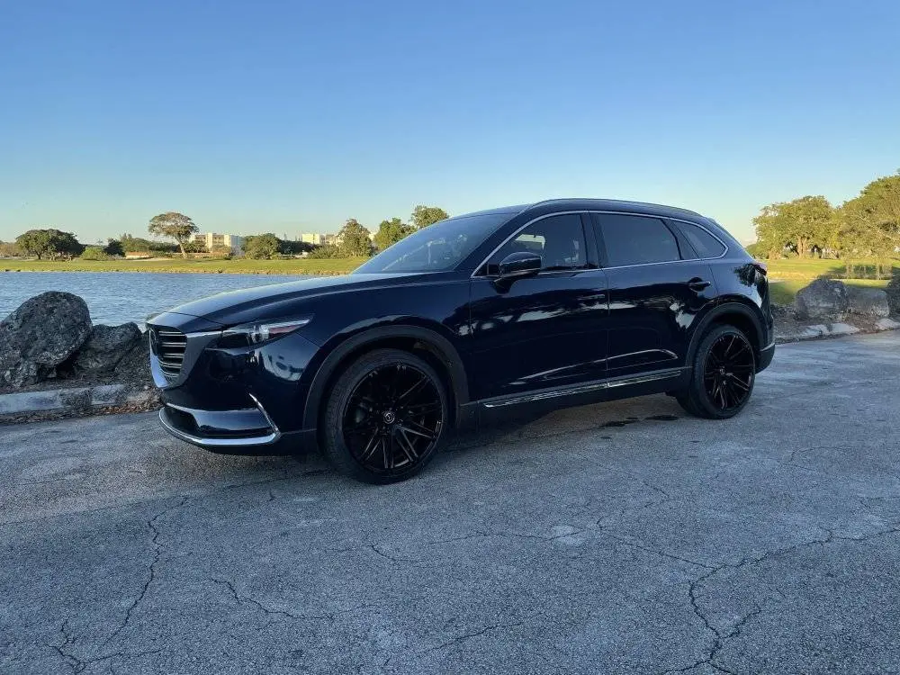

So finally got the wheels finished and mounted. Found a hell of a deal on a set of 285/35/22 Accelera tires that I couldn’t pass up. The car is still dirty haven’t had a chance to wash it but it is what is is for now.
Specs: 22x10.5 Curva Concepts C48 wrapped with 285/35 tires. According to the specs the wheels have a 38 offset but in measuring I found them to be closer if not right at 40.
No rubbing or any kind of interference anywhere. No spacers used. Wheels are pretty flush with the fenders. Don’t have a picture right now of that but can get one in the morning if anyone is interested.
40 series tires would probably make the gaps in the fenders a little less noticeable, but I just couldn’t pass up the deal I got on the 35.
Ride feels good. Not rough. I would say the difference from stock size 50 series tires is negligible.
Very happy with the wheels, tires and ride… now just need to lower it a bit and a few other cosmetic changes (front lip, rear diffuser, chrome delete) and I should be done… for now.
Looks good! But are you sure they're +40? Maybe it's just the angle, but they look like they poke out more than my +30 set..
Thanks.
The wheels were/are stamped 38. I measured them and I got 40. I seriously doubt they are anything less than 38 but they do “poke” enough to make them look flush with fenders.
They do sit quite close to the shock in the front. Similar to the picture someone posted earlier.
And the 285 tire looks a bit stretched. Do your tires stretch like these? Maybe wheels are wider than 10.5 they are stamped?
