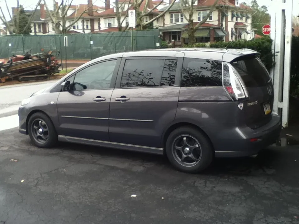

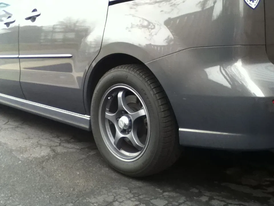

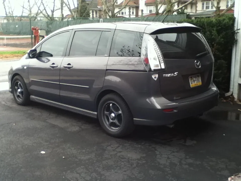

Could you post some pics of the tires on the rims? I'd love to see what they look like. I wish I had gone bigger than stock when I replaced our stock Toyos.
These are 215/55-16's on a 7 inch rim ( my winter tires)... awesome by the way!
