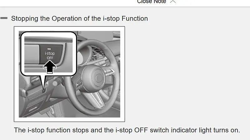

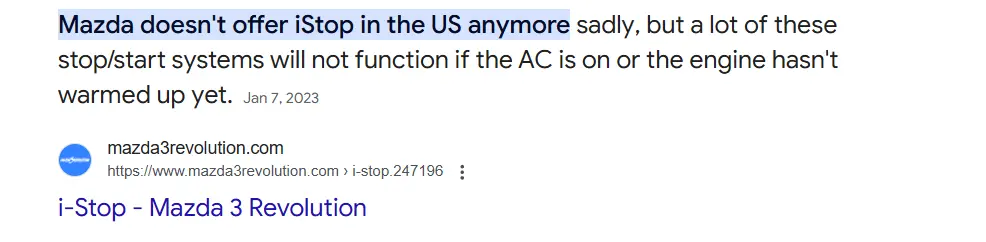

Are you SURE it doesn't have i-stop? This is from the CX-30 online manual:
