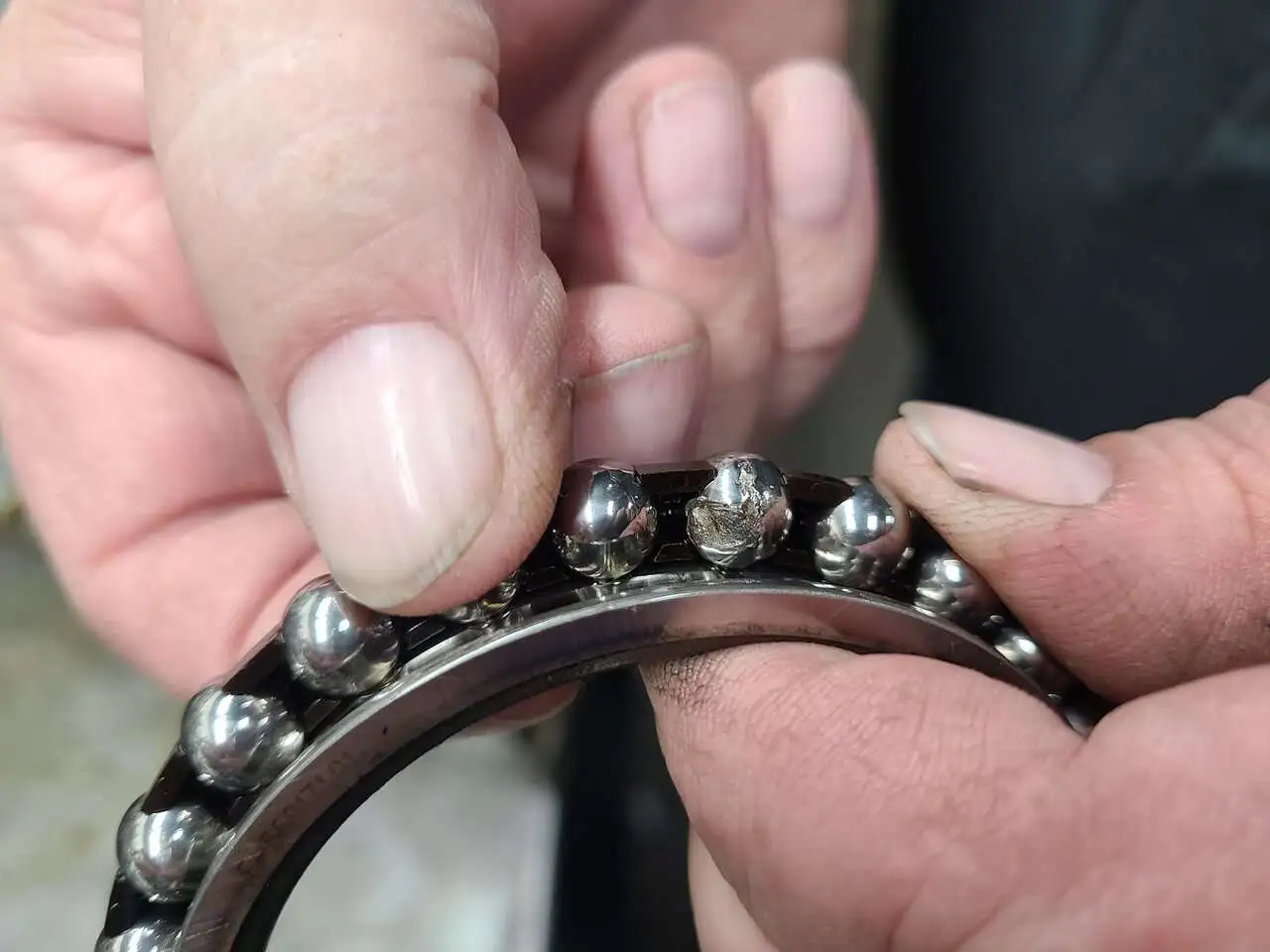

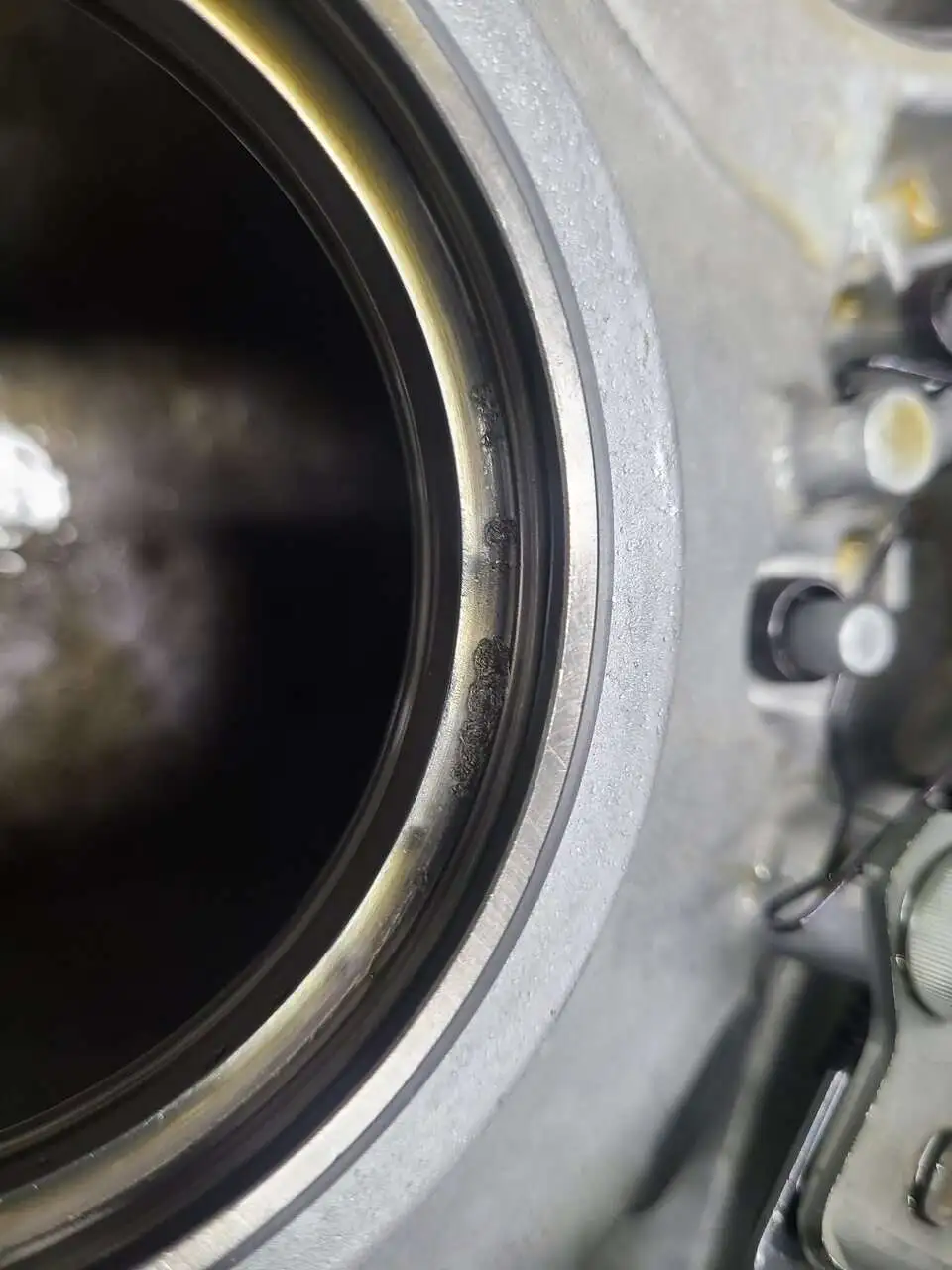

Looking at your video you linked that is the classic center support bearing sound the transmissions can get. The bearing is machined into the center case and either can fail on its own or a piece of debris can get inside the cage and damage the balls.
Thank you very much. Does this mean a full transmission replacement is needed? How would I prove this to the dealer?
Mazda does not usually have a dealer open a transmission to repair it, it's easier for them to send a new unit and then Mazda will remanufacture it. The aftermarket can bore the case out and install a new bearing or what we usually do is replace the middle case half with a new one.

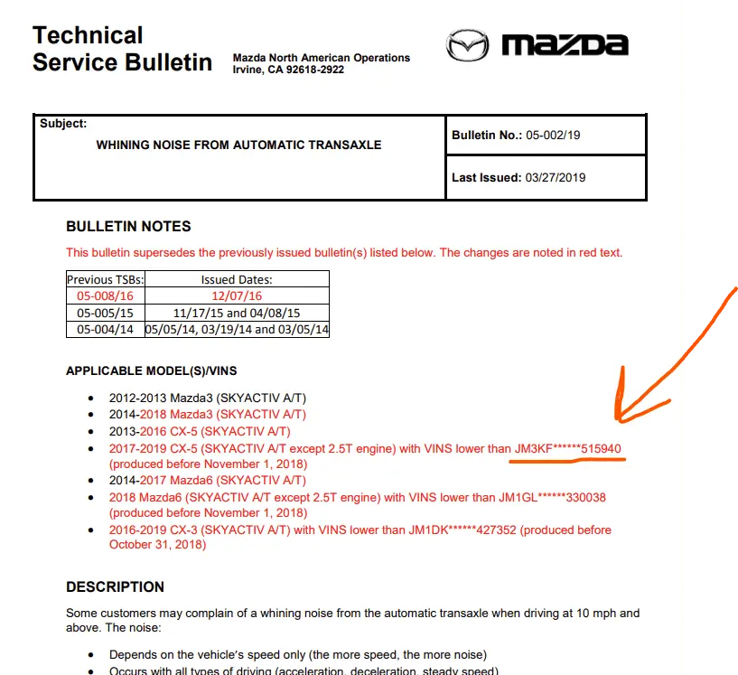

I was looking at the technical service bulletin below. Is the transaxle problem the same thing as the center support bearing failure?
What’s weird is my Mazda CX-5 is a 2021 model, produced in 9/2020. But, my VIN falls within the applicable model range. Yet the TSB says it’s only for engines produced before 2018. How is that possible?
Yes that will be the applicable TSB. It gets updated from time to time to include different VIN and production dates.
