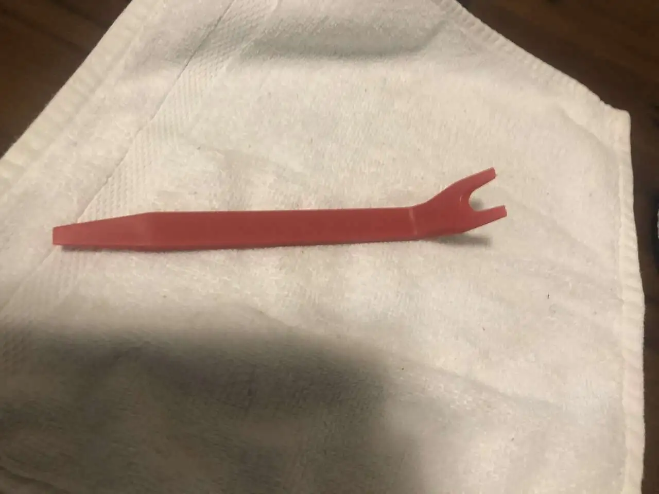

- Heres a great video that applies to both front doors - guy says you only need 2 tools - phillips head screwdriver / flat plastic wedge ....but get the fastner puller - a cheap one works too - i put a pic of mine from wal-mart :
