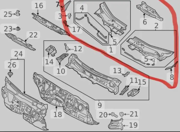

Sounds travel, what you heard might not be the origin of it. Check out your cowl panel outside of your car, if possible do dismantle them off and try driving again. Hope it helps.
