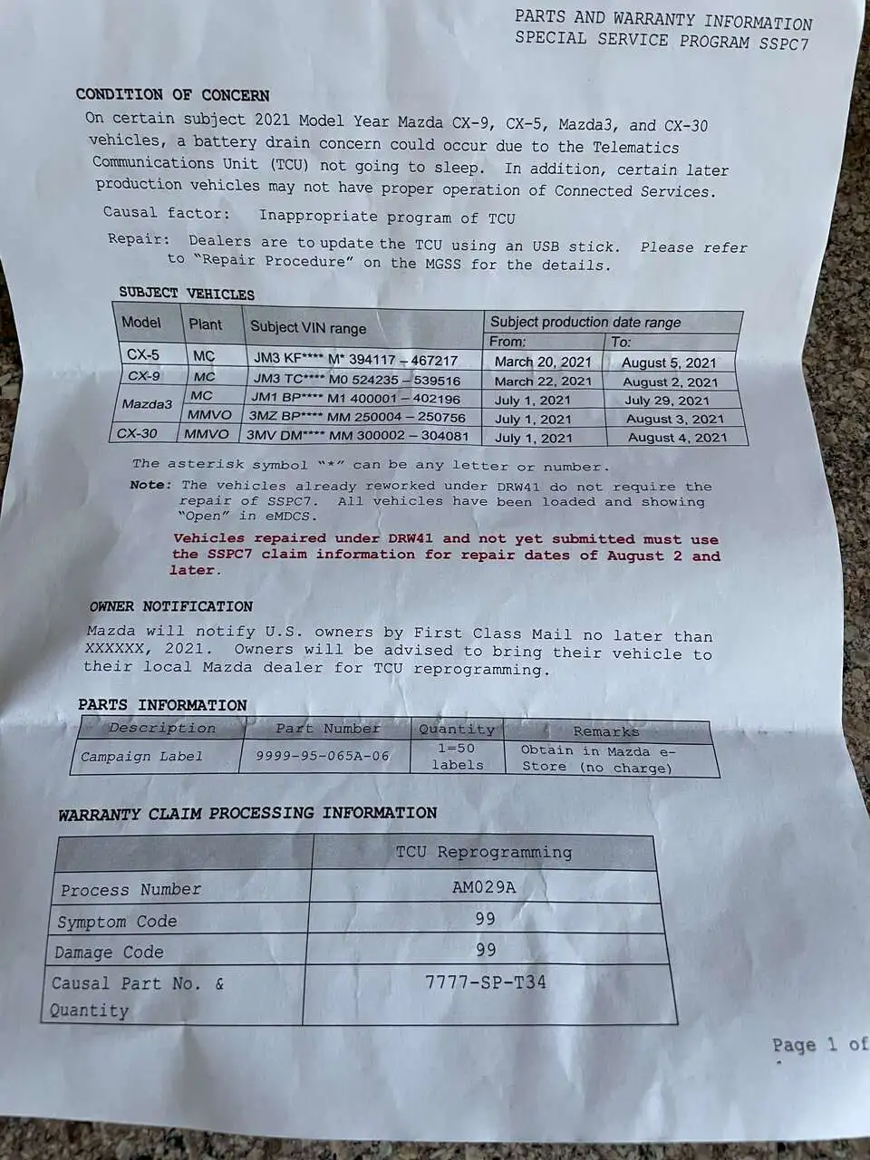

My carbon edition had a recall done for battery drain attached to the telematics. I can try to provide the details later. It was done over the air via sw update.
The documentation indicates only 21 models but I wonder if it also rolled into 22
Thanks for this. I hope I can pass it on to the dealership when it gets taken in. Our 2021 Carbon Edition's battery died about 5 months in. They said it was the rear lift gate sensor and they replaced the battery. Now, 7 months after that new battery, it's completely drained again.

Is this the TCU issue still not fixed?
