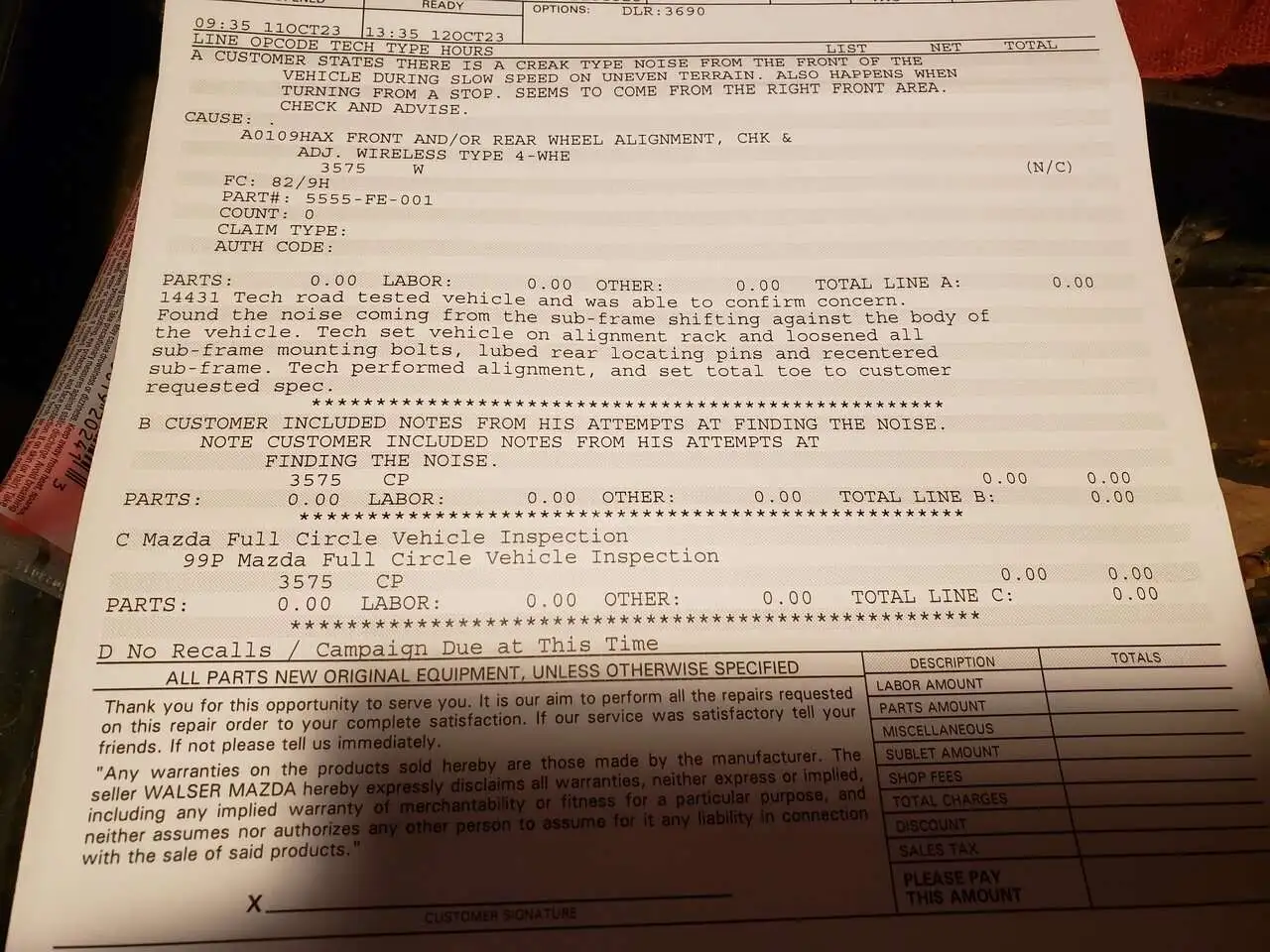

Cautiously optimistic. No creeks on the 15 mile drive home. Will update. The service advisor said they used the SST wireless chassis ear to locate the creak. God damit I hope this fixes it. I really like how my car drives. They did an alignment with my favorite .35 total tow for straight line stability too. Car drive sweet I gotta say. Props to Walser Mazda Burnsville Mn. Classy with no BS

They deserve a case of beer
That's great! I hope that's it. That's a win in my book just getting a dealer that will actually acknowledge the problem and make a sincere attempt at fixing it.
I think these guys are good. I am always suspicious that they are blowin smoke but I think they are good and did what they said. When the service writer called me to advise me on the fix he asked me if I had a preference on alingments. I had mentioned to him I had been fighting high speed wander and finally got it perfect. They needed to aling because LCAs share bolts with subframe. I said .35 or a smidge more total toe makes it stay straight. They put it at .37 total toe. Nice.
