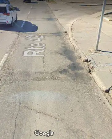

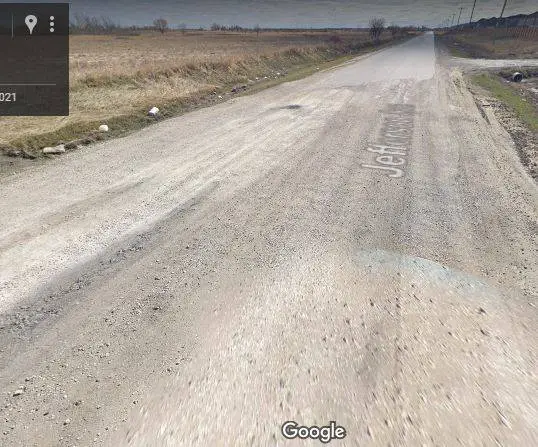

That is interesting to hear. I thought for sure that the difference would be noticeable on terrible roads. Are the roads you drive on better or worse than these?
Those look like great roads. Remember, I am in America. Now I would not doubt that a full multi-link suspension is better at the certain situations but what I am saying is that Mazda 3 did not take a huge step back with the torsion beam suspension.
