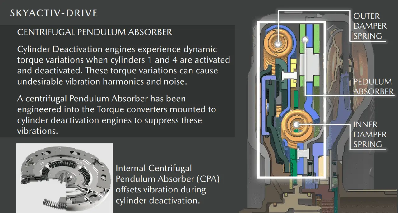

You have a different automatic transmission with cylinder deactivation in your 2022 CX-5 2.5L NA. The different single plate lock-up clutch pack, used due to the space used by the added fulcrum inside the torque converter to fight against the vibration from CD, seems to be having excessive wear prematurely and contaminates thr ATF by iron powder. Your problem could also be related by contaminated ATF.
2017~2024 CX-5 Chirp Noise from Automatic Transaxle on 3-4 upshift - Bulletin 05-005/23
This has been an issue for a little bit. The CD cars do not have the same lockup wet clutch set as the regular skyactivs do. They use a more traditional single clutch with a more aggressive material to survive early lockup. Many oems that have tried early lockup with this style of clutch experience significant issues and early wear. GM with the 6L80/90 family are the most notorious for this. The clutch set that turns on going into 4th is a more aggressive friction material that is already high metal content. The iron contaminates that set and is similar to what happens with a brake pad that becomes contaminated and makes a squealing sound.
Yep, the pendulum damper is built into the torque converter and because of its size there is no room for the multi plate lockup clutch set that the non CD cars have.View attachment 324785
