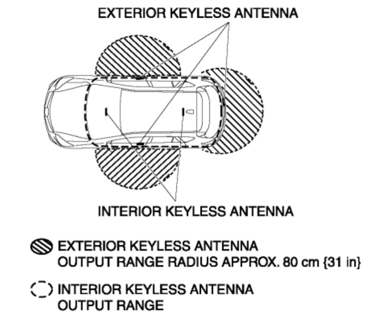

Does this help?
Yes, they are always transmitting the low frequency field seen in the diagram. When a key fob enters the field, an encrypted exchange between fob and car begins to determine if the fob is one that is stored in the computer. (I think the computer can store up to four) If it is, the door can be unlocked and the car started once it enters the interior of the vehicle.
The fob (while it can vary depending on the system) is typically in a low-power state so that it can determine when it enters a vehicle's keyless entry zone. This is why a Faraday box is necessary for the fob as the bad actors can extend the range of the vehicle's keyless entry zone and trick the fob into beginning the exchange. The Faraday box will block the low-power signal from the fob and also prevent the signal from the vehicle from reaching it. A Faraday box is better than some kind of metal can or box as both the material and size of the mesh are critical in the range of frequencies that are blocked. Faraday cages are designed to block radio waves. Metal boxes are not.
