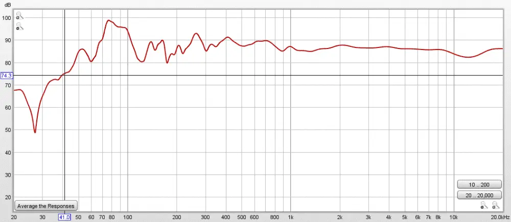

So, i brought out my laptop with REW and measured some frequency response curves using my UMIK-1. The microphone sat next to the driver's headrest. Response smoothing set to variable smooth.
First impressions: I noticed hardly any difference with the subwoofer connected or disconnected. I, also saw no difference between standard and linear... All measurements taken with the Centerpoint at 1, Audiopilot at 0.
Standard, Centerpoint=1, Audiopilot=0, Bass=0, Treble=0
Subwoofer Connected = Green Graph
Subwoofer Disconnected = Red Graph
I was able to get the most flat response by setting the treble all the way up and setting the bass to -3
Standard, Centerpoint=1, Audiopilot=0, Bass=-3, Treble=+9, Subwoofer connected
I was curious to see what crossover point the subwoofer is set at. I thought i would've seen something more dramatic when disconnecting, but that wasn't the case. From the graph... maybe it's set at 80 or 100Hz... but obviously is doing nothing in the 20 to 70Hz range.

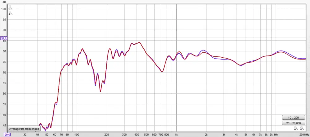

Combined Curves to see the effects of the Bass and Trouble settings.
Treble: Green=0, Blue=+3, Brown=+6, Purple/Blue=+9
Bass: Green=0, Blue=-3, Purple=-6
Last Graph: Standard vs. Linear. Both set to Centerpoint=1…. It appears Standard and Linear only apply if Centerpoint is off.

That's actually not horrific. Yes, you definitely need a real subwoofer. You've got to do that for sure. A DSP would do wonders as well. I use a Dayton Audio DSP-408 in my wife's van, as they are very inexpensive (only about $150!) and have 10 bands of full parametric eq per channel.
I would wire the Dayton to the inputs of the Bose amp (which I am almost certain is 4 channel, LF, RF, LR, RR), and then also use that to feed the subwoofer amplifier instead of using the speaker level output from the Bose.
The only way to get a *reasonably* representative car system measurement using an RTA, is to pan hard front-left, front-right, rear-left, rear-right and sum the measurements visually (save them and display concurrently) or in software. If you just fire up all speakers and put a mic somewhere you'll get the sum of all the speaker arrivals, but given the different distances from speaker to mic, they create a complex comb filter at the mic capsule, most dramatically shown in the severe +/- swings in the response below 1kHz,. The response isn't *really* that ragged. The *measured* and ear-confirmed response above 1KHz gets increasingly more accurate as the comb filter influence is very dense and tends to be averaged decently in software.
As for the sub, that steep roll off at 70 Hz is likely your source signal, or how it is getting into the head unit, or something in the mic signal chain, which is masking the sub from the measurement. In other words, if you can *hear* the sub coming and going but it doesn't show in your measurement, then the measurement is faulty. And if you can't hear the sub coming and going, then your source signal/path is faulty.
While that is certainly possible, I highly doubt it. MiniDSP UMIK-1, while certainly not up the standards of something like a Bruel and Kjaer, is actually a pretty damned good piece of kit for what tiny bit of cash it costs. Each individual mic comes with its own calibration file that REW uses to make sure that a baseline measurement is indeed flat.

Yes, I am a design professional in electroacoustics. The root issue is that there is multiple arrivals at the mic for drivers covering the same part of the spectrum (e.g. two mid-low drivers arriving at different times). This is compounded for vehicle cabins which have relativity small dimensions, where the flight times of drivers operating in the same spectrum are close enough, and thus the FFT can't be windowed narrow enough to remove the additional speaker sources, without impacting FFT resolution.
What caught my eye was the huge suckout at about 180Hz; unless defective, this isn't (probably) the actual response of the speaker, nor the perceived response of a human ear, but 99% of the time an artifact of measurement; mic location, FFT windowing, using a time-ignorant RTA mode.
The sag at 700Hz or so is a suspect artifact. You could close-mic measure the door and pillar drivers to determine if the driver really is that ragged, or the suck out is an artifact of mic location and/or FFT "hearing" and summing multiple driver arrivals.
If you move your mic 6" one way or the other and the response radically changes, then the measurement where the dramatic changes occur is FALSE. Your measurement is lying in that part of the spectrum.
I wasn't dissing your measurement equipment, but rather suggesting *something* in the source or measurement chain is causing the steep LF rolloff, where your ears hear the sub is present, but the measurement doesn't show it. Thus the measurement is is false in that part of the spectrum. Can be a measurement software setting, a filter mic on a mic or mic interface, a pink noise source that was accidentally processed with a LF cutoff, etc.
Last; try my suggested measurement approach to minimize the number of drivers operating in a given spectrum; e.g. just one mid-LF driver and one HF driver per measurement. OVERLAY those curves; wherever on the curves they closely follow each other, THAT is likely the real response, and BTW, the ONLY part of the spectrum you should attempt to EQ.

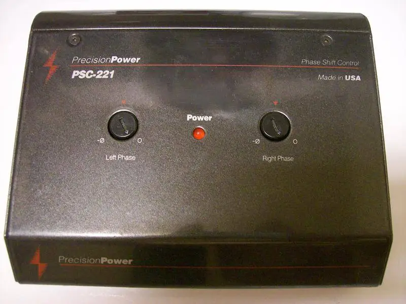

But, a cool story: back in the 90's, before DSP really became a thing, Precision Power came out with a component called the PSC-211. It was an analog phase shifter that was continuously variable from 0-360 degrees.
There was a lady named Alma Gates who was going for the World Record in SPL in her Ford Bronco. She was using PPI components, and they sent over a case of their PSC-221's. They hooked them up, and dialed in each individual speaker to give exactly the same phase response at 40Hz where the measurement mic was placed. Getting those speakers in phase was the sole reason she was able to both set the world record in SPL!
That piece was so easy to use. Just turn two knobs while you're watching the SPL Meter. When the numbers increase, you're getting more and more in phase. When they go back down, back off, and move to the next. Easy piezy.

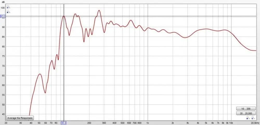

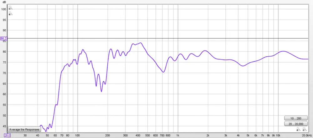

There is something definitely wrong with my measurements and the work Dell laptop I was using... i measured my home system which has a very good subwoofer (SVS SB-2000 Pro) and I saw a similar result as I did in the car... no low end frequencies. so I brought out my old Toshiba laptop... see the difference below:
Dell laptop (I tried both Bluetooth and a direct analog connection.. same results as below)
Toshiba laptop
Now, the Toshiba does not have Bluetooth so the above measurements were both using an analog connection between the laptop and my BlueSound Node 2i streaming music player.
Since the 2021 Mazda does not have an AUX input, I'll have to buy a Bluetooth device in order to get my Toshiba laptop to take measurements.... or I could try a pink noise source which I might try later on.
