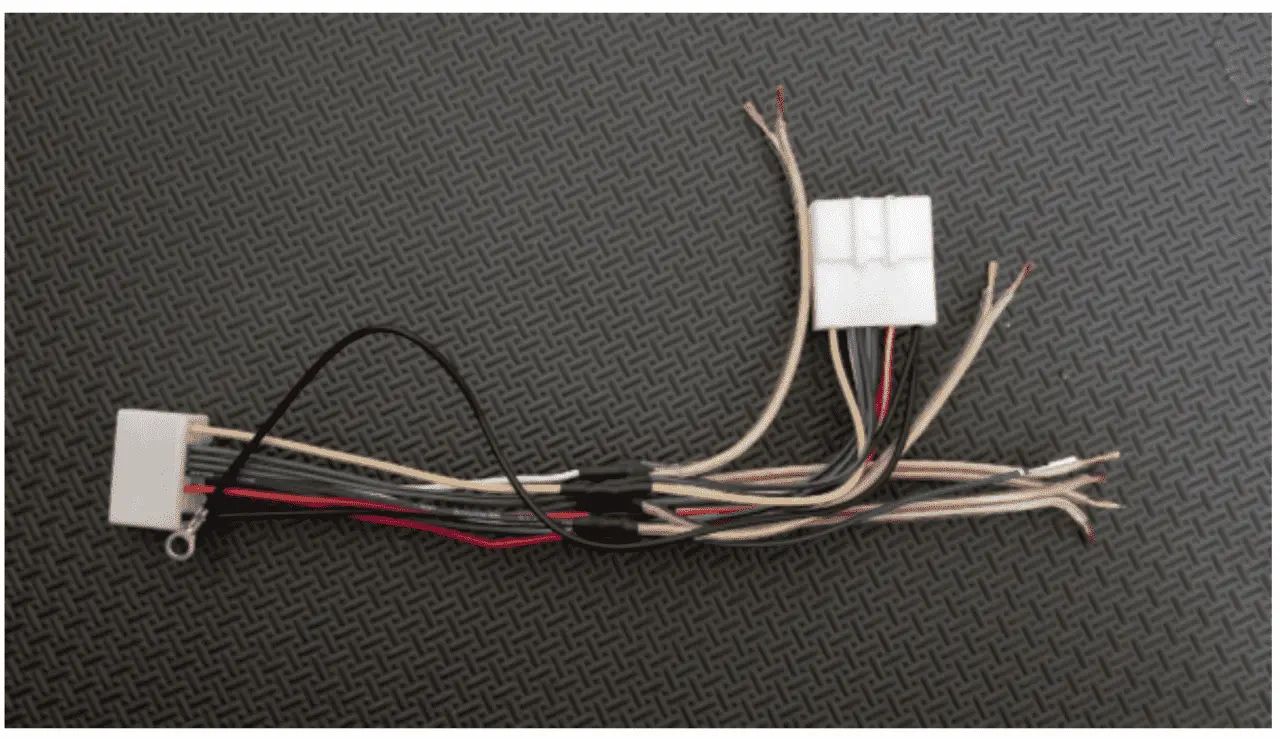

Finally got around to making the T connector/splice.
Used the following items
Female RCA ends
Connector Male
Connector Female
Followed this DIY
and used this pin out for reference:
took a while to do, as I'm a bit ocd with making sure wiring is correct. But, soldered, heatshinked, and tesa taped the whole thing so it's clean.
Now just need an amp wiring kit, amp, and speakers :)
Thanks Phil!
