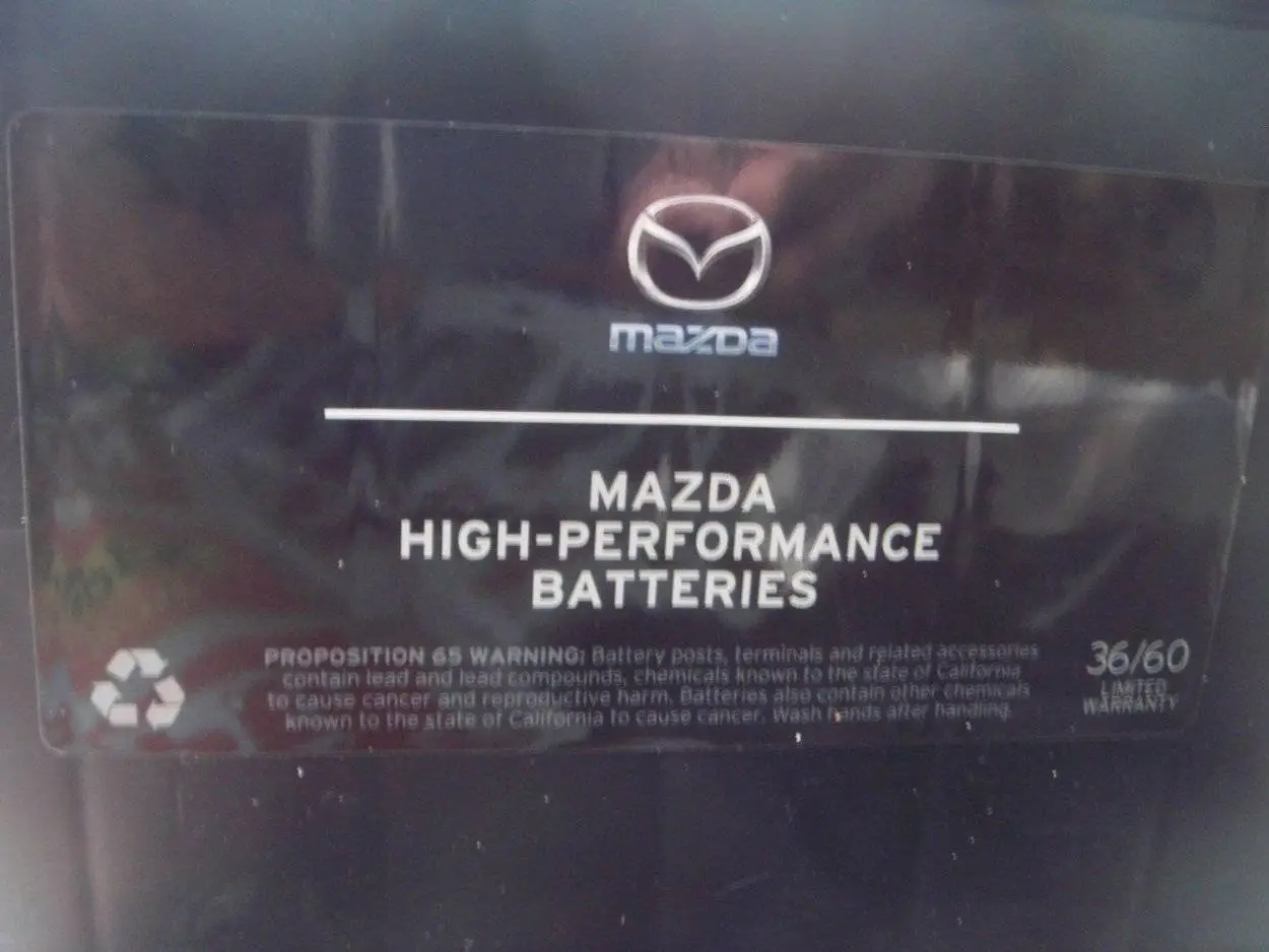

Well, Mazda will give you a “High-Performance” battery too for replacement ⋯ ;) I actually bought one last October after the factory Panasonic battery was failing which had served me 5 years and 9 months in hot Texas weather.

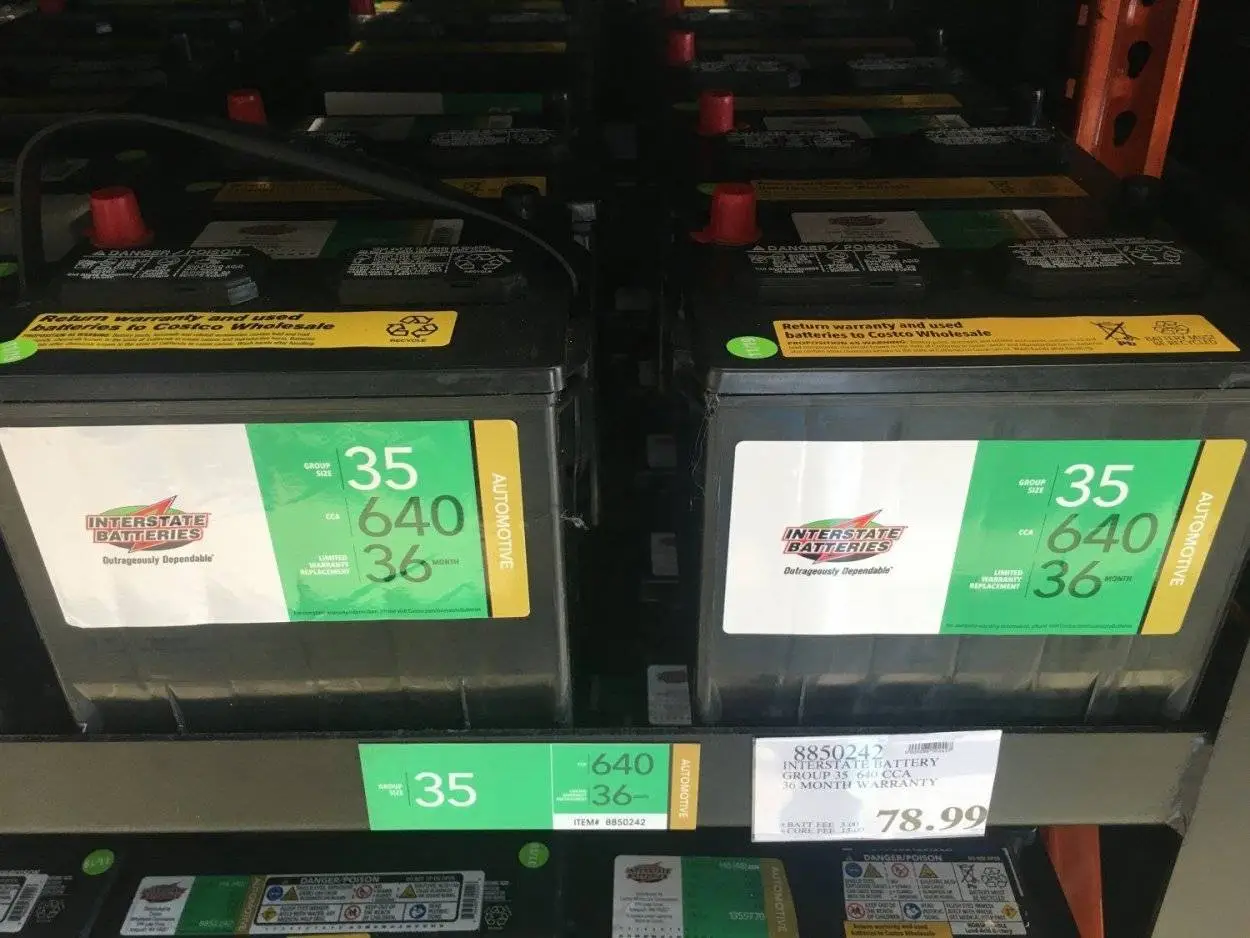

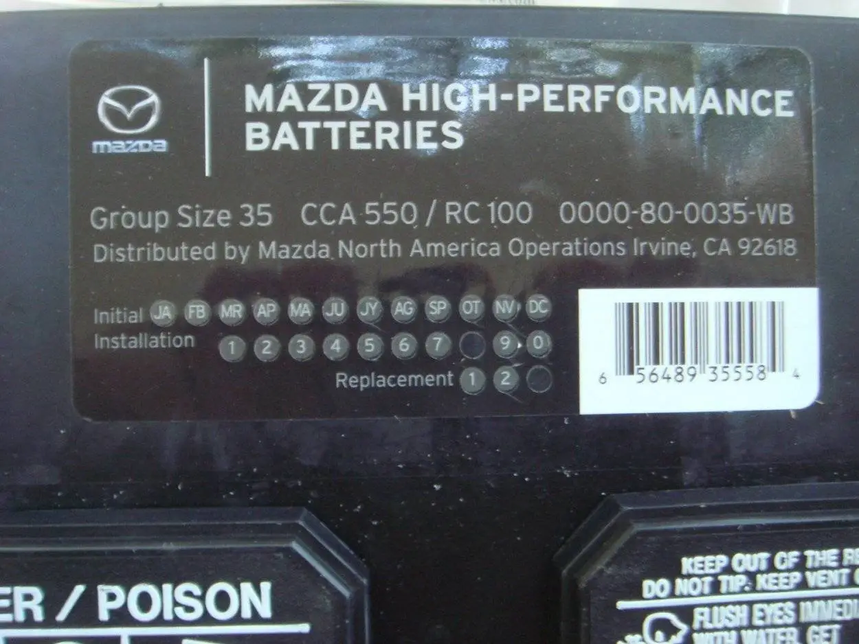

The Group 35 OEM battery sold by US Mazda dealers for CX-5 is made by Interstate. Other than the case color, it looks exactly the same as the Interstate Group 35 battery sold at Costco for $79. The difference is OEM battery has 550 CCA with black plastic case but Costco Interstate Group 35 battery has 640 CCA with white plastic case.
OEM battery has 36/60-month replacement warranty. 1-36 months: free replacement and labor. 37-48 months: customer is responsible for 70% of the battery MSRP and labor. 49-60 months: 80% of the battery MSRP and labor.
Costco Interstate battery has simple 36-month replacement warranty.
If you consider much higher MSRP and labor charge on OEM battery, the 60-month pro-rated part of battery warranty is almost meaningless.
