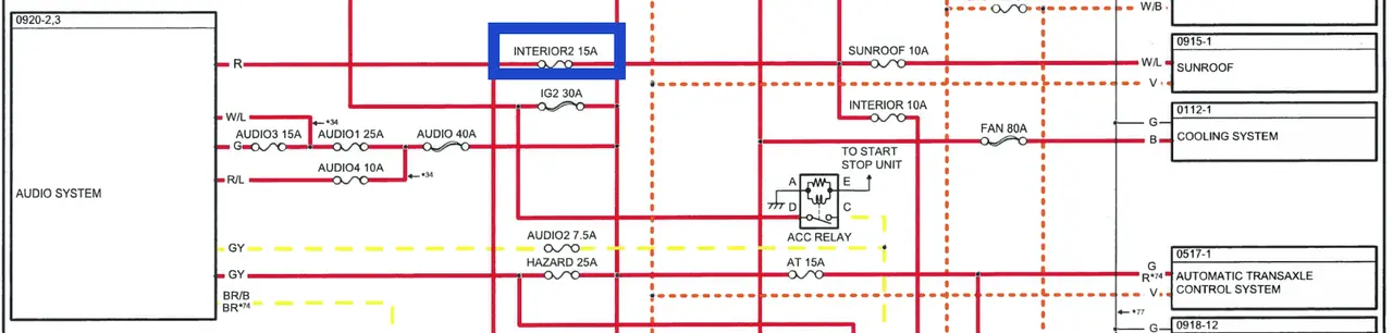

Meter connected in series: 1.9a draw (after sitting for 30+ minutes).
---> Removing Fuse10 (Interior Box), 15a: drops to .01a (after ~45seconds).
Looking for advice on next steps. Connects to the audio system, not finding any tsb related.
