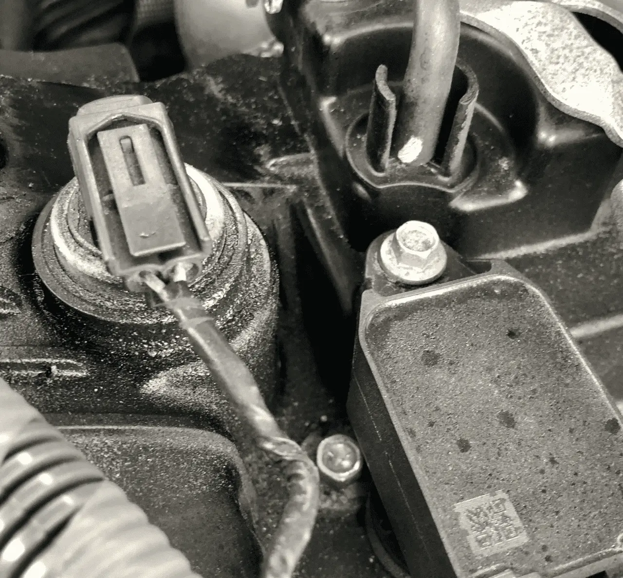

Maybe pull the plastic engine cover off and see if you have oil seepage around the Oil Control Valve. Seems to be a common issue.
