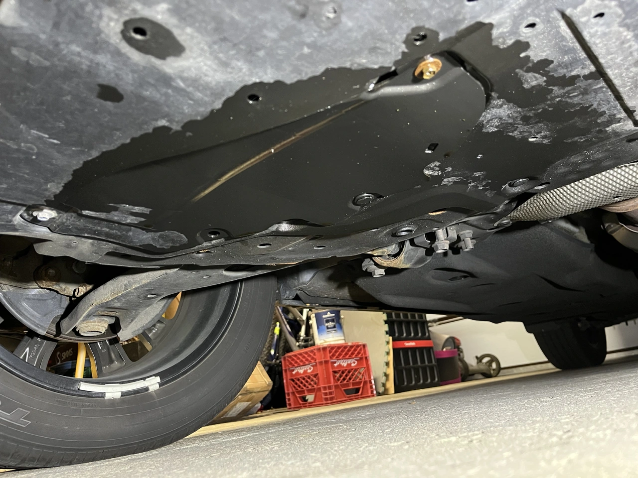

Thanks I just posted it and no the last service was in July.Need a pic.
It was golden colour like regular oil colourCan you tell what color the oil is on the garage floor?
Did you get a clear reading or was the entire dipstick covered? Oil needs time to settle down, at least 20-30 minutes in my experience, before you can get a clear reading on these cars.Oil level is fine in car so far but the oil was all over the garage
Mazda DealershipIf the oil level is fine and you have that much oil on the floor and cover it must of been drastically overfilled. Who did the oil change in July?
Let the dealer solve this problem and report in writing to the leaderships OWNER and cc the service manager. I would do this because of the irresponsible service. In addition: the undercover should be removed and power-washed to remove any oil stains remaining.
Dealerships should provide a gold standard for service.

have cx-5 2019 also after 20k have oil leak had extensive oil dye and borescope done;2019 CX-5 has just over 20,000Km.
Lots of oil underneath the car.
