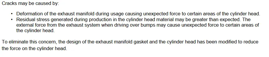

But these cracked cylinder heads that are showing up shouldnt be across multiple years. Where was the quality control?
They designed a high pressure high temp engine and then apparently the bolts were overtorqued causing micro-cracks which eventually expand to become a problem, hopefully before the warranty is expired. And the high pressures will only exert more force on an already defective head.
I've seen comments on 2014 to 2019 having these cracked cylinder heads across the CX5 and CX9 platforms. At what points did they check the robotic torque machines?

I don't think you can conclude this problem was due to over-torquing bolts, although it may have contributed. Mazda changed the head design to mitigate the problem. If it was solely down to a bolt torque issue, they would not have required a head casting change.
As far as how this could slip past QC:
1. It took several years of service before these issues started appearing. I'm sure Mazda did some sort of life testing, but it may not have reproduced the combination of heat cycles, mechanical loading, and other effects that real life use placed on the cylinder head.
2. The prototype and qualification blocks and heads were likely cast in a different foundry and then post machined in a different shop than the production blocks and heads. Small differences in alloy composition, mold fabrication, melt pour, post heat treatment and other processing could have yielded different material properties in the metal. It's possible that the testing blocks all passed with flying colors, only for the production blocks to have slightly different material properties which led to the cracking issues now.
And head cracking is a lot more common than you seem to think. If you crack open a Subaru block, for instance, they are notorious for cracking from the spark plug hole to one of the exhaust valves. However, the crack doesn't penetrate the water jacket so most people remain blissfully unaware that there is any issue. Honda has also had an engine or two where this was not unheard of, but again, most people would not realize there were any cracks.

Didnt the TSB say overtorque caused the problem hence the redesigned head ?
the cracked head is both a design flaw and a manufacturing flaw.

Why are we talking about over tightening the turbocharger bolts during assembly? The TSB says that the cylinder head casting isn't strong enough to carry the weight of the turbocharger and the rest of the exhaust system:
