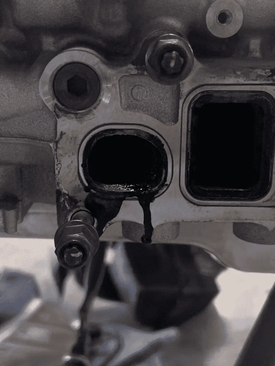

Update: GEICO is working with the dealer on this Mechanical Breakdown Claim. GEICO is unfortunately requiring the cylinder head to be removed and sent to a machine shop to be torn down and measured, even though the price to do so is (according to my service advisor) $200 less expensive than simply ordering a new cylinder head from Mazda and replacing it.
I have to authorize $1575 for 9 hours of machine shop services to have the cylinder head torn down, which if GEICO determines was a "covered repair" I won't be on the hook for. I sure hope GEICO does me right.

You could try to get the dealer to confirm in writing the cause is the one identified in the TSB, then send both the mazda confirmation and the TSB to Geico. If it is a cracked cylinder head as per the TSB there is no way they can fix that head. Or even better, get the independent shop to go to the dealer to confirm the fault is the same as the TSB. A cracked head is pretty obvious without tearing down the whole thing. May not work but it is worth a shot.

I really hope you're going to totally reject this, and demand instead that the head be visually examined for cracks, at the time it's removed from the block. The TSB has pictures of where the cracking should be located and, if present, should be visible without the need for any (NINE HOUR o_O) tear down by a machine shop.

Dealer says they are going to examine head closely once removed and will let me know if any evidence of cracking.
Correct, you cannot fix a cracked head

Correct, if the dealer notices any visible cracking upon removal, they will let everyone know. Have to say, I'm kind of disappointed with GEICO. It's supposed to be the equivalent of a manufacturer's warranty. GEICO requires the customer to play for all "diagnosis" fees, but the problem has already been diagnosed (coolant intrusion into the cylinders) as evidenced by borescope camera. So now GEICO wants to institute additional layers of "diagnosis" (they are the sole determiner of what needs to be "diagnosed") instead of just replacing the cylinder head per Mazda procedure and getting the car back to me in a timely manner. The only plausible reason GEICO would do that is if they thought they could get out of paying the $1,575 for 9 hours of "diagnostic" labor, since the dealer has already confirmed that the price difference is only about $200 between reusing the old head and replacing it with new. I'm hoping for the best, but expecting the worst. Imagine having a transmission failure and they require you to authorize 50 hours of labor to tear apart and measure every single gear, with no guarantee that it will be a "covered breakdown" until doing so.

No it covers gaskets. Dealer wanted to replace the entire head without further diagnosis because of the likelihood of future issues and $200 price difference as opposed to teardown. GEICO wants tull tear down of the head before anything else happens, couldn’t care less about $200 price difference since If head checks out they’ll claim “working order” and stick me with machine shop bill, and only pay for the gasket labor (at least that’s what I’m suspecting.)

UPDATE: Cylinder head not resuable because it has evidence of cracking. Brand new Mazda factory cylinder head being replaced. Technicians checked the bottom half of the engine and pulled the oil pan, no evidence of any contamination or metal flakes in the oil. GEICO picking up the tab for all of the repair except my $250.00 deductible.
