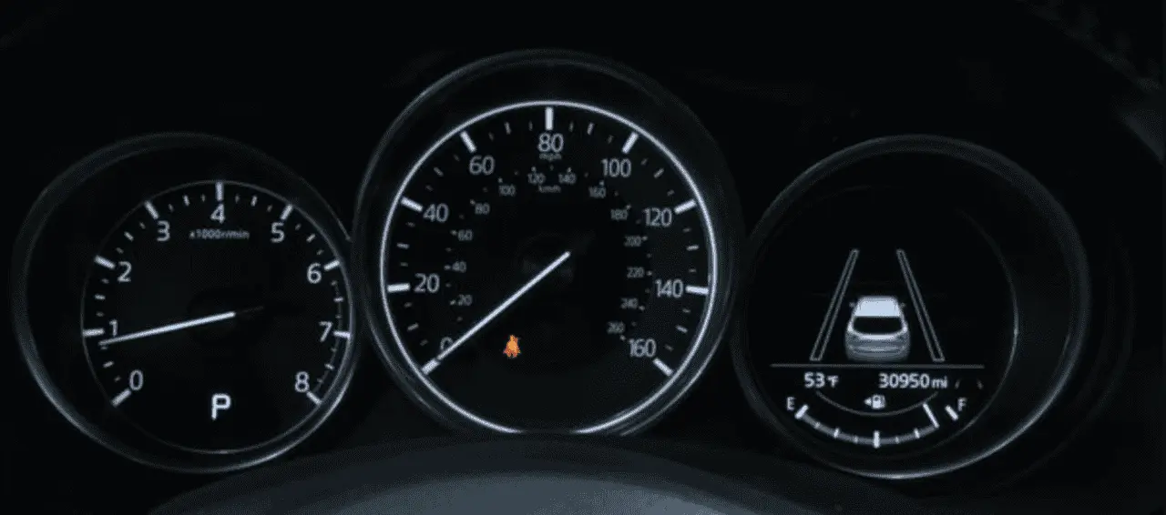

I read multiple threads about importing US CX-5 to EU (Switzerland). I just bought one from 2018 (G164) that was imported from US, and it has all papers done (even technical verification), so I do not expect any problems later with this, or should I?
What I would like to know, if it's possible to swap the speedometer with an EU one? Its hard to see the small km/h numbers on it, and I would prefer to have everything in km/h.

I have this variant, not the digital one. Actually if it's possible to retrofit with the new one (display in middle) that would be even better.

Regarding your first question - You can change to Euro one but it may have to be coded , plus the total mileage would differ. You could try to open it and just put a special sticker with just the KM/h.
The digital is from 2019- on the US models. Not sure if it can be retrofitted. Probably not.
In the meantime I got used to speed in mph :D
