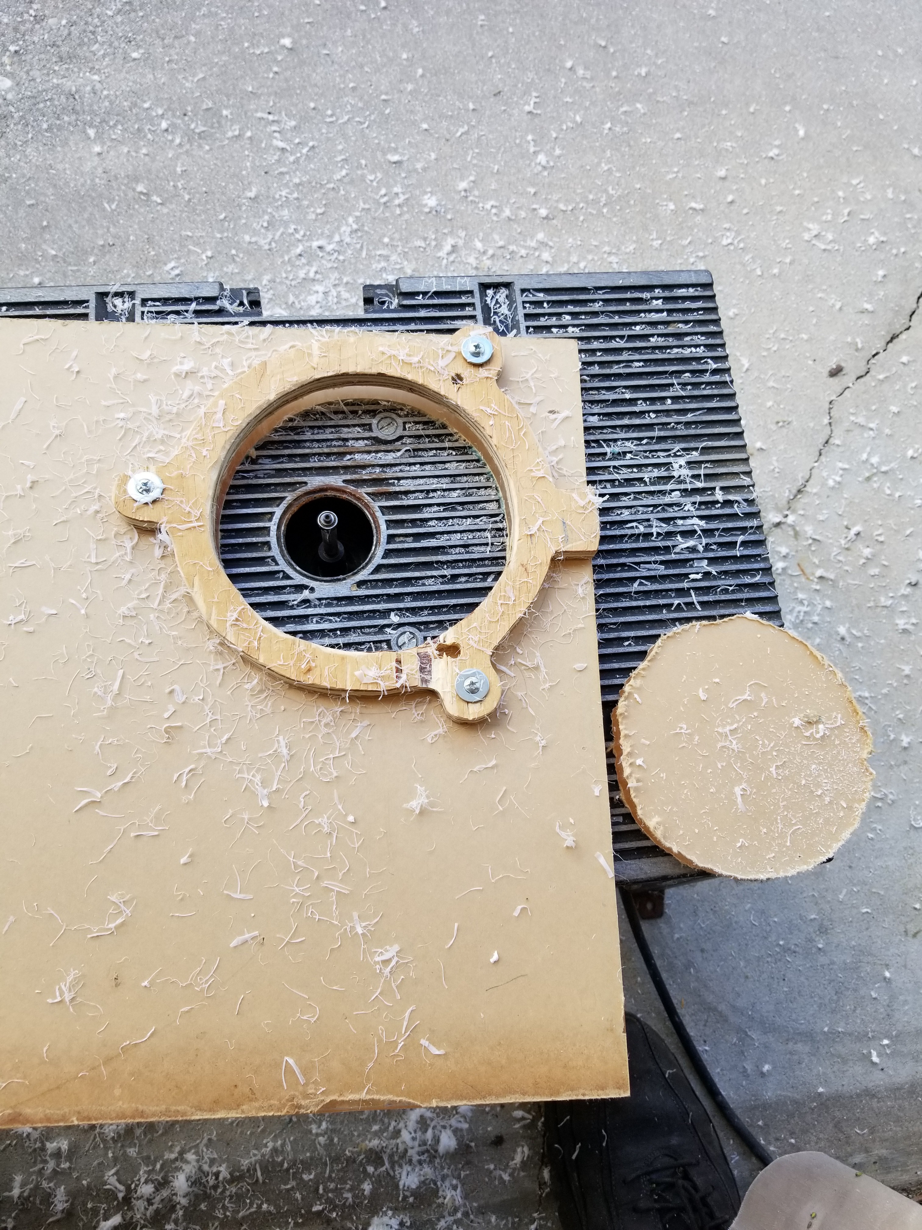

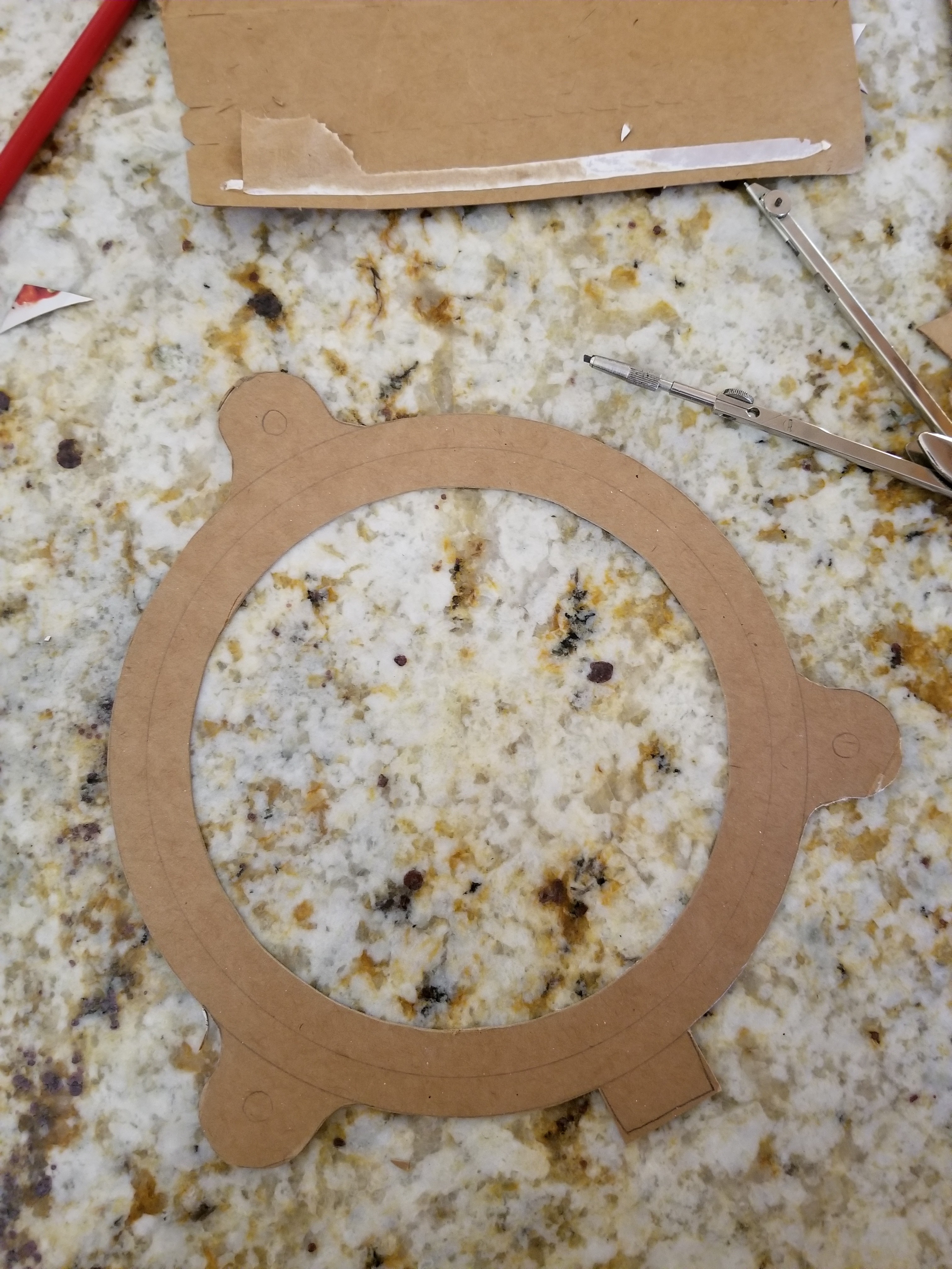

So as mentioned, I've been putting in the JBL GX600c 2-piece component and the GX602 2-way speakers. The included brackets were useless so I made a template:

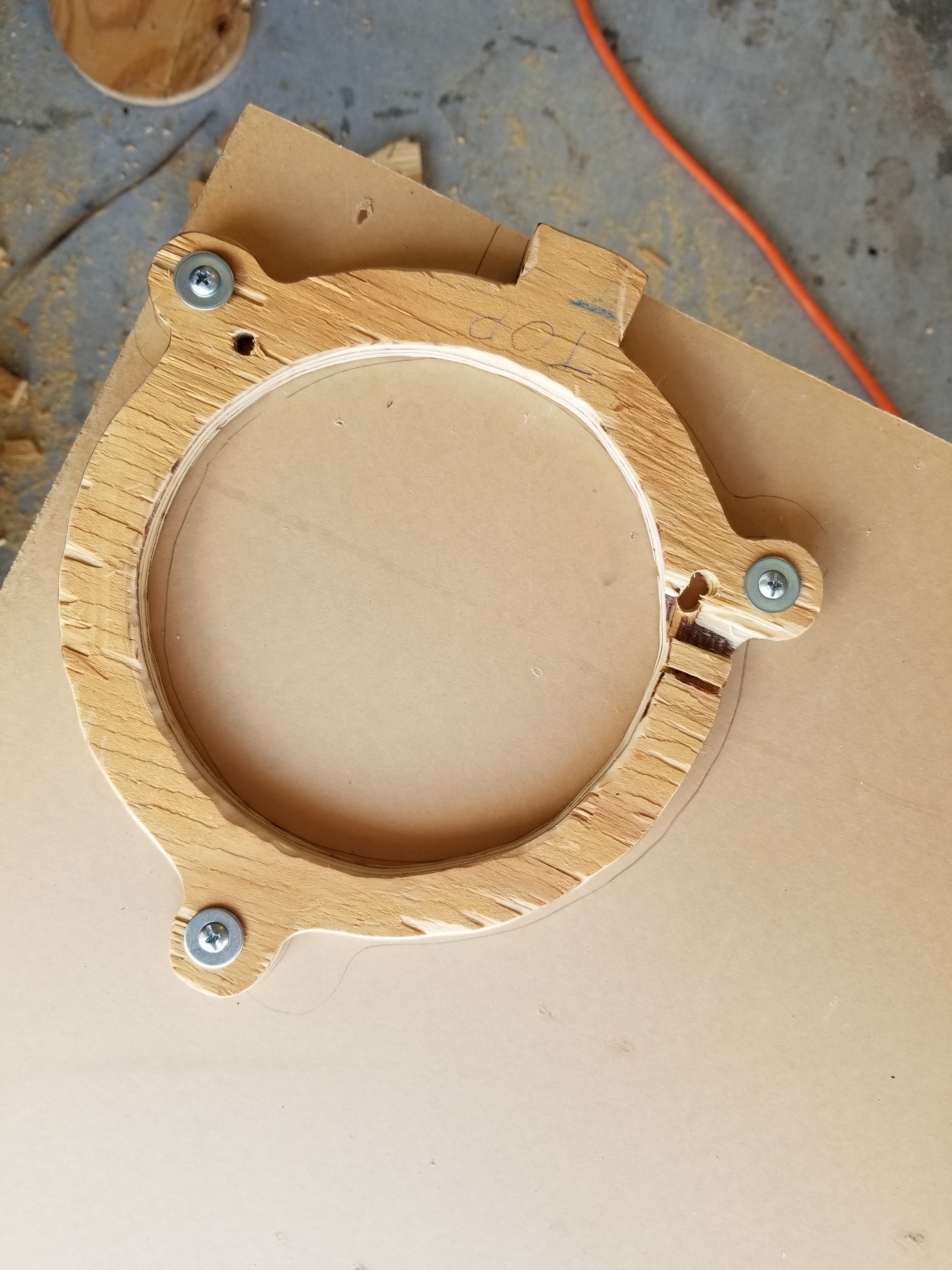

I then transferred it onto a piece of plywood using a jigsaw and then sanded it down to make it a bit smoother. It didn't come out nearly as good as my cereal box template :( , but then I used it as a template onto some 1/2" acrylic I had laying around. Here it is for my first one where I screwed it onto the plastic to then use my table router to cut it out "quicker".
And here it is started.

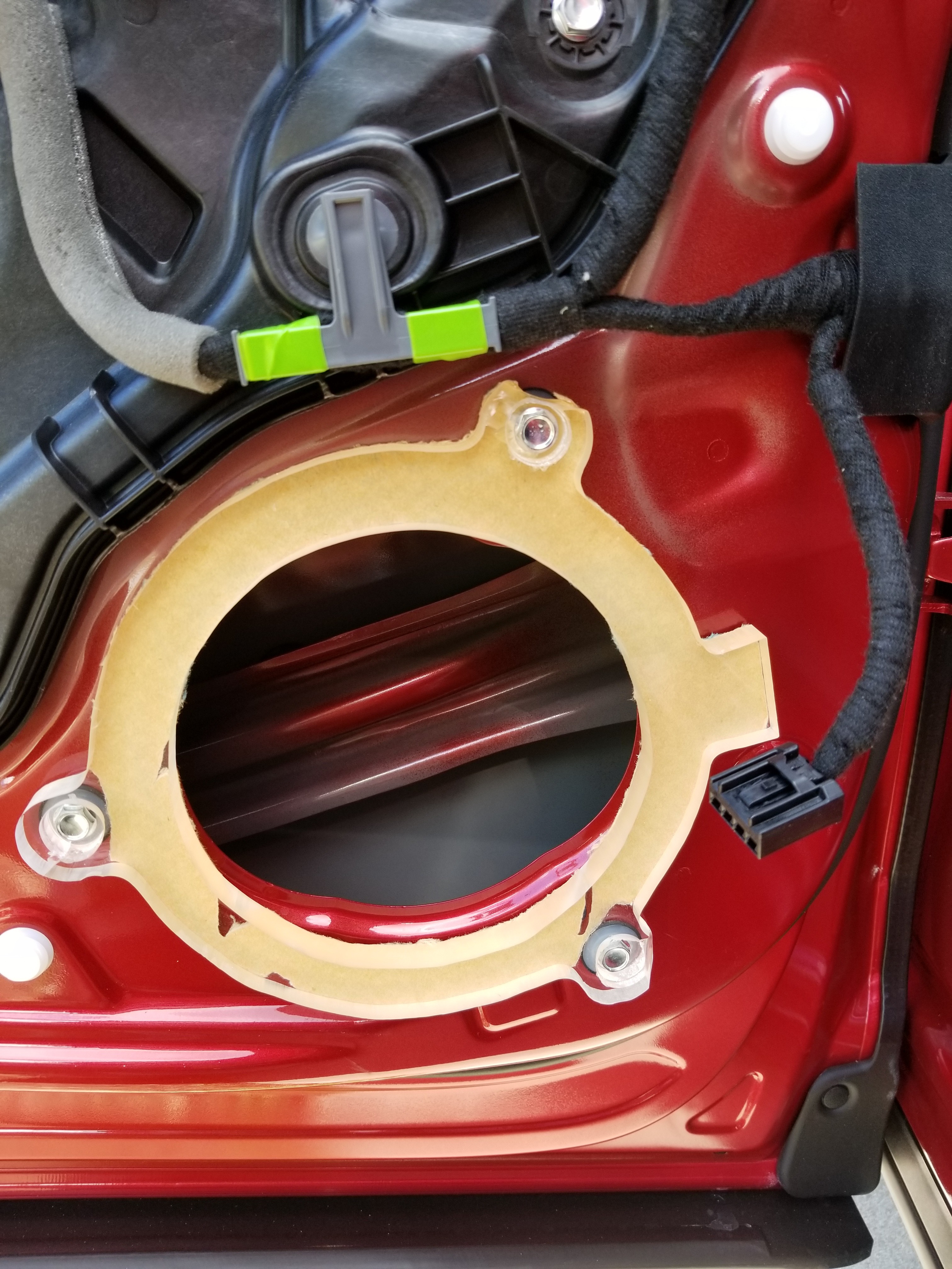

Here's a quick test-fit onto the left-rear door:
And finally here's the finished product. I ended up routing a spot for the speaker cable to sit behind the mount.
I was able to take out the speaker connector clips using an exacto knife to push the pin holding each connector in that clip (two per clip). I then was able to just use some 18-gauge wire I had laying around to connect each speaker to the existing connectors. I first tested for negative/positive using a volt meter and then put red wire into the positive and red heat shrink wrap on that, then black for the negative. I just soldered the wires to the terminals on the speakers as I didn't have the appropriate connectors. Mounted it all again. It sounds great even though I've still got to do the front-left combo.
I mounted the tweeter on the triangle in the corner of the front windows with snips of 3M command strips I had left over. It may have been better if I put them in the A-pillars, but hey, no cutting the car works for me!
