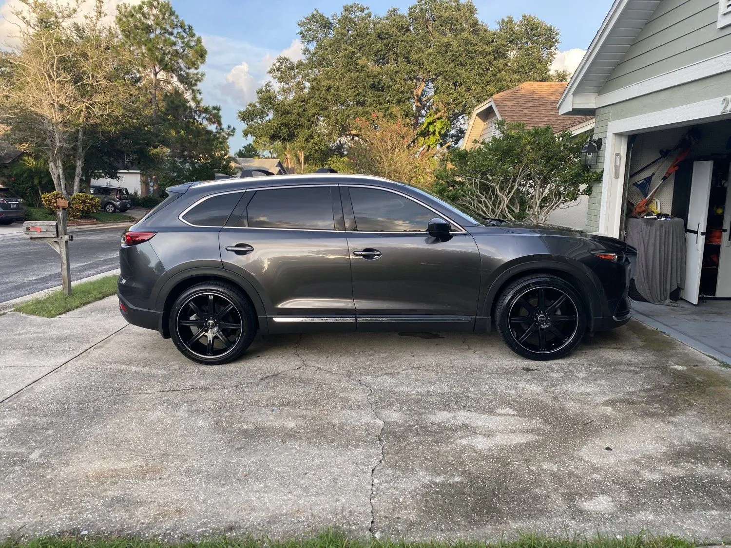

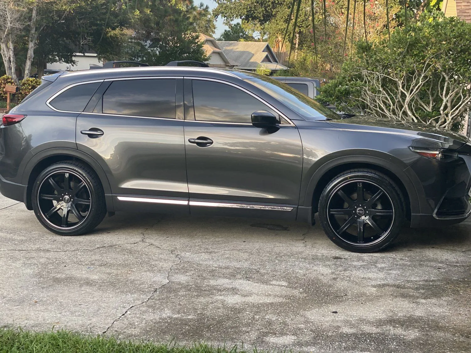

2017 CX-9 Signature with 22” x 9.5 wheels
I’ve seen where some people have used 285/35/22 tires on their CX-9 with 22x10.5 wheels. If you go with 22x9.5 wheels you can get a similar look with 265/40/22 tires. No rubbing and ride comfort is similar to OEM. I went with a bigger tire to help ride comfort. Wheels have an aggressive offset at ET15.

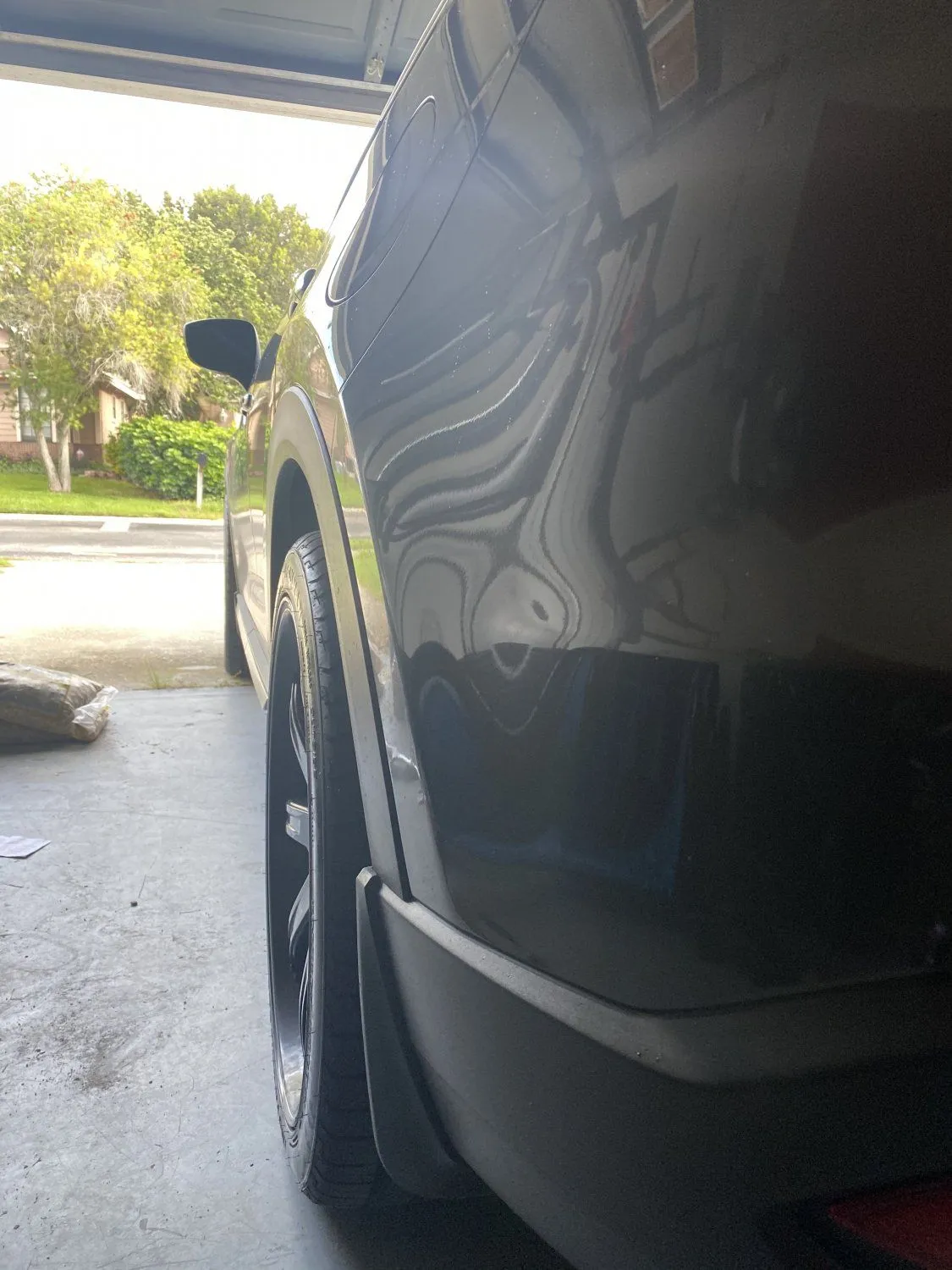

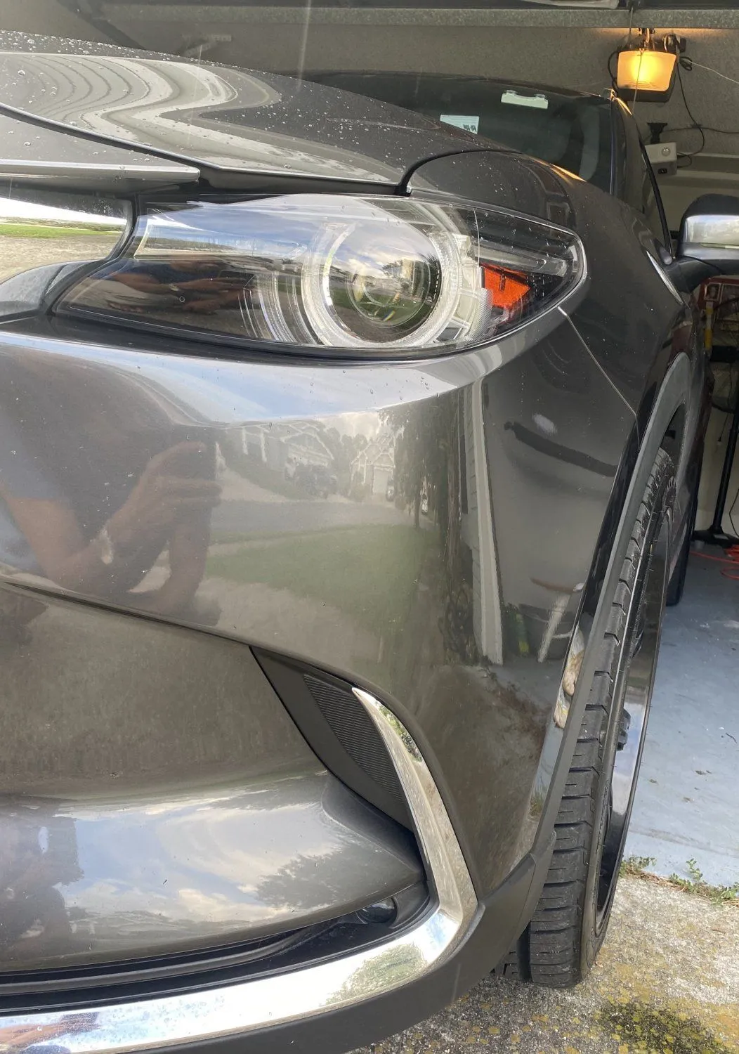

Looks good! Do the wheels poke out at all? Would love to see a shot from the rear or the front.
They are pretty flush. If any, the poke may only be 2-3mm.
