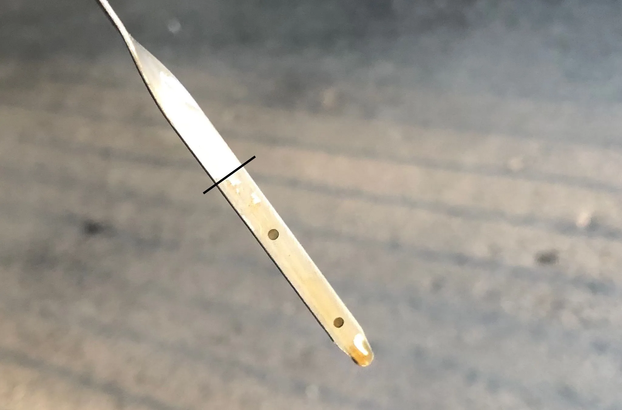

Hey all, looking for an opinion on a couple of things. I have a 2017 CX-9 with 20,000km (~12,000 miles) in Canada.
1. The photo attached is the dipstick after an oil change. This was the day after the oil change and the car was sitting on flat ground. I've spoken to the service manager several times, and he states the oil capacity is 5.9 litres (vs 4.8 in the manual) and that this amount "should be fine". Any thoughts on if this amount is too much?

If you choose to continue getting your oil changed at the dealer, I would simply get it in writing (preferably right on the invoice), that the service manager verified that filling oil to 5.9 litres is "normal", and get his signature. Personally I wouldn't trust it and I would follow the manual and the dip stick reading instead. At the very least, if you ask the service manager to put his name behind what he says, he will likely double check his information and may end up redoing the oil change and filling to the upper dot.

They actually put right on the invoice 5.5 litres (vs 4.8), which essentially puts it in writing on every invoice.

My dealer did the last change and put in 5.1 liters. (Well, more accurately, he charged me for 5.1 liters!) 5W30 synthetic.

The extra oil is no problem, but you should not pay for more than the manual specifies.
