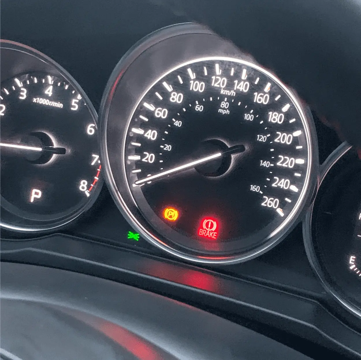

2017 CX-5 Touring EPB light issue
I've recently bought a 2017 GS(Touring) model and have found that the EPB light blinking with the "P!" light lit up regardless of whether the EPB is engaged or not. (I can hear EPB getting disengaged)
The only way to get the lights to go away is to turn the engine off and start it back up, and then disengage (or engage and then disengage if the EPB was off) the brake...
The only time the EPB light does not blink is if I engage the EPB without pressing down on the brake pedal.
Anyone else come across a similar issue?
I've seen some posts about EPB issues but that seems to be for 2016 or older models, I have a 2017 (JM3KF* vin) which is supposedly not effected by it.

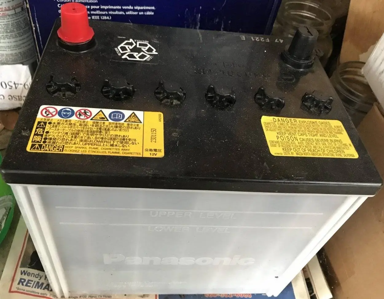

if your battery looks like this, you still have factory Panasonic battery.
