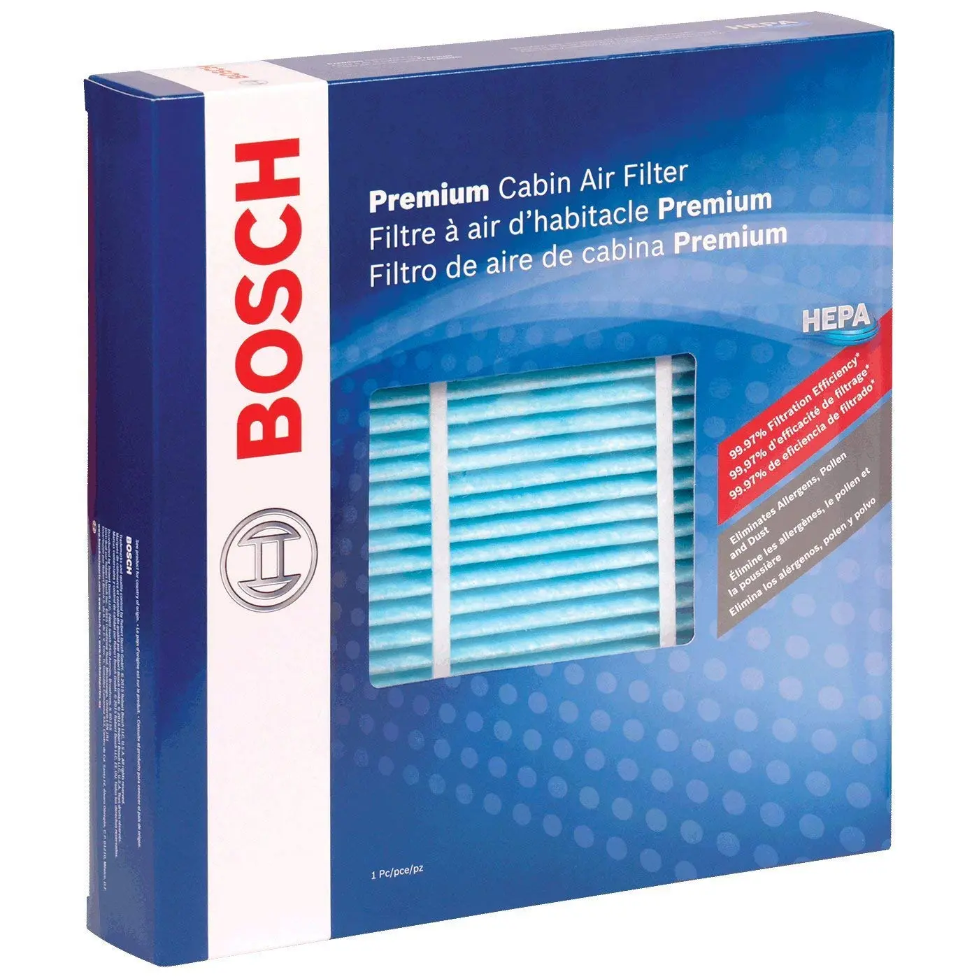

I replaced the factory cabin air filter with a Bosch HEPA filter. It reduces airflow a bit, but it works very well and offers very fine filtration. It is a heavier filter than the standard filter.
does the bosch seems genuine?
Just my .002 worth. Just like your home HVAC unit, the less stress you put on the blower motor the better. An HVAC pro known and trusted in my area says "buy the cheapest filters you can find, and replace them more often..." I would think HEPA or other similar filters in a vehicle might not make sense since as soon as you open the door the air exchange is almost immediate with the outside air, in your house the air exchange is far less.

As far as air pollution, the air outside is typically much cleaner than indoor air or in vehicle air, because pollutants build up in a sealed space. Especially in a new car. I always open the windows a few seconds for some fresh air when starting a drive. I like the HEPA filter because it lasts a long time, and is still working great after 4 months. The performance of a carbon filter is great initially, and rapidly degrades. I believe there is sufficient airflow not to overtax the blower motor.
HEPA makes sense anytime and everywhere to filter PM2.5s. Especially in big cities.
