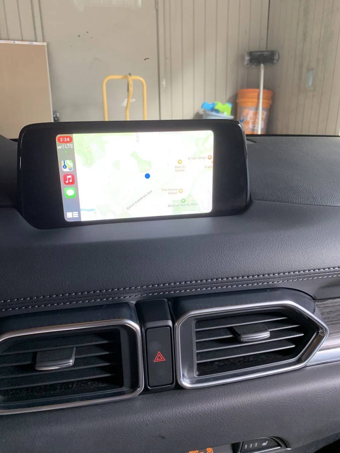

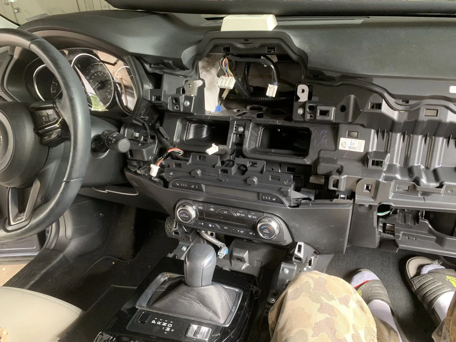

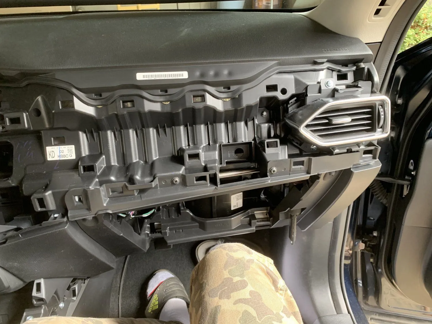

I installed the 2019 CMU into my 2017 and installed the new cables at the same time. Everything works fine. Only snafu was the language was all in French and metric because I bought the part from Quebec. Easy fix. It already had the 700 software update so I didn’t even need to update the software.

I bought the part for $65. It was listed as a Bluetooth radio. There is a sticker on the back with the Bluetooth frequency. That’s probably why it was sold by salvage yard as a Bluetooth radio. Saved over $1000.

Simply deleting Mazda from Bluetooth settings on phone and letting phone find new Mazda allowed Bluetooth to work. Apple CarPlay works fine with my iPhone. Seems there is no discernible difference between model year parts. Hope this helps other people.
