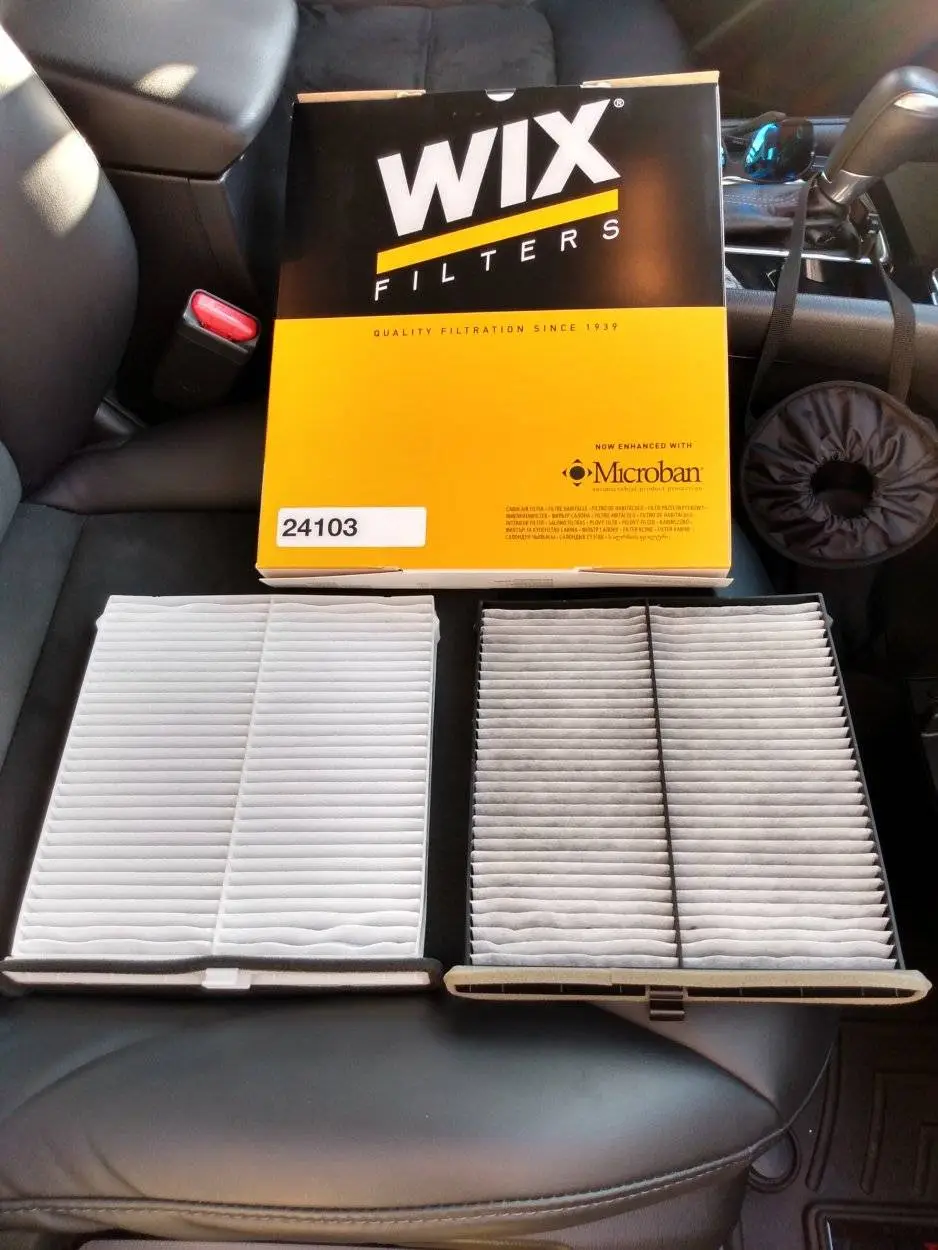

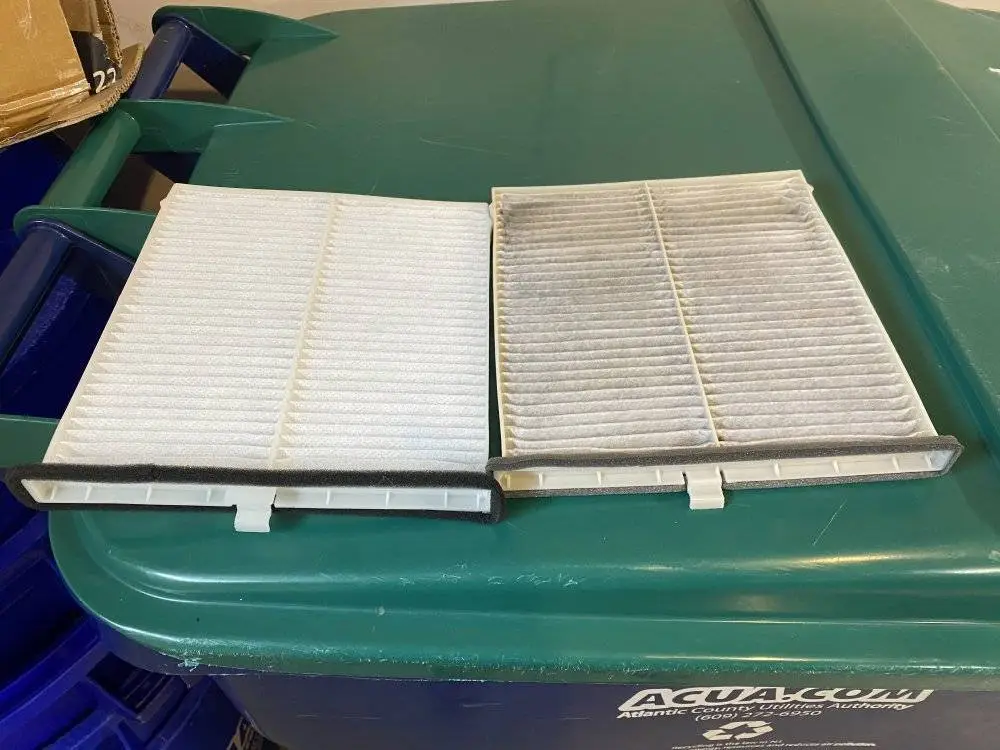

I replace the cabin air filter in any used car I purchase. It eliminates most previous owners smells. Here is the Wix cabin air filter replacement, and how to lower the glove box to install the new filter on a 2017 CX-5. The install took about 5 minutes.
Wix Cabin Filter PN: 24103

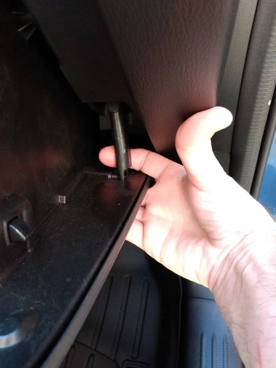

Pull out glove box plunger rod.

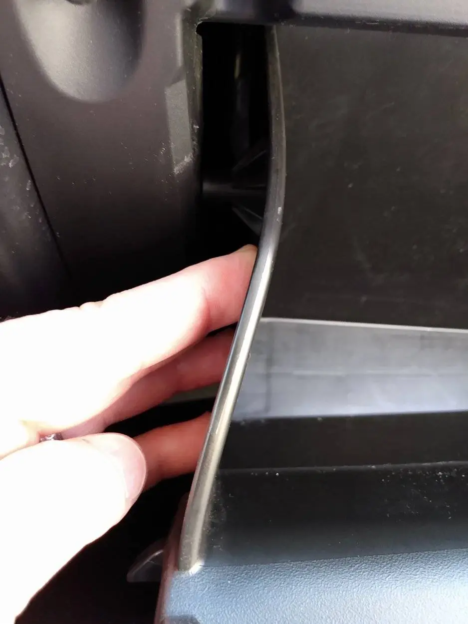

Push in glove box tabs and drop the glove box.

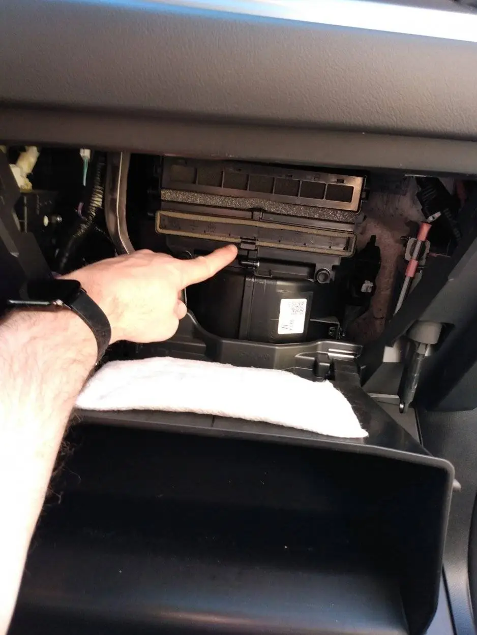

Cabin air filter location pull old one out.
Re-installing the the glove box push in on both sides of the glove box so that the tabs click back in and snap in the glove box plunger rod...Done!
