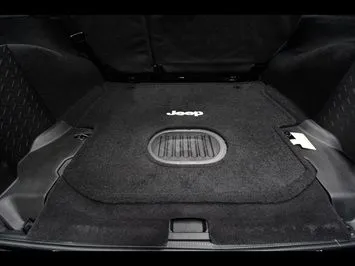

Lol :). Something custom made would be nice. Something like the Jeep all weather sub. Exept we dont need it to all weather. Just a good grill to protect it.
