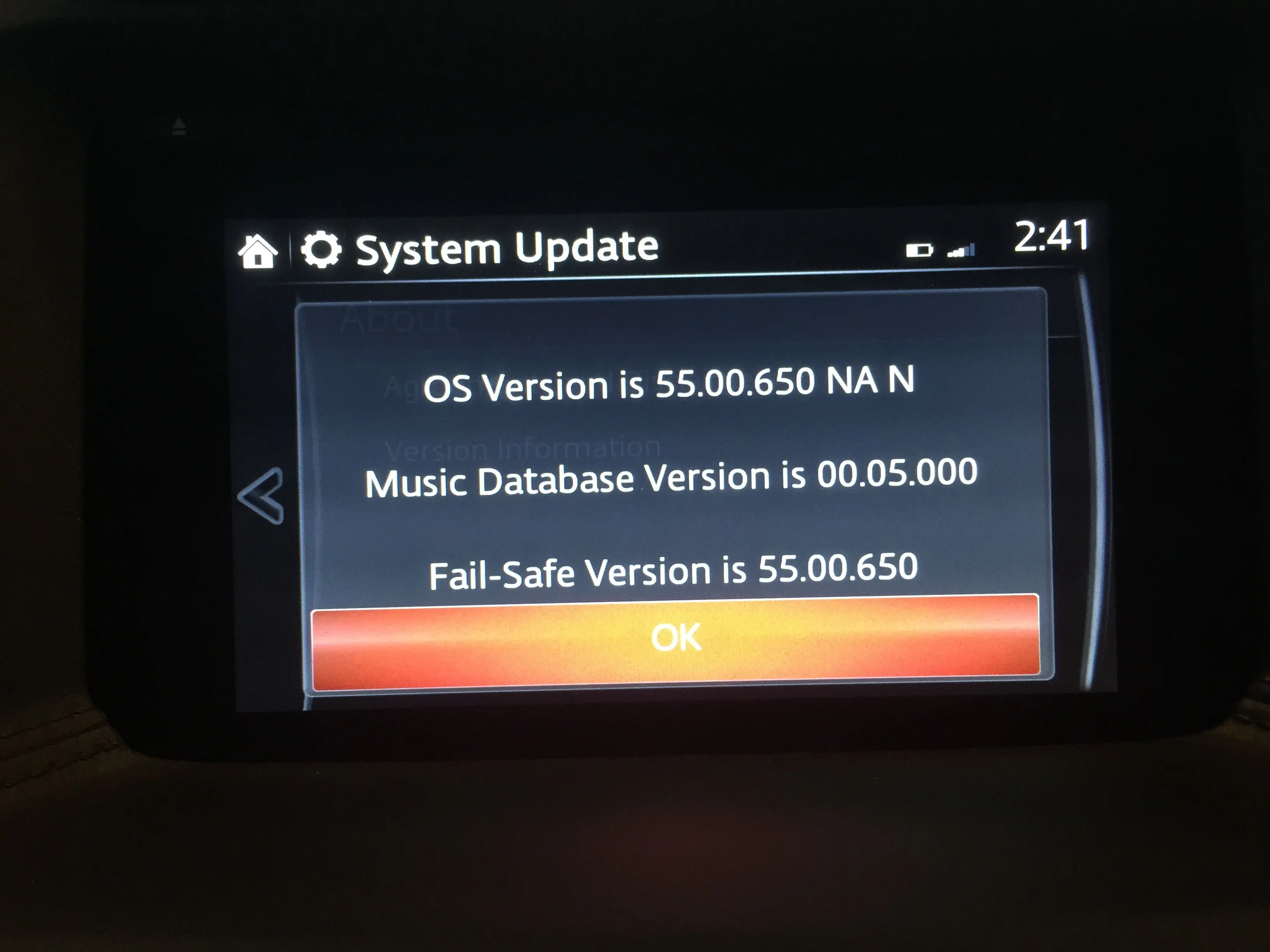

FWIW here is the new version info:
Yeah, from the main menu go to -> settings -> select "system" tab on far right -> scroll to the very bottom and select "about" -> then click on "version information"
Thanks for posting this! I just checked ours and it is also on version 51. How long did it take them to update it?
I was there a couple hours - at first they said I had the most up to date version, but then they called Mazda to make sure. Mazda gave them the version 55. They downloaded it onto a stick and updated my car with it. They said I was the first one getting this new version there but now that they have it they will be updating their inventory with it to lessen future service calls from other buyers.
So don't be surprised if they tell you there isn't a new version out there, ask that they call Mazda and get it from them. I think most of my time there was from the dealer trying to talk and download it from Mazda.
