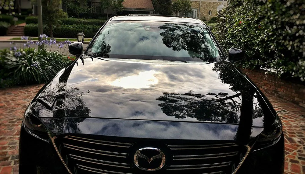

Here she is - we named her Helen after Helen Mirren - cause she's gray and hot...
