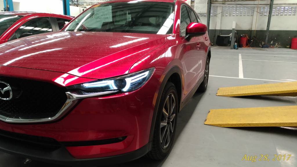

Our headlights here in PI does not turn on with the DRL at daytime applications.
Nice! And that's what it should be for US CX-5, like 2016 CX-5 LED DRL configuration!
Yeah I know. You guys kinda scared me after hearing that your DRLs operates with the headlights during daytime driving. Mazda parts are very expensive here in this side of the world considering we are near Japan. I was also told by a collision shop that the a piece of headlight for the 2016 model costs more than $2,000. I just don't know if the price is for insurance claims. Accredited collision repair shops here tend to "overprice" their purchases when claiming for insurance payments.

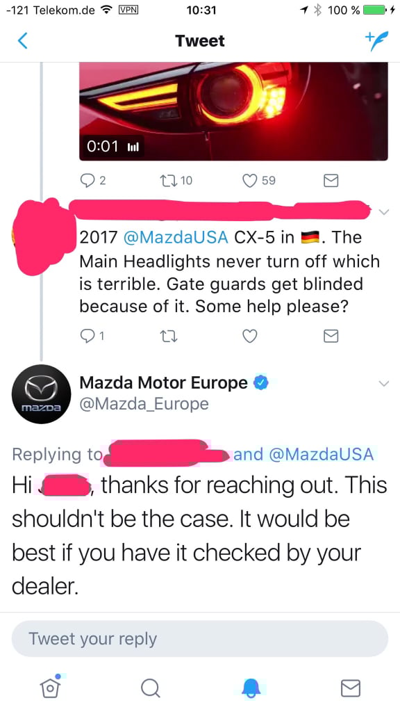

2017 - People...I did the code and I thought it worked, but I was stationary. The headlights still turn on.
It's a problem for me because I go through a military gate every morning and it's courteous to turn off the headlights, which I cannot now. Fortunately I don't drive the CX-5 often.
Either way, I tweeted Mazda Europe..
I also just fired off an email to Mazda USA,Europe, & Germany
You have the ALH headlights. Different than north american standard style LED with adaptive turning and auto headlight.
Your whole headlight inner workings and controls are different despite the same styling / look from the exterior.
