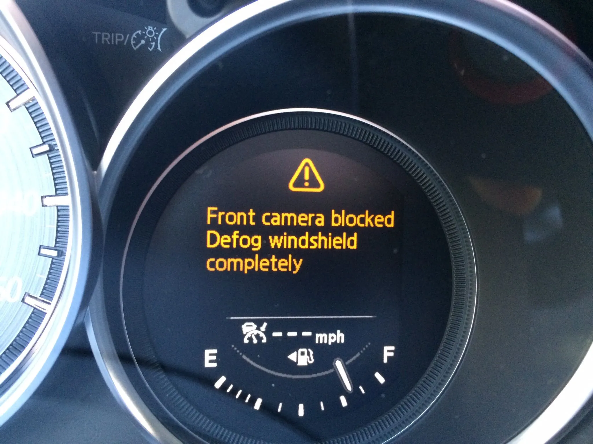

We bought the 2016 Mazda CX-5 Grand Touring with The Tech Package and i-Activsense a few weeks ago. Everything is great, except for one occasional problem that we can't figure out.
Once or twice a week, we get the following error in the information panel:
"Front camera blocked. Defog windshield completely." (There is a picture attached.)
The problem is when this happens, the windshield is clear. There is nothing blocking the camera's view. After a minute or two, the message disappears and everything is fine.
I checked with the local dealer and they were unfamiliar with this problem. Unfortunately, it's so random, it's unlikely it will happen when we take it for them to see this firsthand.
Has anyone seen this on their 2016 CX-5? Do you have any idea what might be causing this?

I've had it a few times. It's random but only ever happens when starting the car from a cold start. I've never seen it when starting the car after its been running for some time.

My guess is the humidity was high which caused the condensation on the interior side of your windshield around Forward Sensing Camera (FSC) area where you couldn't see clearly. Or the interior side of your windshield around FSC may be a little dirty and needs to be cleaned. Still, Mazda dealer should be responsible to resolve this issue if this message is popping up too often. Even if your dealer said they were unfamiliar with this problem and didn't know how to fix it, the dealer can always escalate the issue and get help from Mazda North American Operations.

Thanks for your reply and this is the first time I posted something here :) So far we think the i-ActivSense features are working properly except this warning message...probably the system is a little too sensitive?

It happened once to me: I thought it was confused by the background it was"seeing". Once I moved it out of the underground garage, everything was fine. The wall it was facing was gray in color. No problem in my garage.

I had the front camera error message yesterday when picking up my wife. I was parked facing large glass windows on her office building. I think it just didn't like seeing it's reflection because there sure wasn't any fogging or high humidity. 60 degrees and 60% humidity with the sun out. It was in the shade where I parked so as soon as I backed out of that spot it went away. I think the camera just gets a bit confused with what it's seeing.

I was just telling my husband about this happening on my car and he mentioned seeing it, but he also said he saw it when it was raining and figured that might have something to do with it. I've seen it several times now, sometimes right after starting the car and sometimes right before I'm about to turn it off. So far as I can tell, it doesn't appear to have to do with humidity (it's happened mainly on dry days). It still seems to be pretty random, though.

Yes, I also get this error message once or twice a week in my 2016 CX-5 Akera (diesel) and it comes on several times during my drive into town (20kms) and there is no fog or window obstruction. Will report it when the car goes in for its' first service and see if Mazda Australia have any thoughts.
Yes that error happens sometimes. It is related to condensation on the inside or outside of the windshield. Usually turning on front defrost will clear it up after a few minutes. It has to do with the windshield area in front of the camera (inside the car) not getting the same air circulation as the rest of the windshield, and hence, sometimes condensation happens. The defrost adds more air circulation, and clears it up.
