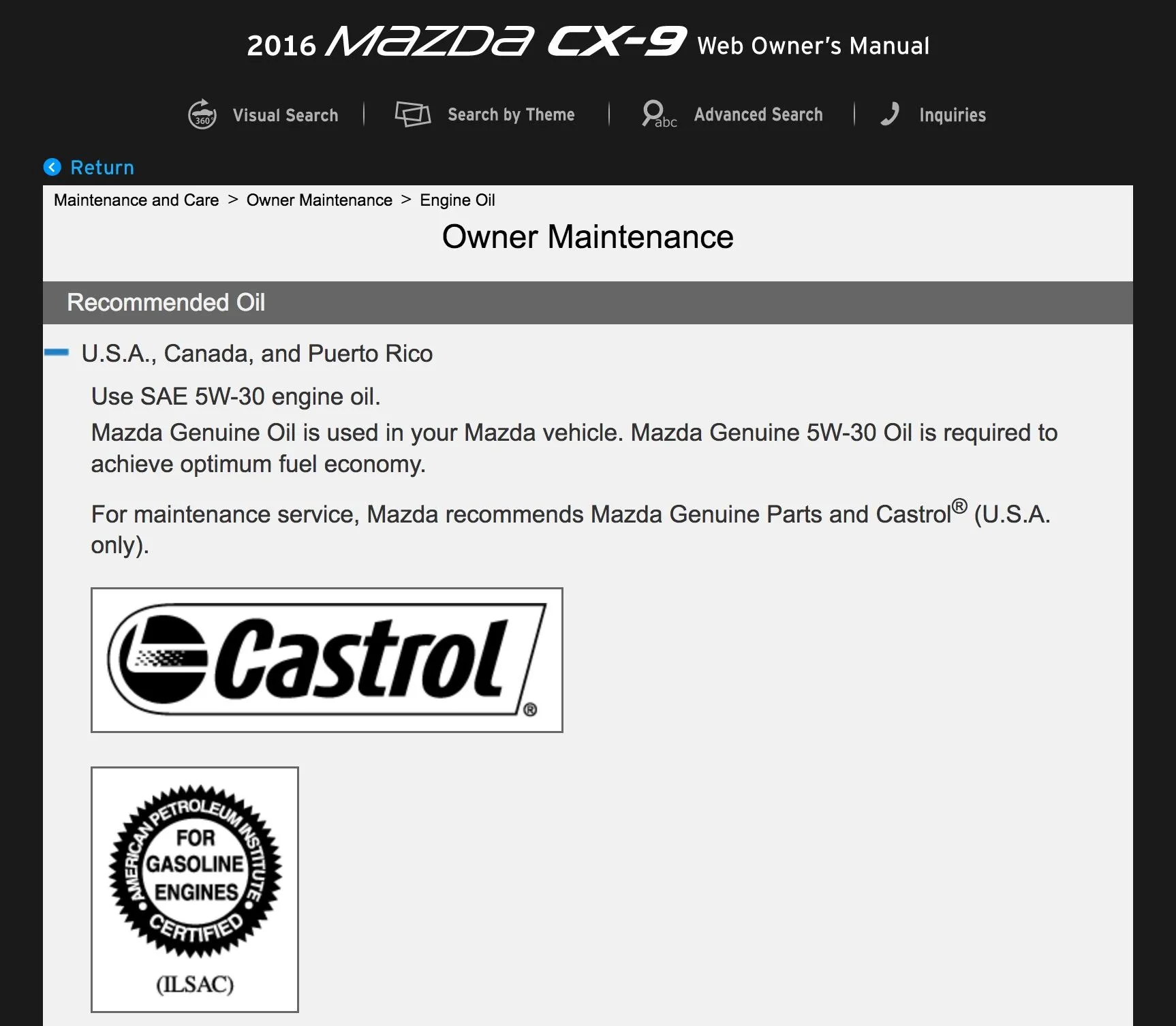

Always follow user manual from your manufacturer to be on the "safe side". No matter what the dealers says, if you stick to the user manual (regarding scheduled maintenance) and Oil type you are protected. Dealer will want you to impose a "tighter" maintenance visit, but not necessary.It's all $$$$ oriented. I have attached a link. And by the way... It mentions "recommended" and NOT mandatory...(picture below)....(important detail!!!)
http://www.mazda.ca/en/digital-owners-manual/2016/cx-9/index01.html
