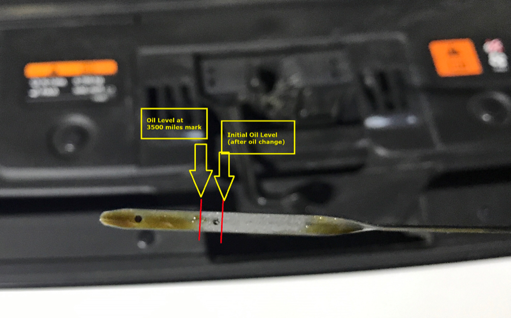

I reach 3500 miles since the oil changed. I slightly overfill when I did the change myself.
Oil used: Mobil 1, 5w-30 Full Synthetic
As can be seen from the below image the oil level goes down. During the oil change if the oil is not fill to the top mark, I ca easily see the Low Level light coming on by the end of the oil live
