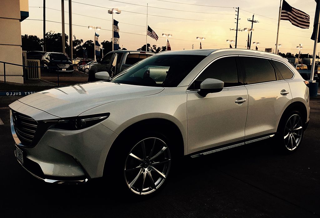

And this is my 2016 CX9 Signature with the 22x9 rims.
Looks really clean Pocketgroove. Fresh from the car lot before I took her home. Got the rims swapped right away with these 22s. Made her stand out from the rest.
Car looks amazing Striker, have you got some more daylight pics? Also what offset are they?
Any gaurd rub issues? i tow quite a bit so trying to find the flushest offset without having any gauard rub issues
Thanks Ekrace. I'm going to try to take more pictures and hopefully upload it here soon. These Ace Alloy Convex rims fit perfectly. They are 22x9s 35mm offset with tires 265/40 R22s. I was gonna get 22x10.5 for the rears but it's not practical and I can't do tire rotations.. Got no rubbing issues at all.

Wow, those 22" are tight!!!! Where did you get those Mazda center caps ? And how are they secured to the aftermarket wheels? What did you do with the OEM wheels that came with the car?
Thanks. Still got the OEM wheels in my storage. Like to keep it just in case. As for the center caps, I had to have that custom made since these wheels got a larger 75mm center caps than the OEMs. I think the OEMs comes in 54mm.
Stryker, those wheels and tires look awesome, I would love to do the same. What's your opinion on the larger wheel effect on ride comfort, did you notice better handling while feeling a more bumpy ride and or greater road noise? Thanks!

Hard to say a difference on ride since I put this rims right away when I purchase my car. But during my test drive and now, I can hardly noticed any difference. The road noise depends on what tires you'll be getting for your future 22s. I got the Toyo Proxes ST II which is an awesome set of tires for ride comfort and noise. The downside that you have to keep in mind though is the gas consumption. You will spending a little bit more than with the 20s but I didn't notice it at all.
