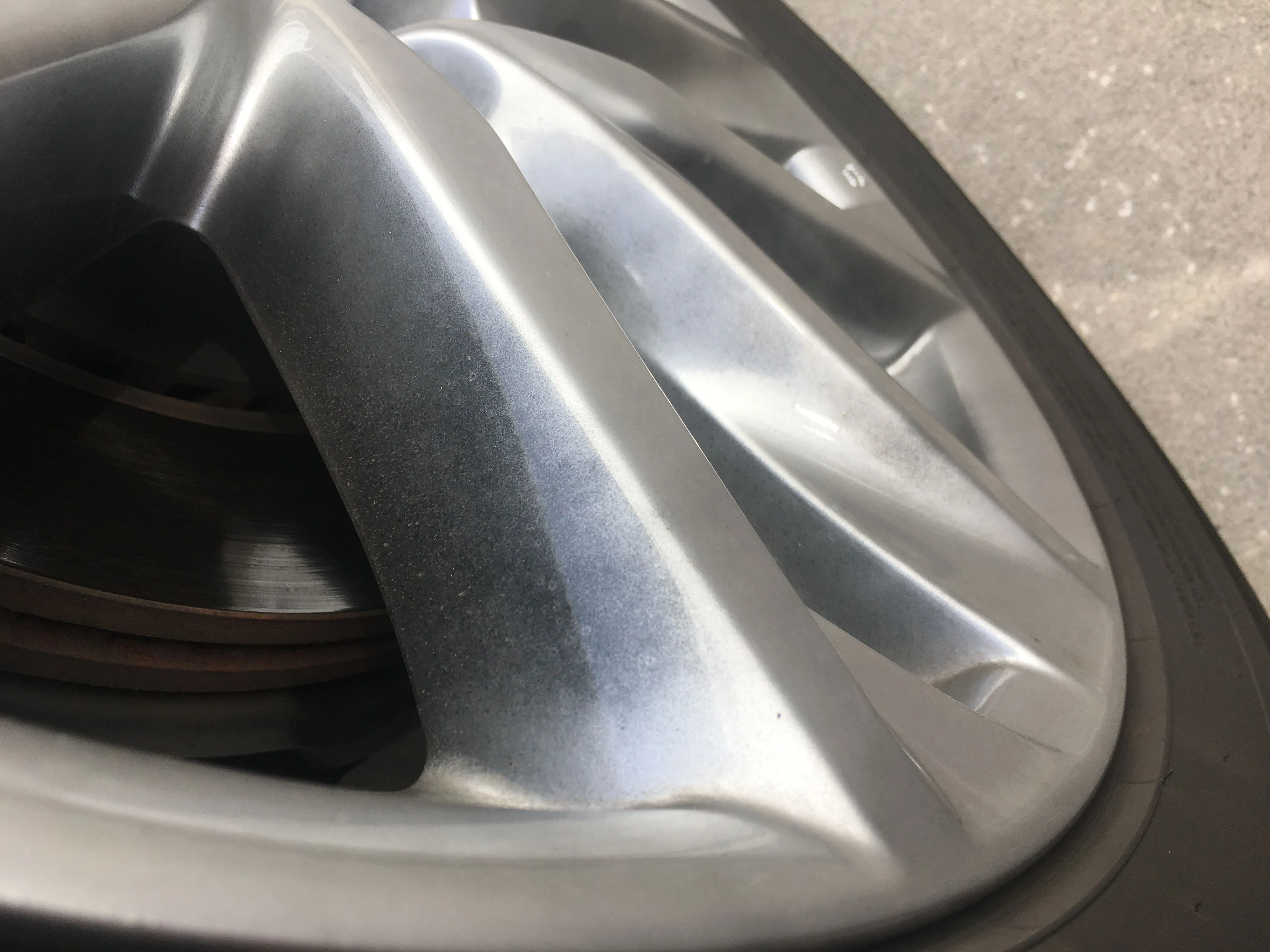

About a few months back, I noticed that my CX-9 20 inch rims were losing the grey finish from them. It wasn't peeling but just a lot of black was showing up. The clearcoat on the rims was still intact. After speaking with my dealership they asked that I open a case with Mazda, which I did. Mazda then called the dealership and it happen to be that the Mazda rep was going to be in town today. I met up with them at the dealership and he looked them over and asked if I washed the rims with anything other than soap and water. I told him no, because I really on use soap and water.
He said there was a TSB they have that shows certain chemicals can cause this. He said because he see's how well I take care of my car it could be something that was either added to the rims at the port or at some point. They will now be replacing all 4 rims instead of refinishing them because he is worried it may seep through the finish if we just have them redone.
Gotta admit this was pretty great of them stepping up and doing this. Here are some pics of the rims.

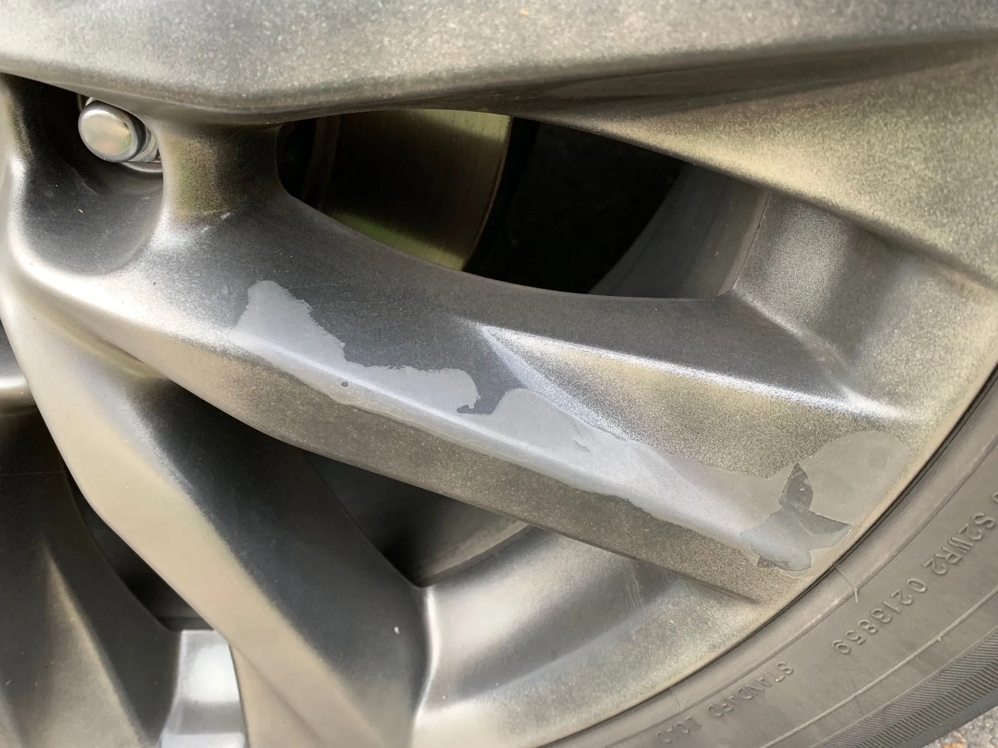

Mine have been doing the same thing over the last year, getting darker and darker. It didn't really bother me, (in fact it looks kind of cool!) except that now they are starting to peel as well. 2016 year model. I just went to the dealer today and they are contacting Mazda so we'll see.
Dealer will replace all 4 wheels next week under warranty, no questions asked. They obviously know this is a common problem. Anyway, glad they are doing the right thing. Hopefully other owners get this taken care of as well before warranty is up.

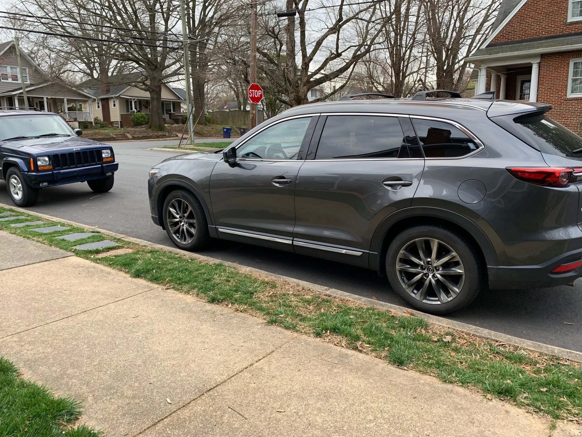

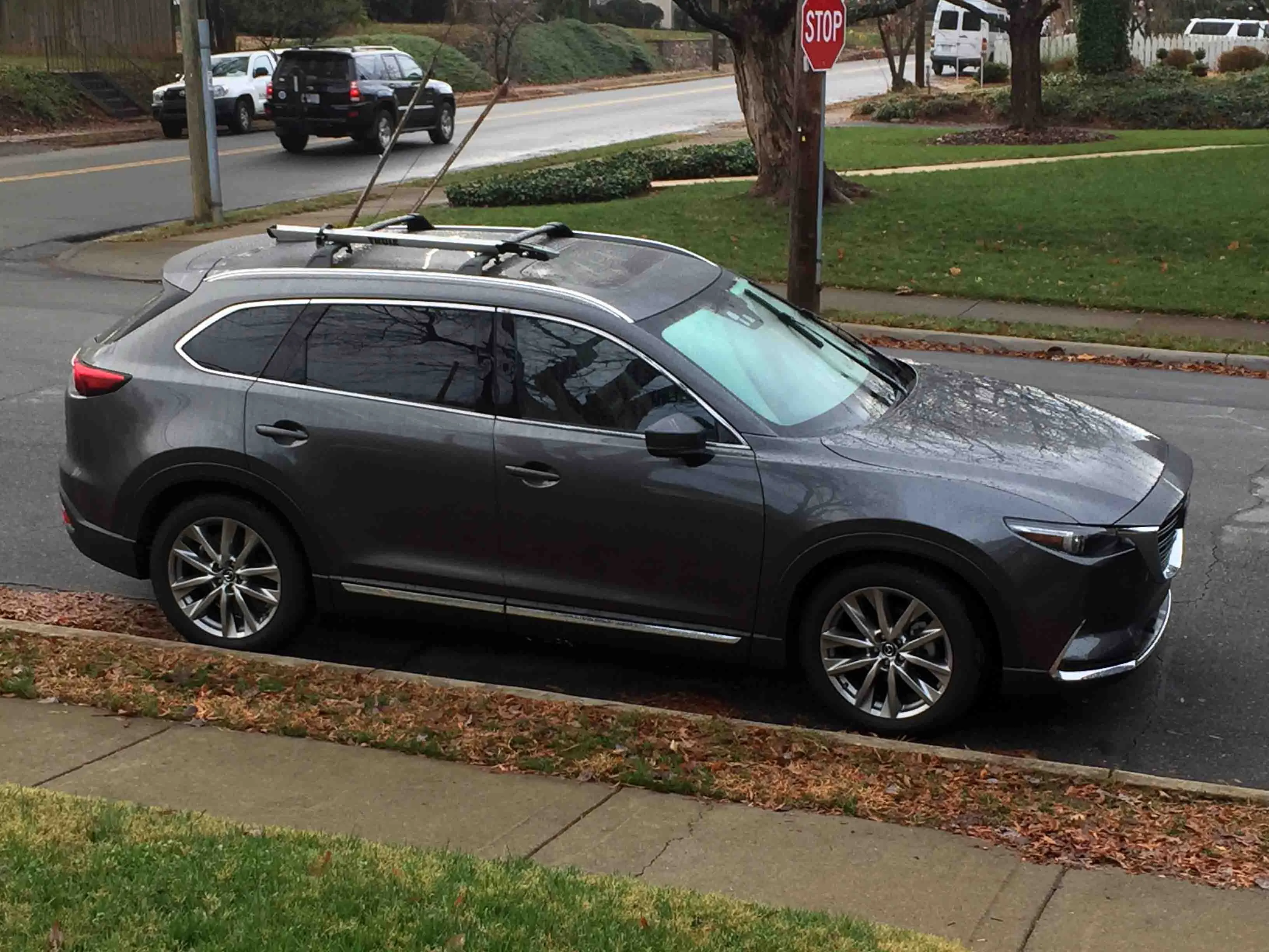

Wheels when brand new:
Wheels today (notice how bright the wheels on my 20 year old Jeep are by comparison...):

I've got about 32,000 mi. on it. First noticed the issue about a year ago, though, but didn't think much of it until I saw it had started peeling off in several places!

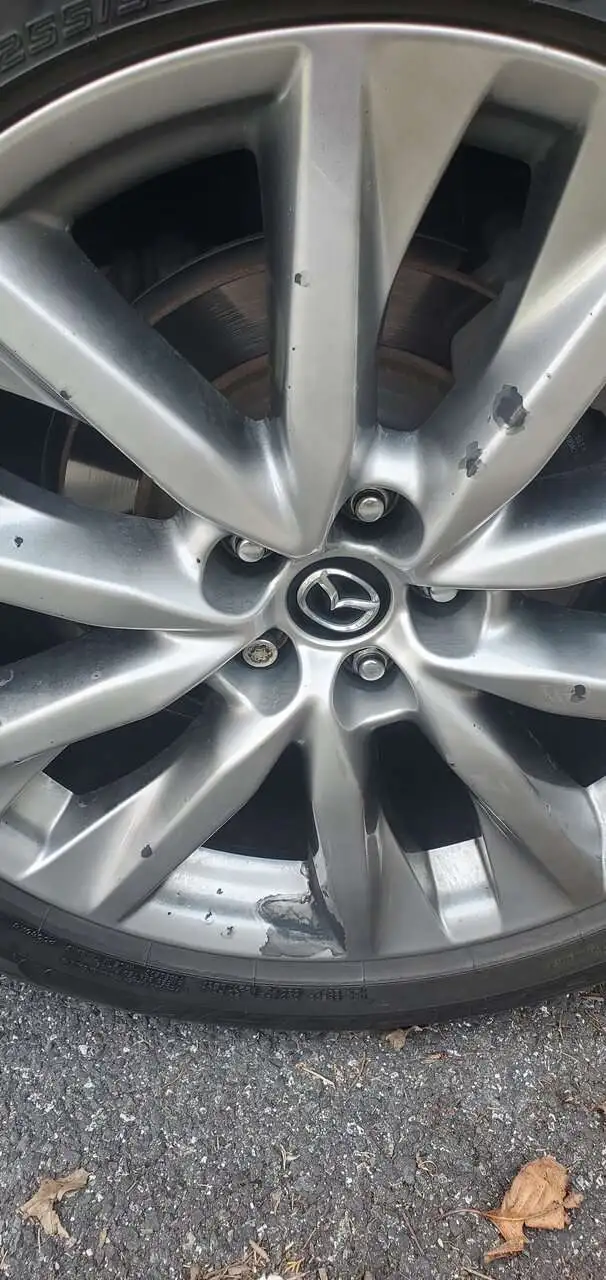

Hi, my 2016 cx9 touring has a similar issue. Can you let me know how you got it resolved from Mazda?

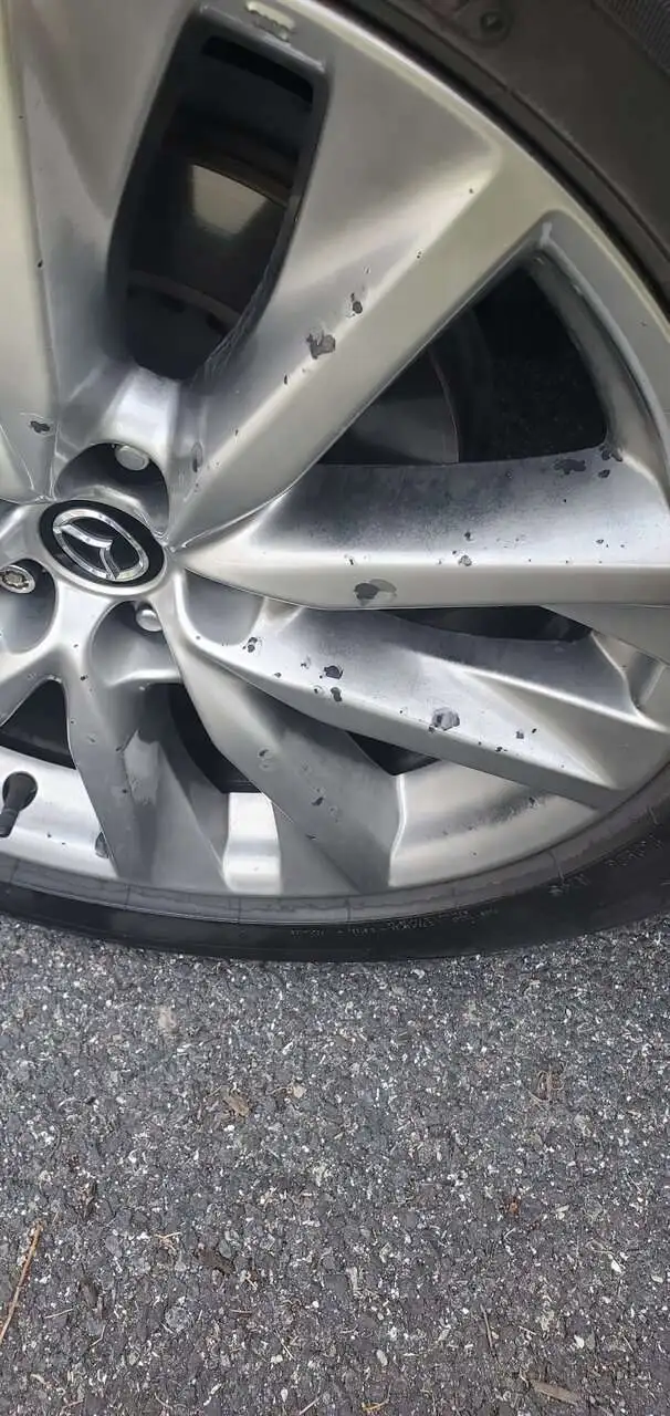

I went to the dealership but at that time it was still under warranty, but just so you all know. The replacements I was given have now started to show the same issue.
My wheels are losing the clear coat and are partially dark. They look like crap. Also a 2016 - the top of the rear door is also bubbling a little.
