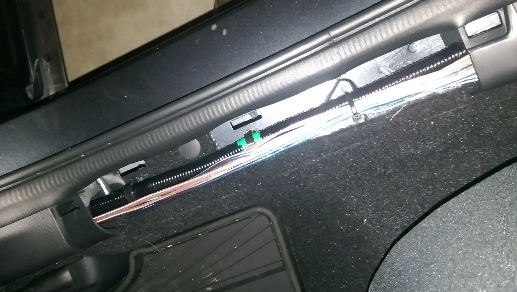

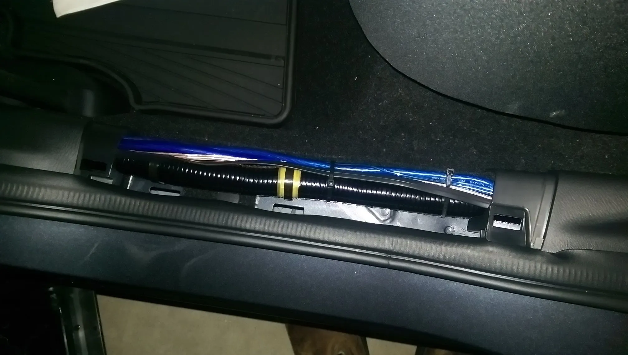

Next 4 pictures are some wiring just to show, I had the car stripped completely down. ( side note, not a fan of fuse boxes, granted they will not and cant possibly move.... still not pretty in my book -.- )

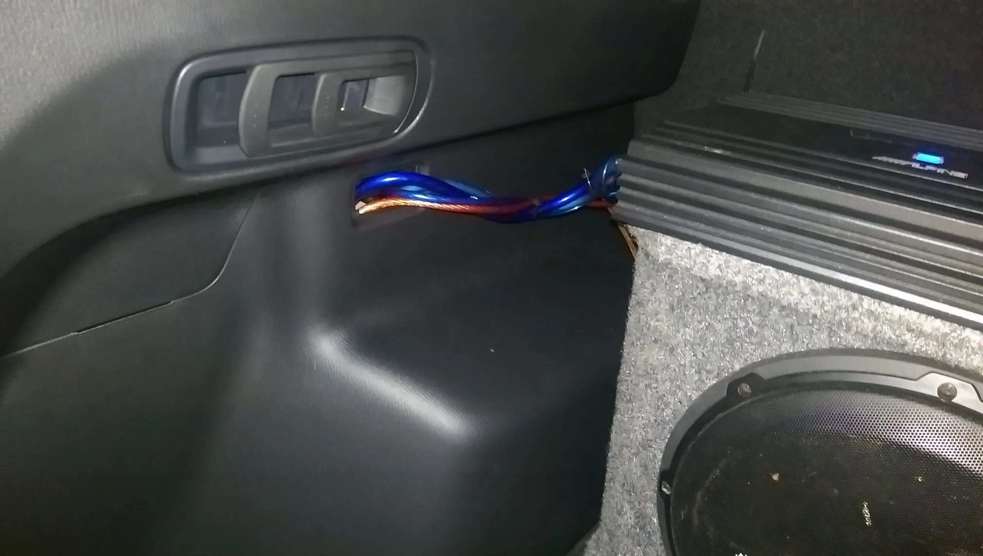

Power/Grounds from side plate (Eventually a fiberglass box will take up the left side so simple and easy and even more hidden wires.Power Wire Side.webp
(Heres the side ill be making the enclosure take up )

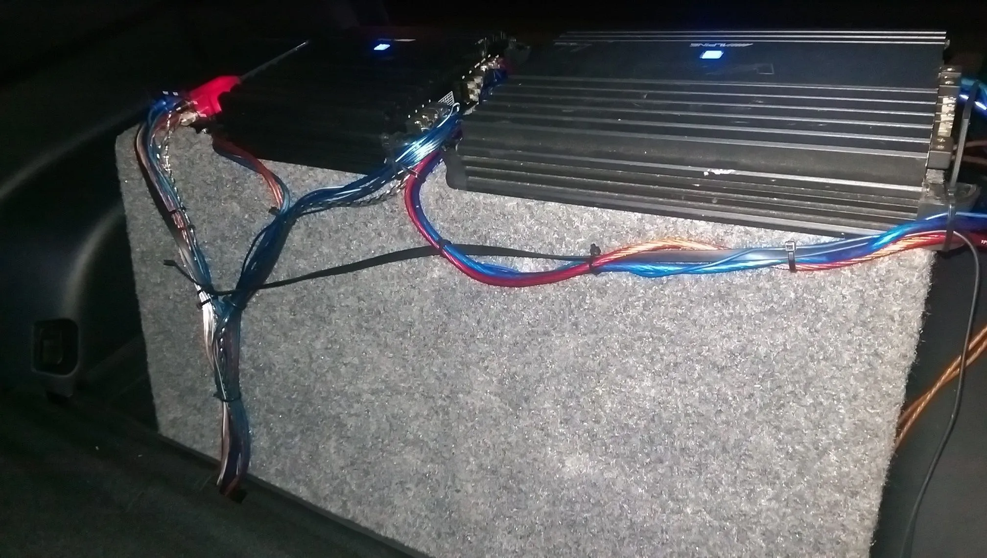

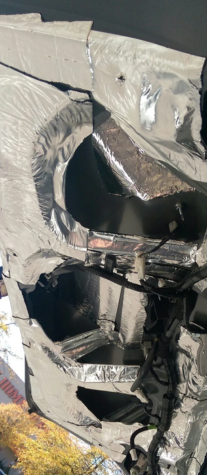

Well I did a poor man's dynamat today! I'll upload the pics Sunday night most likely got army coming up then a drive to Louisville area.

Poor man's dynamat. During process added more. But 1 roll did rear hatch with spare or extra thick. I also RECOMMEND putting it on the edges of the plastic trim, and undo the Velcro "pads" Mazda put and put a piece of useal underneath and restick the Velcro backing pad back on. the plastic will bang and rattle if you don't.

Update: installed all speakers and threw the leftover poormans dynamat in front doors.
