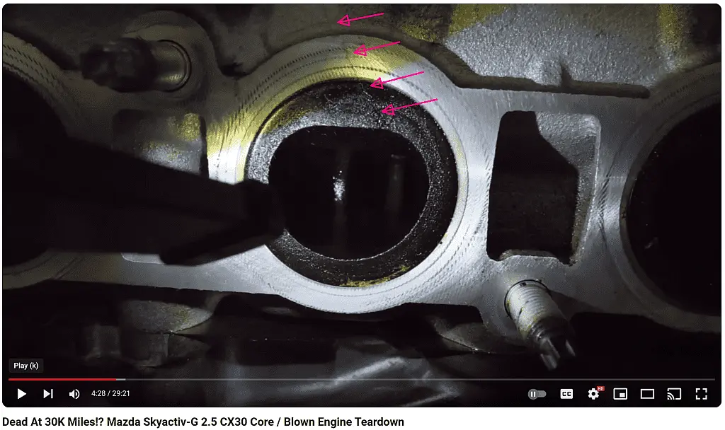

That makes me think of a YouTube channel I saw where a guy tears down all kinds of engines that have failed to see why. He did a Mazda engine and was commenting on it was the first he had ever seen. I'll have to see if I can find it again and post.

Looking at that video his conclusion was that coolant mixed with the oil, but he couldn't tell why. But if you look at the portion at 4'28" where he's looking in the exhaust ports, there seems to be a very obvious head crack. Is this the same notorious "CD crack" that many have complained of?
