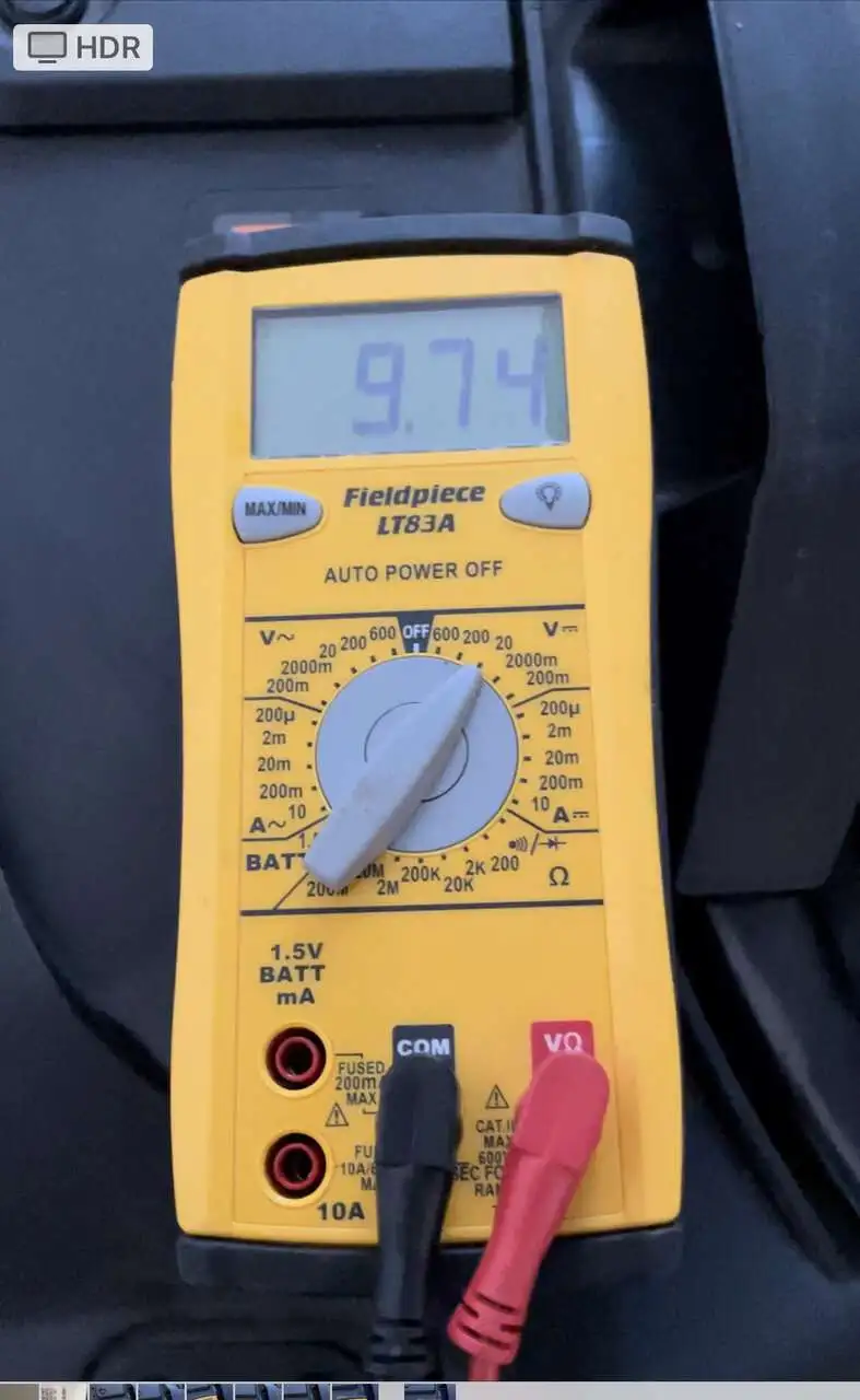

I did notice it would go to I’ve 10 volts when the inside dome lights went off. I may have a parasitic draw. I’m not sure if I’m capable of locating it.

How are you measuring the battery voltage?

I think the question is more about where you are measuring the voltage, is it directly on the battery terminals or somewhere else?
