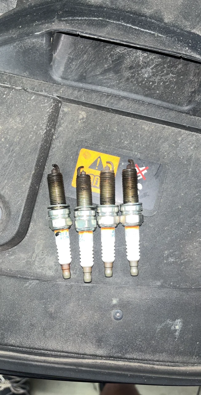

This is what they had recommended during their inspection:
-Throttle body service
-EFI Service (Fuel Injection Cleaning service)
-Spark Plugs, they had actually removed my spark plugs and show me a picture of them. (But I had those change at 75k with the NGK ones for Mazda, so they were just trying to rip me of.)
Declined all the recommended services. Not sure what it could be.

The dealer would lose me as a customer if they pulled my spark plugs during an oil change. No service shop should be doing that. In fact, I suspect the picture they showed you were probably not your plugs. I doubt they took them out at all.
If you still have the pic, take a closer look at the brand. They just saw the mileage and figured they could make a quick buck.

Yeah, perhaps they messed something up. During service they showed me a picture of the plugs, but I don't have it anymore. I am going to the dealer on Friday for them to have a look at it. I believe they even looked at the throttle body and said it was dirty, but the car was running perfectly fine prior to the oil change.

I actually found the email with the inspection results where you click on the link under spark plugs recommended and it shows the picture (attached). I doubt those plugs are mine. I had them changed out at 75k with the NGKs for Mazda.
No way are those the plugs you changed at 75k. I changed my plugs in the 2018, which were Mazda Branded, at 116,000km (close to 75k) and they were in better shape than those. Could have screwed up the coil packs or loosened a wire somewhere though you would expect a code.
