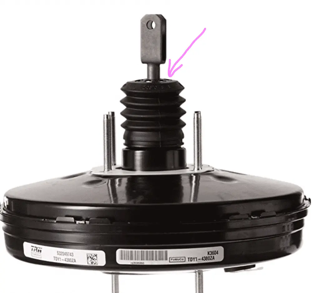

AVSJay, if lubing the pedal assembly hinges doesn't do the trick, I'd move a bit more downstream and lubricate where the brake piston slides on the rubber(?) dust boot seal in the firewall.

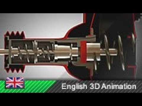

See the first post here:
I wouldn't use WD-40 like this guy though. I'd use a silicone lubricant because of the RUBBER boot seal.
