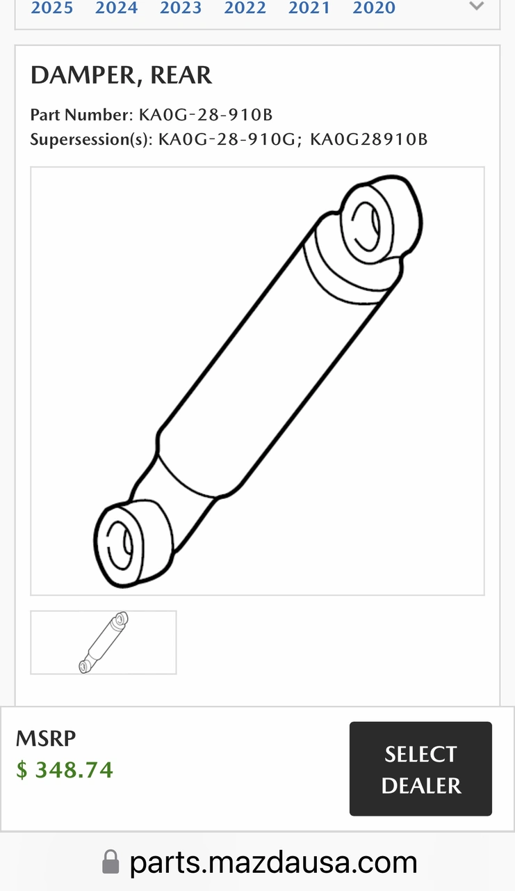

The website says Mazda 3 2018-14 and Mazda CX-5 2016-13 use the same rear shock mount? It even lists equivalent Mazda’s OEM part number which is impossible as Mazda doesn’t sell this part separately for gen-1 CX-5. Pull the Mazda part number KA0G28910B listed for rear shock mount at the website and you’ll get this:
Many had tried to get aftermarket rear shock mount at no avail even if there’s a part number listed. Some had tried to use OEM rear shock mount from CX-3 and the mount is very close to the one used on the gen-1 CX-5, see post #18 previously.

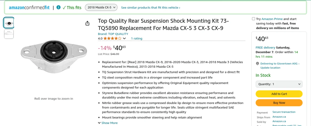

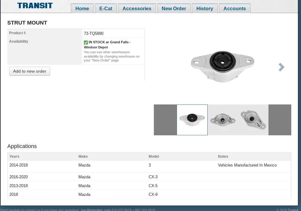

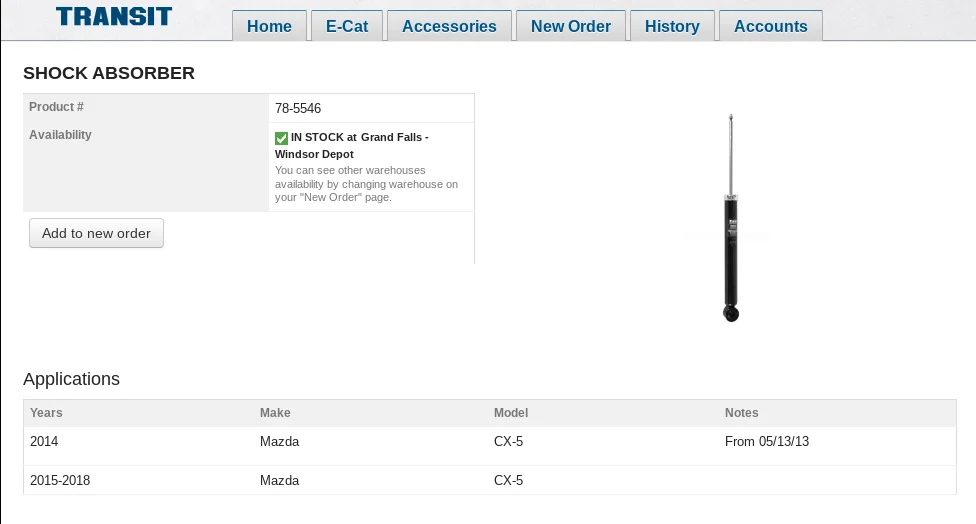

Came across this listing on a mount for the 2018 CX-5 and others. The brand is Top Quality sold by Transit a Canadian Outfit from Quebec. I sold their products for years and they have a very low failure rte on their products.

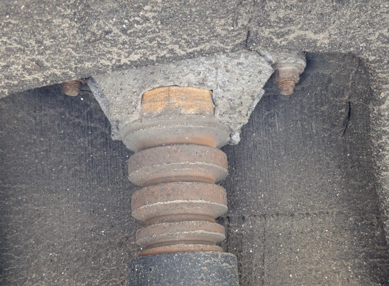

Wanted to offer some recent data points here.
I've got one shattered, and one cracked mount on my 2015 CX-5 w/ 117K mi on. Eleven winters of banging pot holes has caught up with me.
A local Mazda dealer quoted me $449 USD each (so $898 total) for shocks and mounts.
Given I'm planning to keep this car well past 150K mi, doing new struts, mounts, links, etc while I'm in here, but with a local shop.
I'm tempted for the cast iron aftermarket part, but I can get 2x OE struts w/ cover and mount for $200 all in, vs $100 just for the cast iron mounts. Did everyone else's mounts last around 10 years like mine? Unclear to me that it's worth the added expense.
