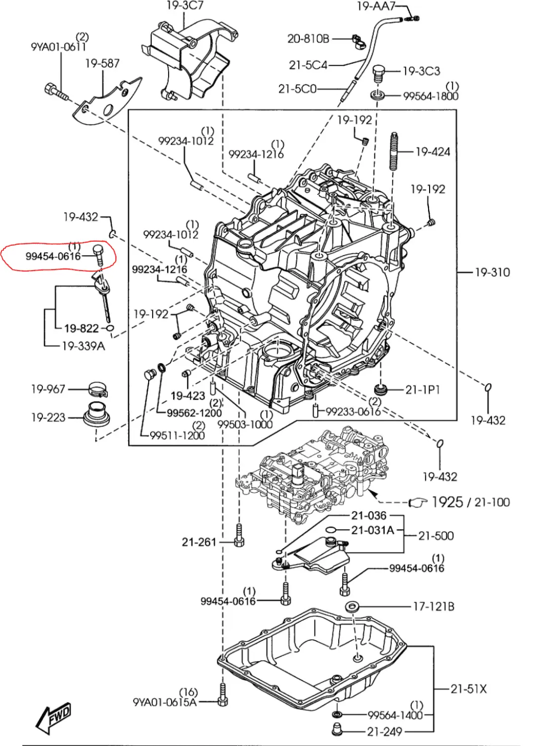

The ATF cooler adapter plate you saw has 2 ports. But don’t get confused with these 2 ports on ATF cooler. These 2 ports on adapter plate is the ATF outlet and inlet ports instead engine coolant ports found on ATF cooler. The ATF pump does feed ATF into the ATF cooler from inside of transmission to cool down the circulating fluid by engine coolant. The adapter plate provides ATF ports which are not available on ATF cooler to let fluid exchanger hooking up and exchanging the ATF. While doing that, you just let ATF cooler hang to the side by the engine coolant lines with transmission running.
Why do you want to extract old ATF through the dipstick hole? Drain the ATF through the drain hole to promote more tiny debris or dirt if any coming out with old fluid as those usually will stay at the bottom of the pan. If you’re draining old ATF through dipstick hole, the sucking power usually only stays at one area near the pan, which is not as effective sucking most of debris or dirt out. This’s similar to engine oil change. Some like to extract used oil out through the dipstick channel, so that they don’t need to go under the car. But how are you going to know you actually got all the oil out as the suction tube may not land at the lowest point on the pan, but the drain plug is.
The alternative, to drain 1 quart at a time through the dipstick and pour in exactly 1 quart, drive the car and repeat, would be worse than a simple drain-and-fill. Because once you pour in a quart of fresh ATF after you extracted one, it’s mixed with the rest of old ATF immediately in the pan, then your next quart extracted will contain some fresh ATF after you drive around several miles, which is definitely a waste on time and money. Not to mention it’s too much hassle. Do normal drain-and-fill, you for sure have about 3.75 quarts of old ATF drained, and the similar amount of fresh fluid been poured in.
I was thinking that if you insert the tube into the dipstick hole, it would reach into other areas that contain the rest of the fluid (aside from the torque converter) and would help in the process of extracting the fluid, aside from dropping the pan. But one good thing about going through the dipstick hole would be to extracting the fluid for an analysis since it would be less messy but that's about it.
