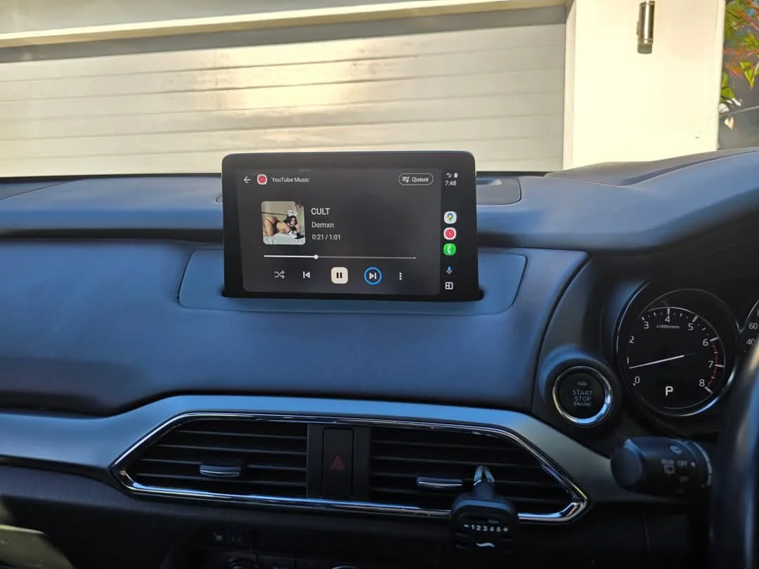

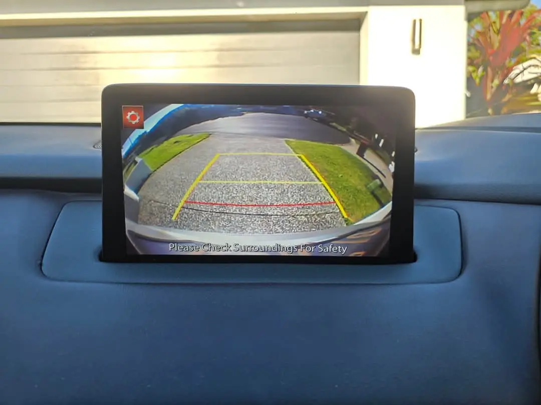

You can install the 9.0 screen and it will work perfectly. I replaced my 8" screen with the 9" and love it. No mods required.
No idea what yourI is on about as the 9 inch screen definitely isn't square...
I have a 2018 CX9 Azami (Australian model).

Squarer i guess. It seems like the base is the same width and the extra screen space is on the top.
But if you like it, definitely go for it.

Did you just pop out the 8.0 inch screen and then insert the 9.0 inch screen?
Yes. Just a side note, the plastic base of the 8" screen won't fit the 9" screen without some minor modification. Since the 9" screen I bought came with the plastic base (which you'd expect as it's screwed on), I didn't have to do this.
I've also considered the 10.25" inch swap but you'd need the CMU as well to make it work. I nearly bought it to try it out but wasn't convinced it would work properly and 12.3" aftermarket screens that work with the stock Mazda system had just been released.
