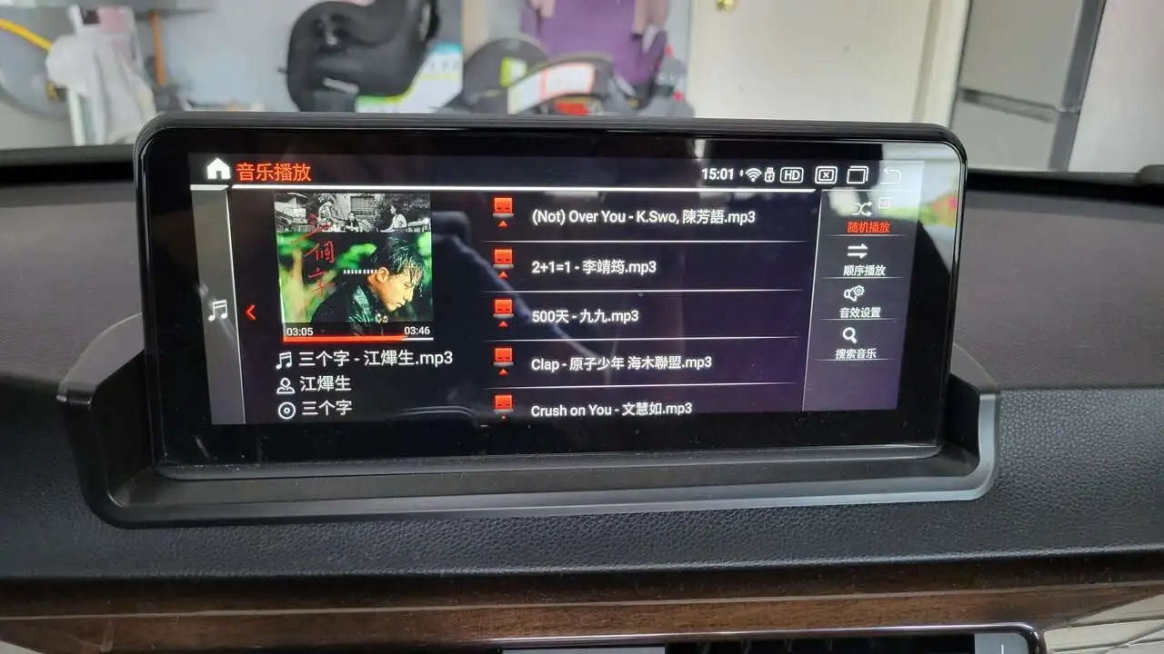

I am sorry that you had poor experience with those Android headunits. There are a lot of variances and configurations of them, and if you choose the bad ones, the experience could be poor. However, some of them are very good. I have been using a 10.25" Android headunit on my other car BMW E90 for 2 years. Beautiful big screen, fast processor (Snapdragon 625, mid-tier cell phone performance), supports Android Auto/Apple Carplay, and supports 1080p/720p AHD backup camera. I am very happy about it. Attached is a picture of my Android headunit.

The new one I am getting for my CX-5 is the newer uis7862 processor with 4GB RAM (plenty for headunits), even faster than my old one and 12.3" screen. There is a whole section on XDA that discusses about them if one wants to learn more:
